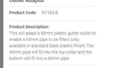

Thanks, had seen that one, but its outside diamenter is 68mm, seems its for the gulleys narrower outlet.
I need to put the new 68mm OD downpipe into an adapter that then fits inside the 63mm old pipe.

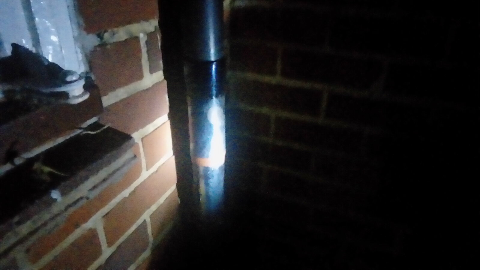

I did what you did - put a 68mm. piece over the 63mm pipe with some 68mm pipe sticking up to take a 68mm fitting. I used weld solvent cement and when that had set, I ran some mastic on the inside and the outside to seal it. Silicone does eventually fail, but the solvent cement is used in sink waste fittings and is permanent. See my post and pictures on this forum.
