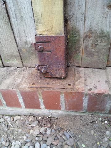

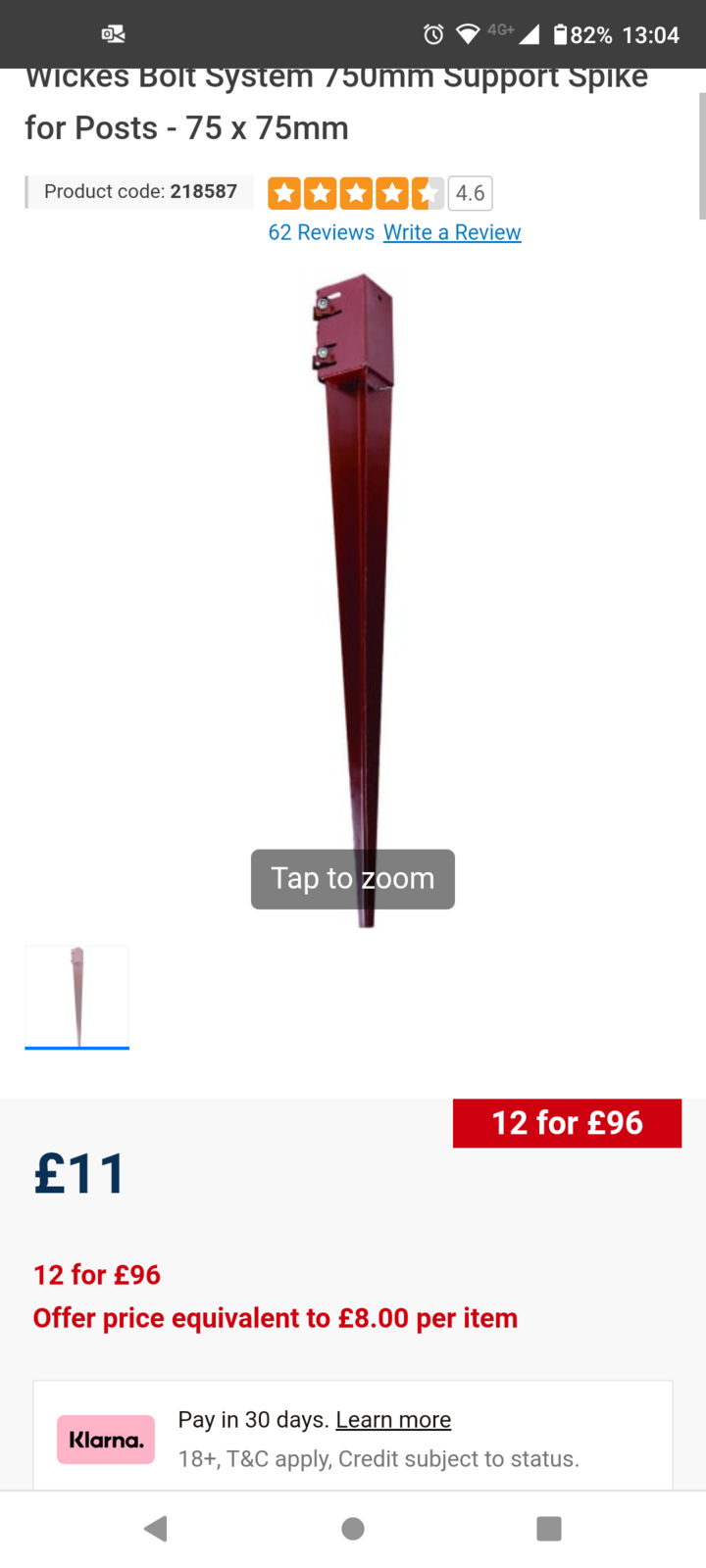

maybe some met post corner repair spikes
they have gone up a lot in price at toolstation
But you may find a local fencing company do them cheaper , i did find some cheaper at my local timeber/fence specialist, i think they sold in pairs for about this price
Jewsons also had them cheaper pre-covid though, but do not have the bolts, which i quite liked and have used in past .....
Wikes and screwfix also do them , you just need to shop around for price
also as you need 14 I would see what sort of deal you can get - maybe somewhere like travis perkins , who my do a deal on quantity , i have in the past
Don't know how much you want to spend, sounds like about 50p! Better to splash out on some of these and some treated posts.
I have always used repair spikes and generally they last around 25 years before falling over as DiyNut says. However if you use the galvanized types which are slightly more expensive, they don't rust and will be there for ever.
