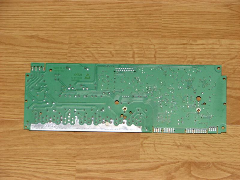

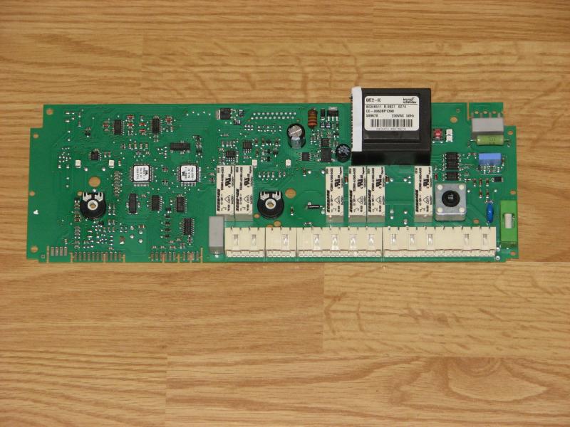

I've took the PCB out and had a good look (and sniff) of it. Nothing obvious seems to be wrong with it, I can't see anything burnt out or any dry joints or any broken tracks. It's dual layered board with lots of surface mounted components on it. I've even had a very close look at it with a set of eye loops, I can't see anything broken or burnt with those either.
Here is a picture of both sides of it.
The cheapest brand new one I've found costs £122+VAT. But I've found a couple of companies on the internet offering a PCB exchange service for about £75. So I will probably try one of those.

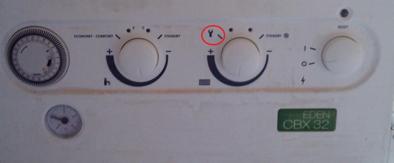

I have however, managed to fix the central heating problem. If I put the boiler into “service function" mode by turning the radiator temperature knob to the spanner position.

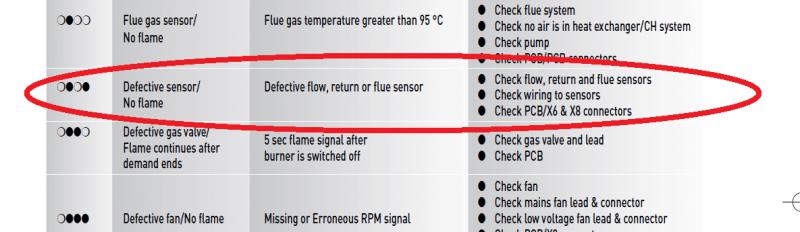

After a couple of minutes the LEDS would flash this sequence.
So I removed the flow and return temperature sensors and the flue sensor. And I tested them all using my multimeter. The flow and return sensors were both fine, but I noticed that the flue sensor sometimes measured infinite resistance. So I bought a new one and the central heating is now working perfectly.

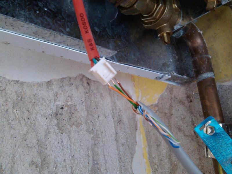

To get the readings, I used 3 strands of solid core cat 5 network cable. It fitted nicely into the holes on the turbine plug. Here is a picture.
I tried taking reading between the boilers case and each wire but all I got was a few fluctuating minivolts (noise?). I guess it's because the case of the boiler is connected to mains earth and not the ground rail of the PCB?
