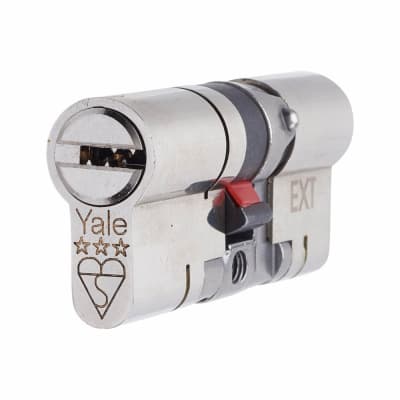

Andrew, as God said, with euro locks with key hole on both ends their is no inside or outside. They are designed to be used either orientation in door without issue.
So a 40/50mm is exactly the same lock as a 50/40mm lock.

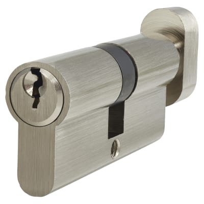

unless the inside has a thumbturn.
or the outside has a snap cut.
latter thinking is to have thumbturns on the inside in case of fire.
if you can't get one that's a perfect fit, get one that is within the handle or escutcheion on the outside. If it sticks out, it is easier to break.
