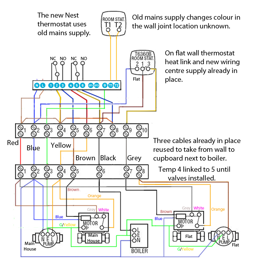

I had to wire up my own central heating, and I did a circuit diagram C_Plan_My_HouseD.jpg so when I had a problem, I could get it out and remind myself how it was wired. The diagram is not quite correct, but there are two ways to fault find, one take a stab at likely faults, and if that does not work, then follow the circuit in a methodical manner.
Stage one is likely work out how wired, as soon as someone says "under floor heating" I think oh no, that's a job for a heating and ventilation engineer, no longer is it a simple C, S, W or Y plan.
