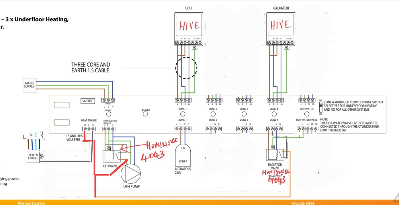

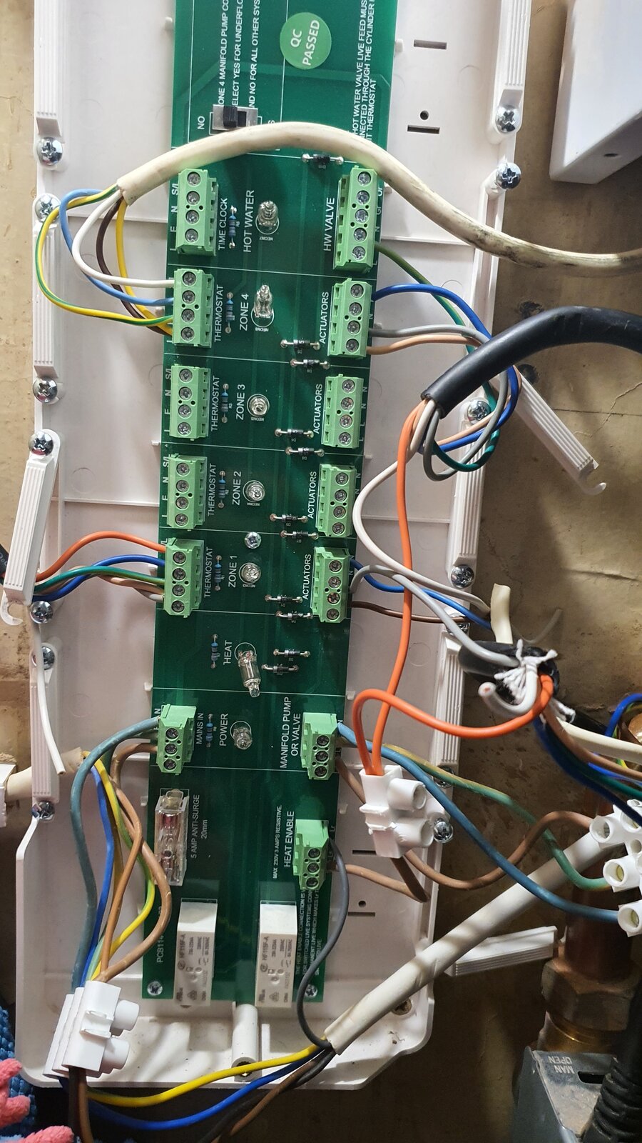

Hi, I am looking for advise on a zoneing issue on heating system.
I last year migrated to heatmiser uh4 wiring center, I believed I did the wiring correct and lived with it for a year. But this time being cautious about the utility bills I have been monitoring my usage. But I found an which went unnoticed in this one year.
I have 2 zones, one for all the radiators and one for the UFH. These 2 zones are isolated by 2 honewell 2 port motorised valves. I can turn on each zones individually and turn it off individually however the problem is that when both are on and you want to turn one off, it doesn't turn off. So I have to go ahead and turn both of them and then turn on the one that i want to stay on. Manually i could manage, but I am using hive and it is on schedule, so even if the schedule for one is set to be off, the thermostat says off, but the value is still open and water is still moving in that zone.
So I spent one full day re-thinking and tweaking the wiring but no joy. However, I have found what is causing this.
And it is something to do with wiring.
To explain the wiring. The thermostat wiring is no issue, it is the honeywell valve wiring that is an issue.
The boiler has 5 wires, brown n black going into line, green into earth, blue into neutral and then there is the grey that is connected to orange cables of the 2 morotised valves which in return go into the LS of the boiler trigger port on the heatmiser UH4.
The valve cables are place as such. Brown to line, blue neutral, grean earth and then grey to line as well. To reiterated bothe valves work, on and off individually but when both are on you cannot turn off one. I could feel it is because of 2 oranges connected the boiler trigger grey cable. So when the heating is turned on, the grey cable from the valve which connected to live triggers current to orange and then that triggers the boiler, but when the both valves (thermostats) are turned on and one is truned off the circuit doesnt break as the orange cable of the turned off valve carrys the current and pushes it back to the grey hence completing the circuit and keeping it on.
Hence looking for advise as to what can I do fix this and stop this reverse electricity.
Please advise.

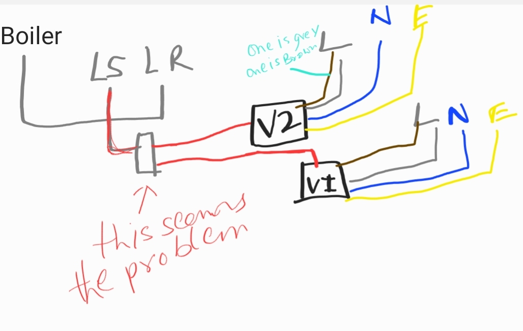

Hi, Thanks for your reply, but sorry I do not understand few bits here. When you say "Switched live goes from controller to thermostat" by controller do you mean the boiler enable cable? I thought, it goes to LR port on the heatmiser UH4. And also I have 2 thermostats, one for each valve.
"Permanent Live goes to the orange wires on the motorised valves" I understand, the orange wire gets live feed from the grey wire of teh valve when it turns on and then triggers the bolier. I have attached a diagram to highlight were I feel is the problem and the current reverseses there.

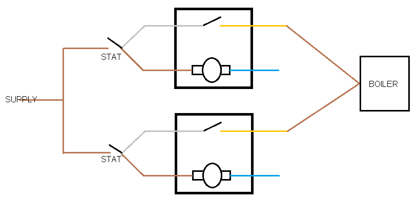

I am having trouble following the wiring descriptions.
See diagram:
N.B. the Greys are Permanent Live and are connected.
The Browns are not connected and operate their particular valve motor when live - calling for heat.
the Oranges are connected and switch on the boiler when either motor operates its valve switch.
Obviously the Blue Neutrals are connected as are the Green Earths.
See diagram:

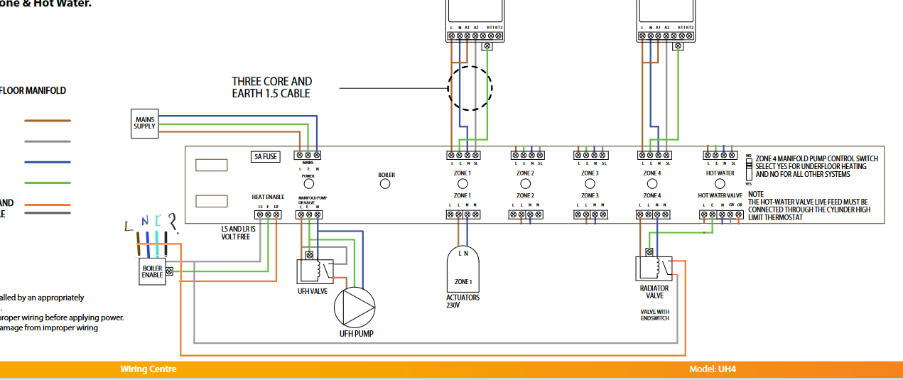

Thanks, this is making sense and I get a feeling this is exactly how i have it connected. But what do you mean by a controller? And the orange cable is connect to the boiler enabler at port 10, which is the LS port in the heatmiser UH4 wiring centre, how would the same above diagram look like in the heatmiser? I hav attached the heatmiser manual here for reference. My UHF is in zone one and the radiators are in zone 4. Attached photo of the wiring centre. the white cable at the bottom is the boiler cable.

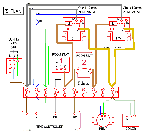

This is the common mistake which creates the problem
In fact it's often compounded by the supply coming from 2 different sources ie heating & hot water circuits from timeswitch.
If both valves are open and one output of the timeswitch is switched off, not only will its valve remain open but the neon will remain lit.

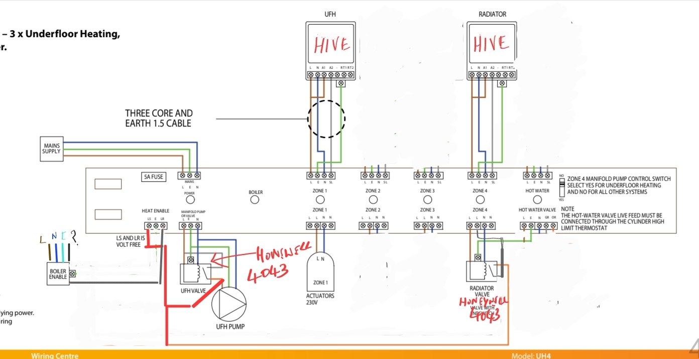

This is exactly how it is connected and all the devices. Note: the bolier has 5 cables, not sure what the black is for hence a question mark but it is connected to Line. But over all this is exactly how my wiring center looks like. Just to reiterate my feeling, the orange wire that enables the boiler is feeding back current if either of the valves are on hence doesn't turn off the other one.

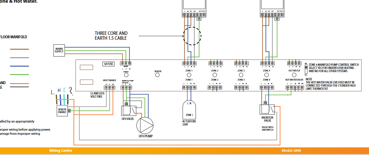

The instructions for your wiring centre tell you to use the motor switches to link LS and LR (Why I don't know but I'm not the one who spent £60 on a box and some terminal block). Instead, you've connected the grey wires to spare lives on the actuator outputs. Have you checked those lives to see if they are permanent Live or (more likely) just paralleled & thus behaving as the switched lives featured in my original post and in @SUNRAY s pretty diagrams.
and yes you have made that classic mistake, instructions are all there for you in the manual you supplied and modified, I wonder how you came up with your very different solution to make the UFH pump run and strain against a closed valve with just the rads calling for heat, was it advice from somewhere or poke and hope ? It is quite whacky but by no means the worst I've seen.
I wonder if the boiler black wire is the live supply for the enable or the pump supply, what does the boiler instruction say?
This is my version for a 2 pump system, good luck.
Thanks, but then going with your diagram, how would the ufh valve and pump enable the boiler?
As there is no instruction in the manual to do so I assume it's doesn't need doing. and one of the reasons you have purchased an expensive unit.
