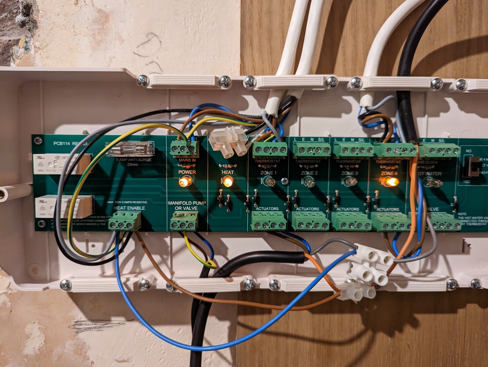

Hi,
We have a nest gen2 heatlink which only has 5 connectors N L 1(satisfied) 2(common) 3(Call). The boiler was connected to 2 and 3 but during some building works it was disconnected. We now have a Heatmiser UH4 and we are going to connect the heatlink to zone4 for radiator use.
The UH4 just has 4 terminals too, N,L,E and SL. Can anyone advise how to wire the two together? Obviously the L and N goto the relevant terminals, and i presume SL goes to the call for heat, but is there anything else? I found a diagram on here for the nest gen3 but that has a lot more terminals.
Paul
Do you have a wiring center for the boiler or is it a Combi boiler?
Hi it's a combi boiler and I've got the wiring all set up now and it seems to be working to a point.
When we had just a nest the boiler clock had to be set to always on but it only actually fired up when the nest heatlink called for heat.
Now the UH4 is installed the boiler is constantly firing if clock is left set to always on.
When one of the thermostats calls for heat, the relevant port valve opens, the lights come on the UH4 etc but the call for heat doesn't seem to be stopping the boiler when it goes off. It seems the clock/timer is overriding the boiler not the other way around.
One thing to note, the manual clock timer has to have all the pegs set to on so it's on timer mode as the switch between on, timer and off doesn't appear to work. Although I don't see the difference between timer always on and just always on. Hope that doesn't confuse things

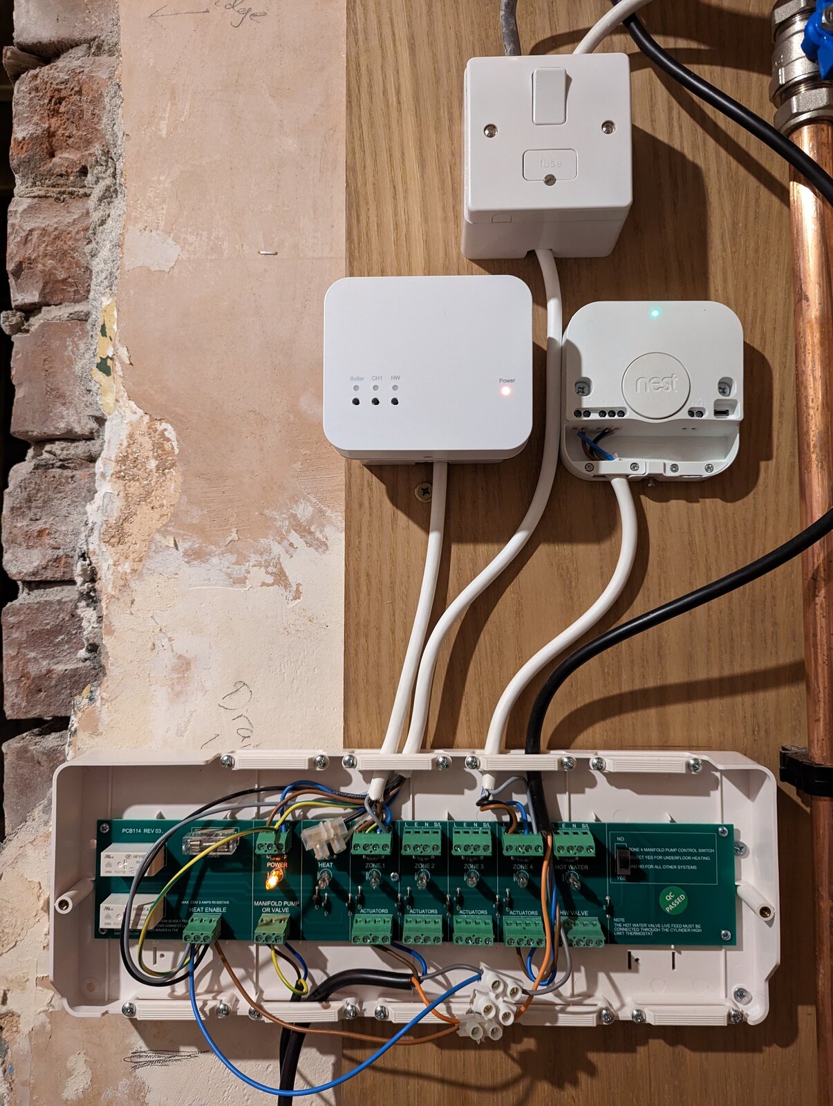

To clarify we have had a best Gen2 (UK) running fine till about 2yrs ago when we disconnected to start on some home improvements, it's only now we are starting to get back to normal!
So we jus had UFH installed. That will be controlled with a neoair and RF switch into port one. Port 4 I have connected the old nest.
Port 1 and 4 out goto two port valves.
Mains power is via 5 core cable so the two spare cores are being used for the call for heat to the boiler. But it doesn't seem to want to switch on when called. I'm wondering if the boiler timer/clock is affecting it.
Boiler is a WB greenstar 30cdi.
And here's a pic of the overall layout and UF4 wiring.
