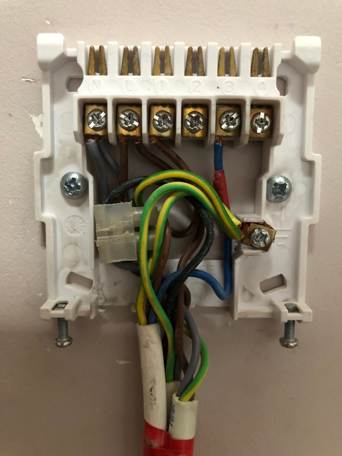

Replace Hive with Nest
Sorry, I was tired last night and wanted sleep.
old > new
Blue > N
Brown > L
Grey > 2
Black > 3
Green/yellow > earth
Depending on your wiring, it should be quite straightforward to alter it to allow the nest to control.
old > new
Blue > N
Brown > L
Grey > 2
Black > 3

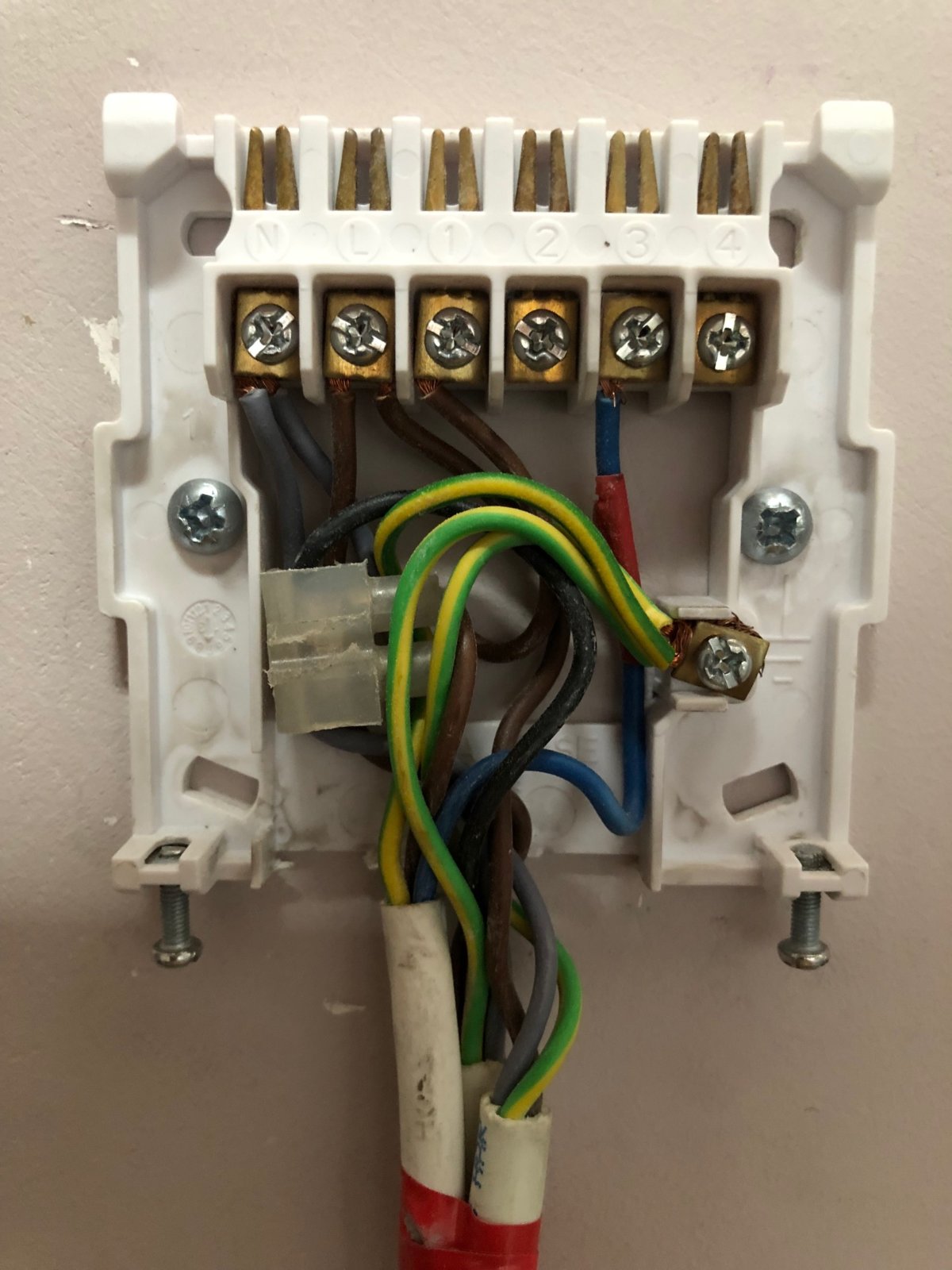

Hello, I think I have a similar wiring on my existing Hive. Can I follow your instruction and do the same on my new Nest wiring?
Hive - Nest
N (Both grey) - N
L (Brown/Black) - L
1 (brown) - 2
3 (blue) - 3
Earth - Earth
Many thanks for your help
Hi Feri and welcome to the forum.
Ideally you should have posed your own new thread. For future reference, tagging your question on to someone else's is known as Hi-jacking and is against the forum rules.
Anyway, I am pleased to inform you that assuming that you are replacing a single channel Hive with the Nest, you have figured it out correctly.
Wires in Hive N = Nest N
Wires in Hive L = Nest L
Wire in Hive 1 Common = Nest 2 Heating Common
Wire in Hive 3 Heating on = Nest 3 Heating call for heat

Yes it’s a single ch heating only. Perfect. I’ll do it like this then.
