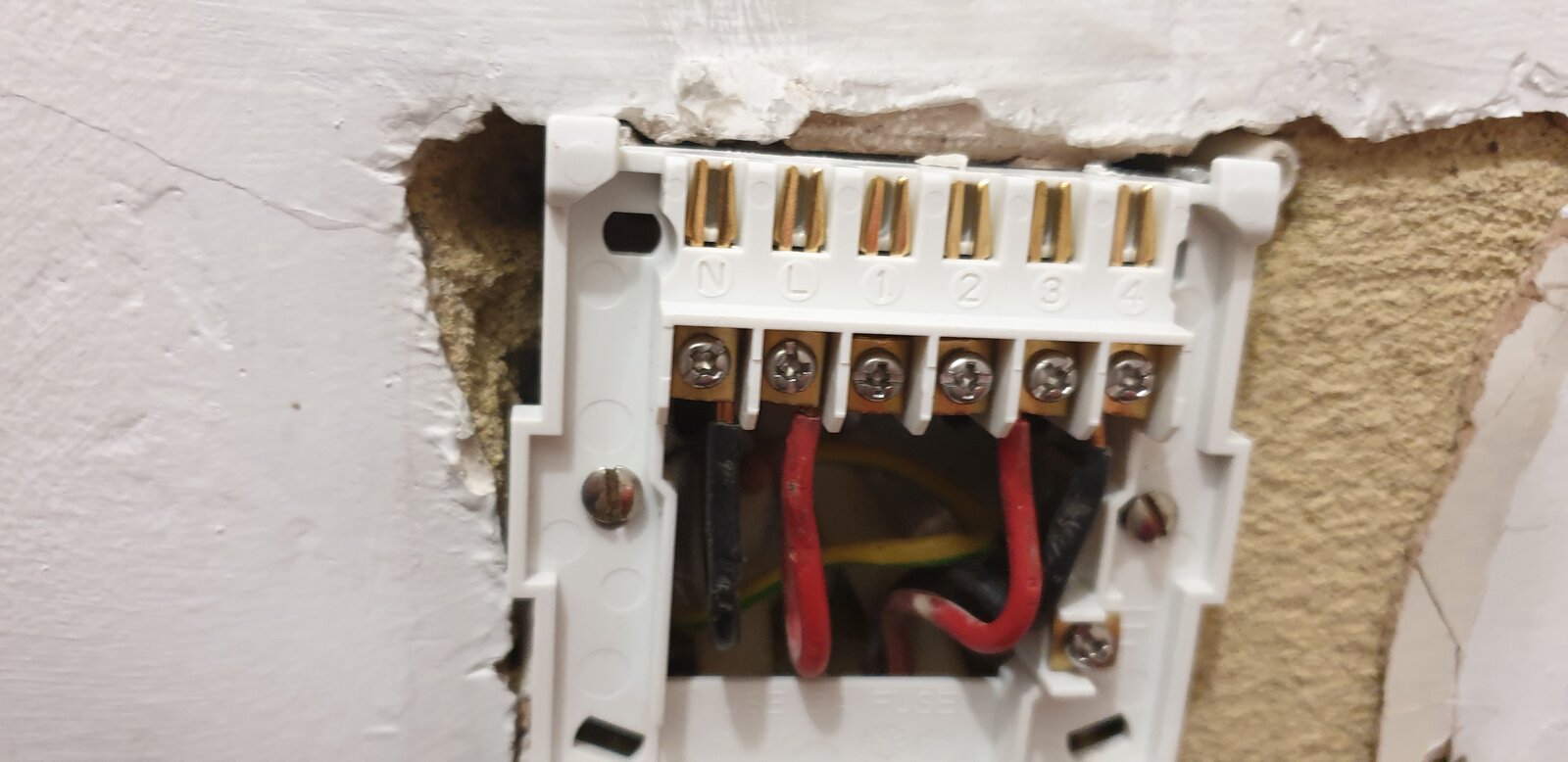

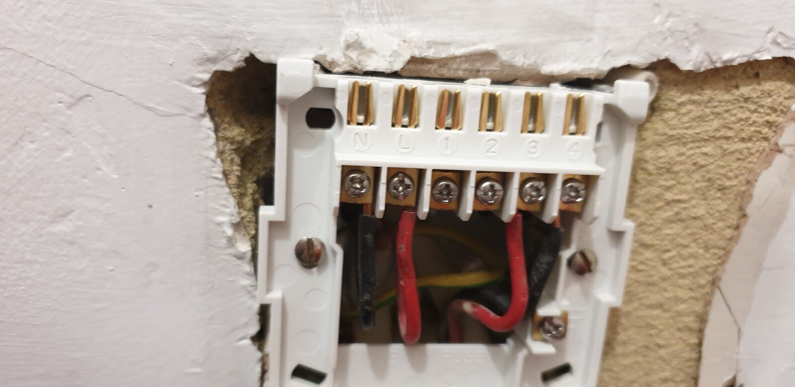

Hi, I've just moved to a new house and have a lot of Hive equipment that I want to use from my old house (TRVs mainly). The new house has Nest.
I was hoping it would be a simple job of swapping over the receiver and isolating the T1 and T2 power (as Hive thermostat is battery).
The Hive diagrams look simple enough for the water (on/off) and heating (on/off), however I don't understand the existing Nest wiring. Apart from L and N, only two wires come up from the wiring box and the other two appear bridged. How do I convert this onto the Hive terminals? I've attached a photo of the existing Nest wiring.
Thank you for your help.
Andrew
Firstly, do you have a Hive dual channel receiver? If so then you’ll just need to wire it up as you’ve suggested. I find not then you’ll need a dual channel. Basically the Nest needs live links for commons, Hive dual channel has these built in internally, so no need to convert these.

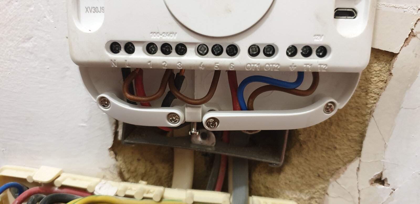

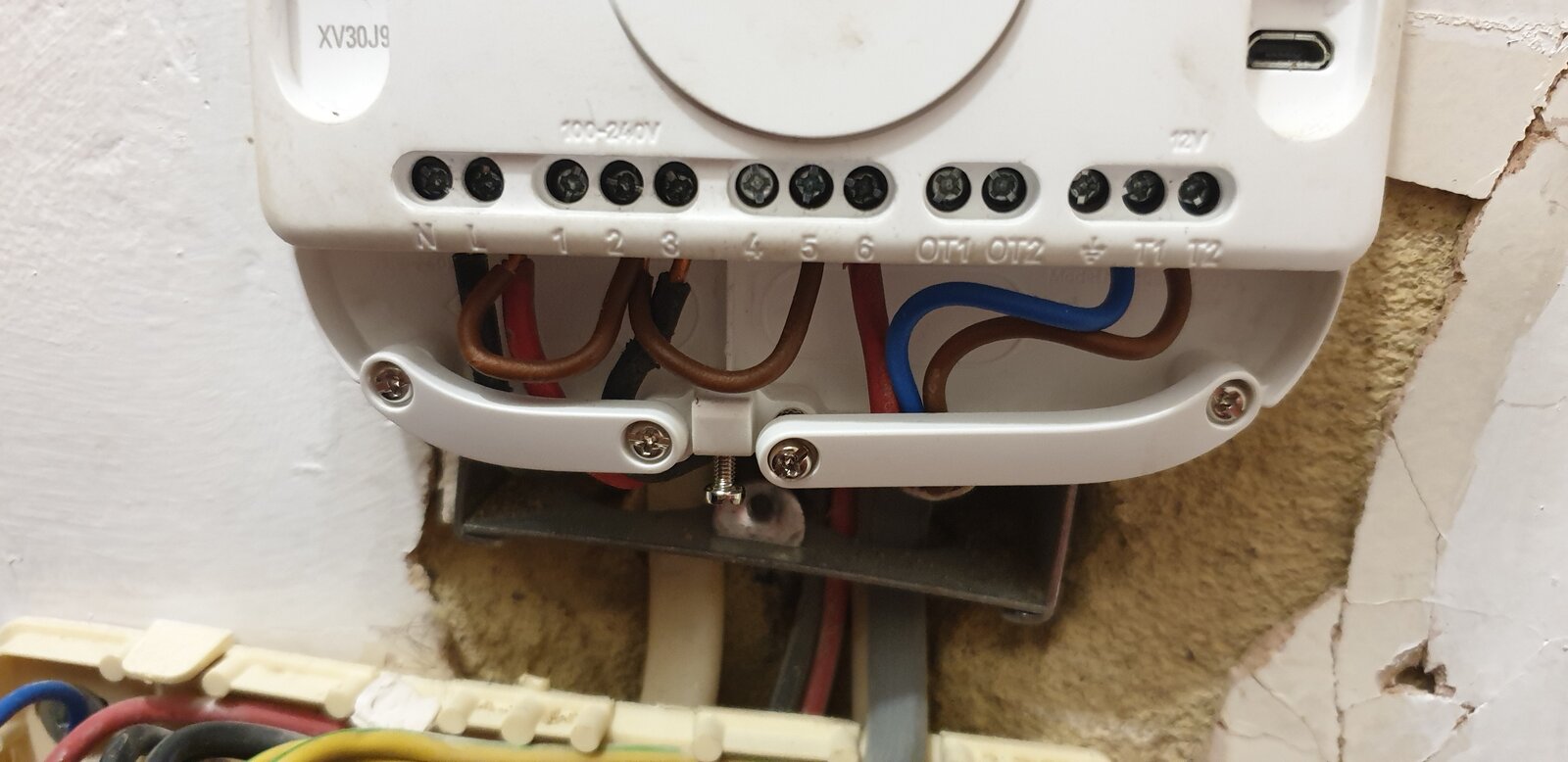

Thank you, yes I do have a dual channel hive (hot water and heating). Before getting your post I wired the Hive up like the Nest, so linked the live to commons (wire between 1 and 2, plus wire between 2 and Live). All seemed ok (!!) Except I could not pair the thermostat as it says "Too many hot water zones" on the app when I try to add the thermostat.
So then I took out those two bridging wires, leaving live to hot water on and neutral to heating on but I still get the same message. I have attached how it is wired now.
Are you able to advise what I need to do? Thabk you.
As an update, the hot water zone seem to work fine if I control from the receiver. So I press the hot water and we heat hot water and not the radiators.
But when I press the heating both the hot water and heating lights come on, which does not seem correct.
If I try to connect the thermostat to the app I get this too many hot water zone error message.
Cheers, Andrew

No you don’t, all links are internal, heating off isn’t used in your setup. Is the temp set high enough? Is there a control on the boiler that need setting to on/constant? Was/Is there another room thermostat?
The wires from your nest in 3&6 now go to 3&4 on the hive receiver, NO links everything is already linked in the hive

Ahh, you need to connect the T1 and T2 wires together, as these will have been wired to the wiring center.

The wiring is correct. It's just two on/off switches, one for heating and one for hot water.
The problems are software related, possibly because it still has the config from the previous property in it.
Heating and hot water on simultaneously suggests it's been set to gravity mode, which most properties don't have.

Thank you flameport. Yes it is in gravity mode (blue light), I thought I needed that as have a hot water tank?
