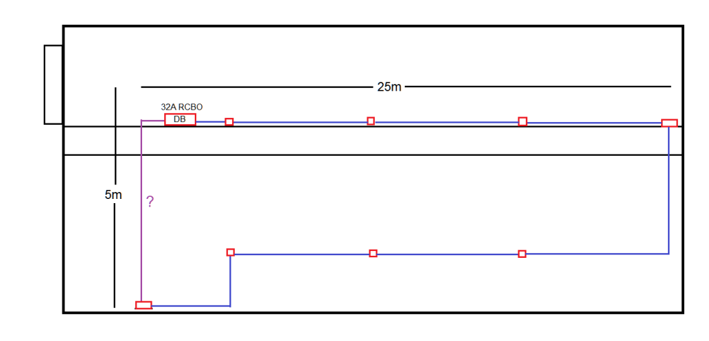

Could you help with the following diagram please?
Which would be best, a ring or radical circuit? I think ring due to the length.
Also, when trying to calculate the cable size online I come out at 10mm. Is that really correct? I'd have thought 2.5mm like normal circuits, but I suppose it is the distance needed cover?
Would the protection need to be a 32A MCB/RCBO?
There is 6 single gang, and 2 double gang sockets in total, wiring clipped to tray.
I am NOT going to be doing any practical work what so ever, this is just a query I have and would like to try to know the 'Why' of it.
A ring circuit can serve a floor area of 100m/sq. 25x5 = 125.
There is a guidance of a maximum length of cable of something like 75m (forget the exact recommendation). So your length looks OK.
I would be looking at two radial circuits my self. Probably 4mm 32amp radials (75m/sq each), or if lower demand, 2.5mm 20amp radials (50m/sq each).

Could you expand you query and confirm what the room is, what you intend to have on the circuit and clear up whether it's a domestic or commercial site?

Thanks for the replies. I'm not doing the work, it is just theory for my SNVQ.
The room would be a roof void of a factory building.
Where in the regs does it say about maximum floor area a ring can serve? I have never seen this, but would be good to have a read.
I would have thought one ring, with 2.5mm would be better than 2 radials in 4mm, do to cost and ease of working with 2.5mm over 4mm?
Would the protection still be 32A on a 2.5mm ring over the large distance?
It terms of 'the regs', per se, it doesn't say that. Appendix 15 (which is only 'informative') of BS 7671 merely says that the floor area being served should be taken into account when designing a ring final circuit, adding the statement "Historically, a limit of 100 m² has been adopted". If this hypothetical circuit is for a factory roofspace, do I take it that only occasional, probably single, loads are expected - if so, then I would imagine that you could 'take into account' the area being served and conclude that a single ring would be fine.
Without intending any offence, if you need to ask that question I think you probably would benefit from familiarising youself a bit better with some of the underlying principles. The rating of a CPD does not depend upon the length of the circuit.

You're presumably talking here about cable length, based on considerations of Zs and/or voltage drop. The question was (and answers were) about the floor surface area served by a final circuit. In the (hypothetical) case being cited, the total 2.5 mm² cable length would only be 60 metres or so, hence usually well within the limit of maximum cable length which you mention.

Floor area clearly always was a very poor guide to anything, particularly if one doesn't specify different maximum areas for different types/uses of rooms/spaces. Far more important, IMO, is consideration of what the power requirements of the area being served are likely to be - even though it can never be anything other than a (hopefully 'intelligent') guess.
