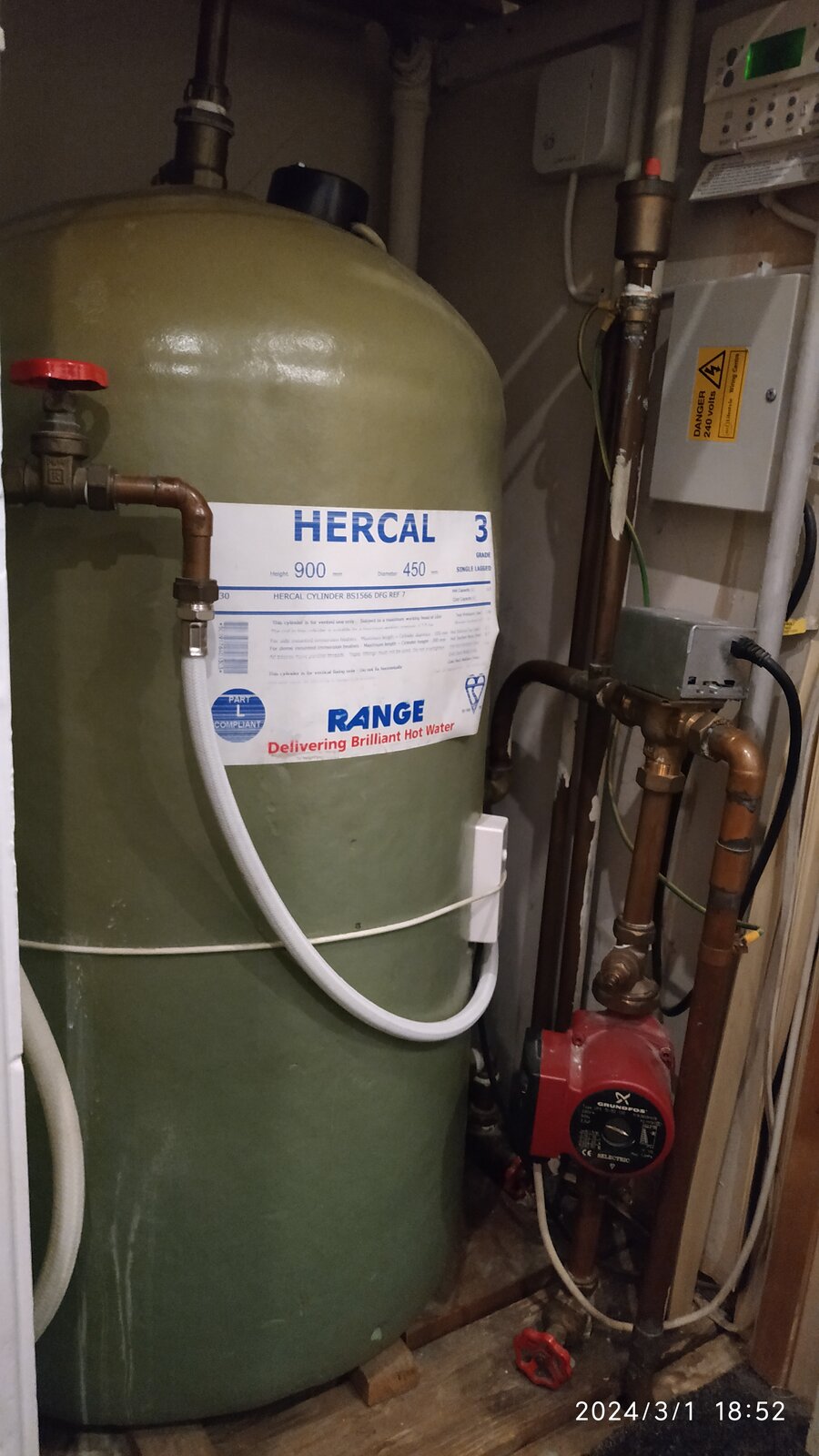

The feed may join into the system near the pump ,show us some pics of pipework

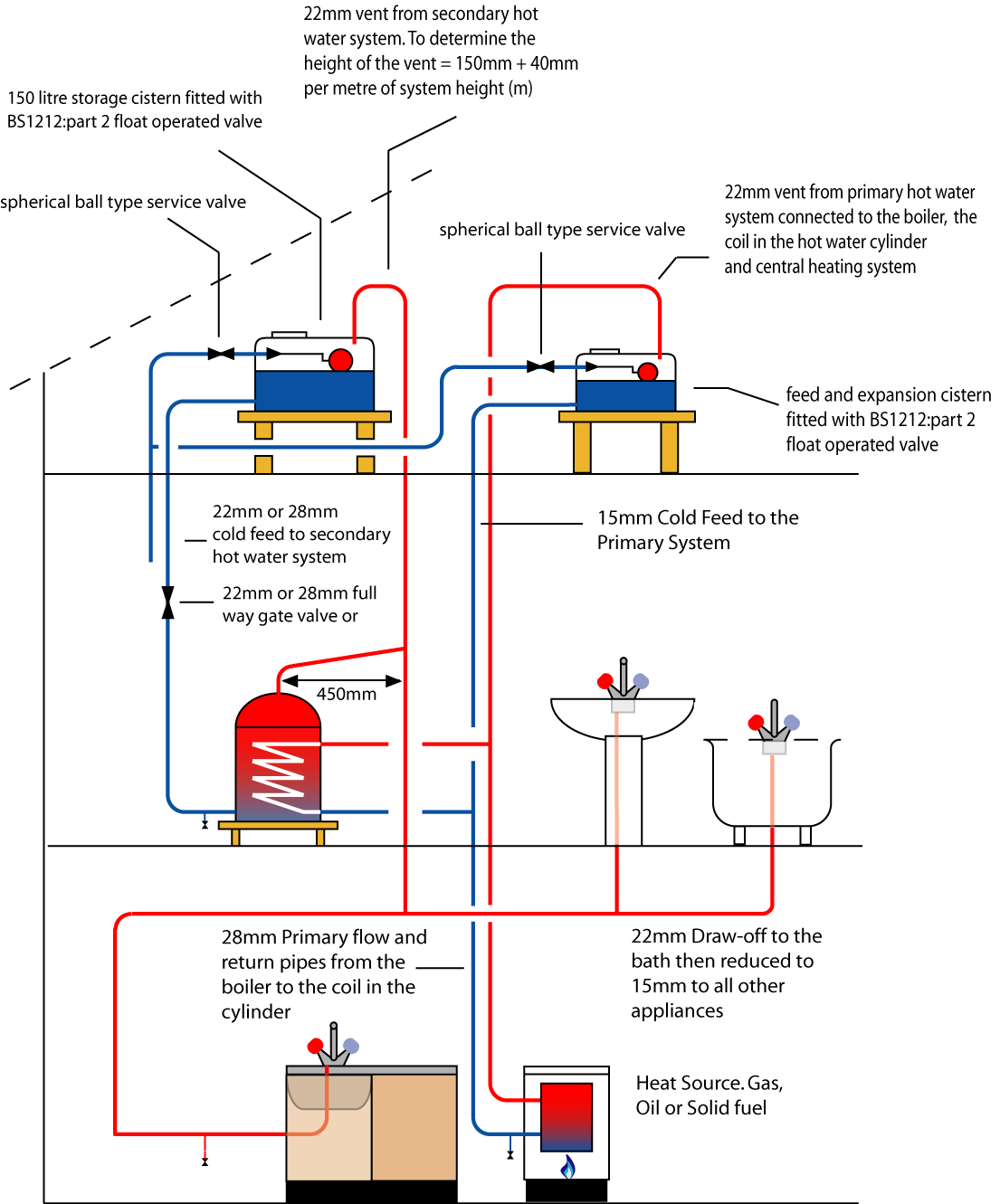

Look at this diagram, Are you sure the tee is out of sight?

I have attached a picture. The 15mm feed pipe and 22mm vent pipe from F&E cistern can be seen side by side between heating controls and Radiators wireless thermostat receiver shown on top right corner of the picture. I was thinking to run it only for a short period, maybe just hot water to the cylinder...

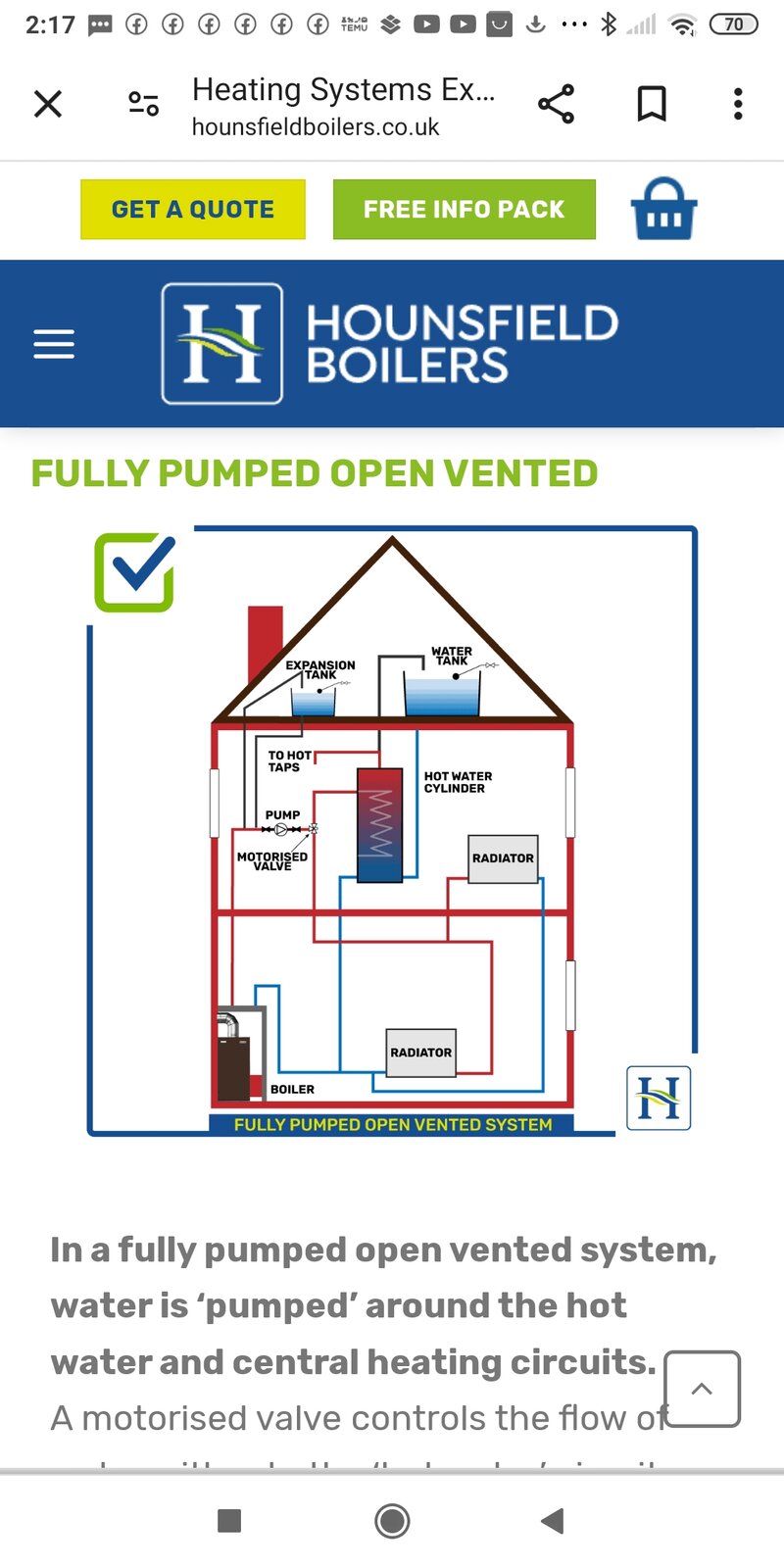

Yes the tee is out of reach. I have attached a picture of what I believe my system is which now makes me think. If that is correct, the only way to drain the Expansion tank is through the boiler because the pump is not running and the motorised valve is shut as I switched off the heating controls. Will the water just drain through the boiler if I have a drain hose connected to a radiator downstairs?
The area in question is the tee left of pump.
Regardless of tee being out of reach, the blockage most likely is there. Slow fall and rise of system water during heating cycles, along with originated water in the header tank, leads to buildup of sediment in that tee. Heating of water in the cylinder is effected as is draining down the system. At present, if the blockage is extreme, the expansion into the header will be from the vent pipe, leading to accelerated corrosion
Since system water has to pass through that tee, header will not drain no matter where you try to drain the system from. You could bail the water out of the cistern but that defeats the issue
