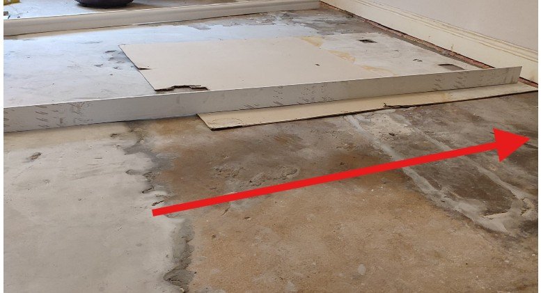

Recently remove a carpet and putting down 12mm laminate flooring with a 5mm sonic gold underlay.
the room is 6m x 4m. the effected area is area is around after 4.5m as you see whether I have inserted a 5mm plywood and the red arrow
Would i be ok to just screw the ply wood to the floor and lay the flooring. worried about the edges of the plywood effecting the joints of the laminate.

Use self levelling compound, if you lay the floor over that it's bound to bounce, for the sake of 15 quid or so it's a no brainer.
I did and follow the instructions of adding 3.5ltr of water to a bag and it was too thick to do much and set so quickly didn't have a chance to smooth over
You be better with a decent bag & bottle compound like Ardex CL or Mapei latexplan
