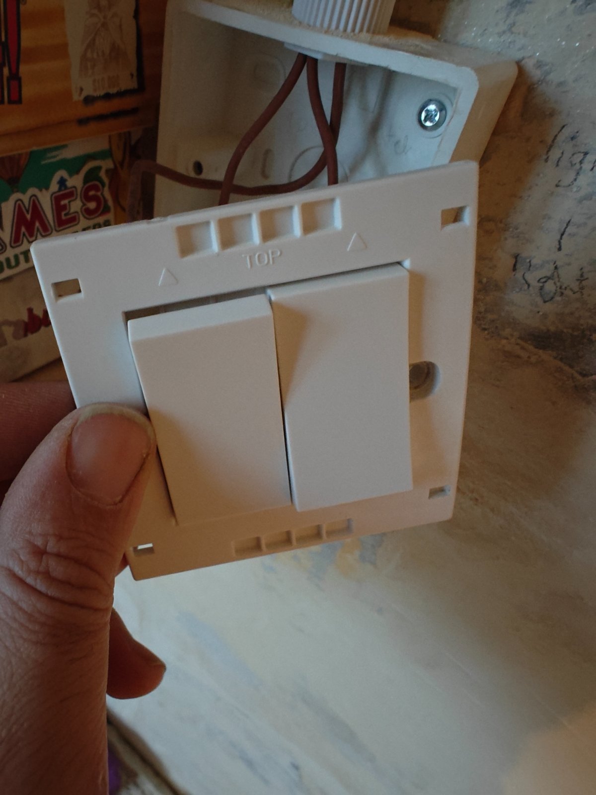

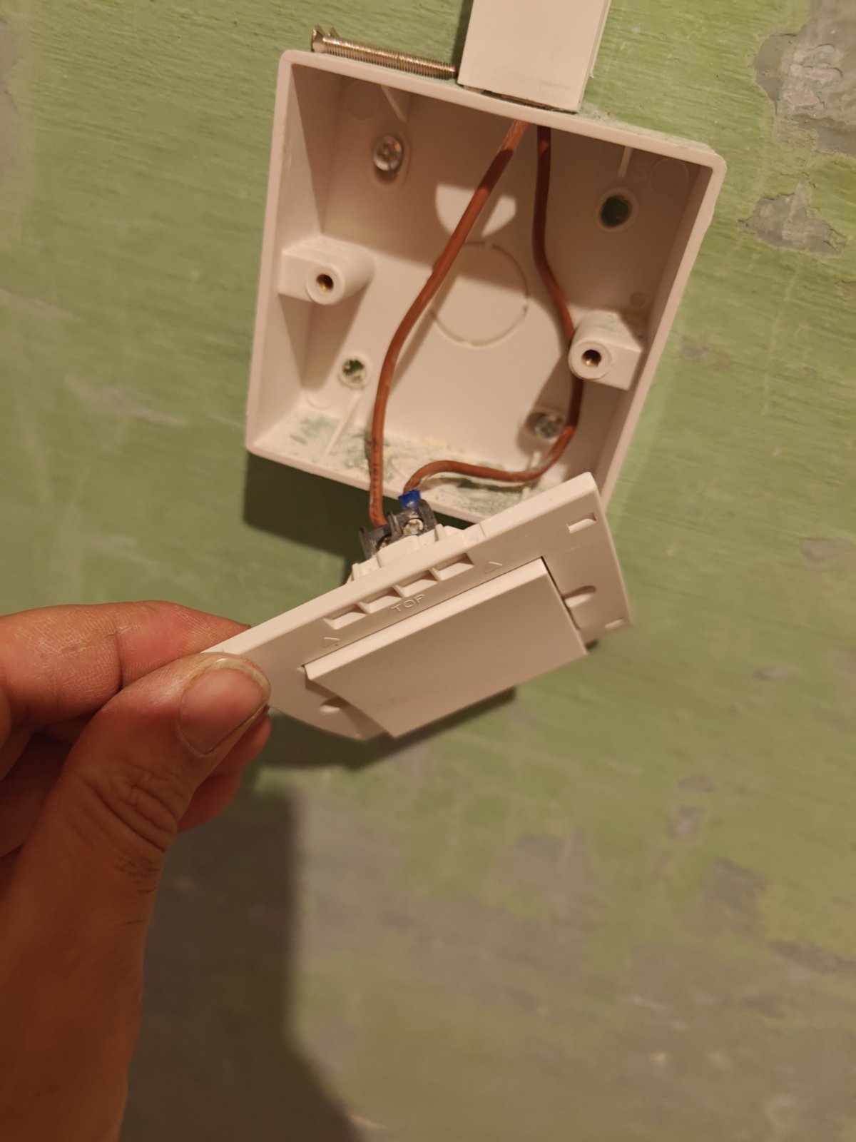

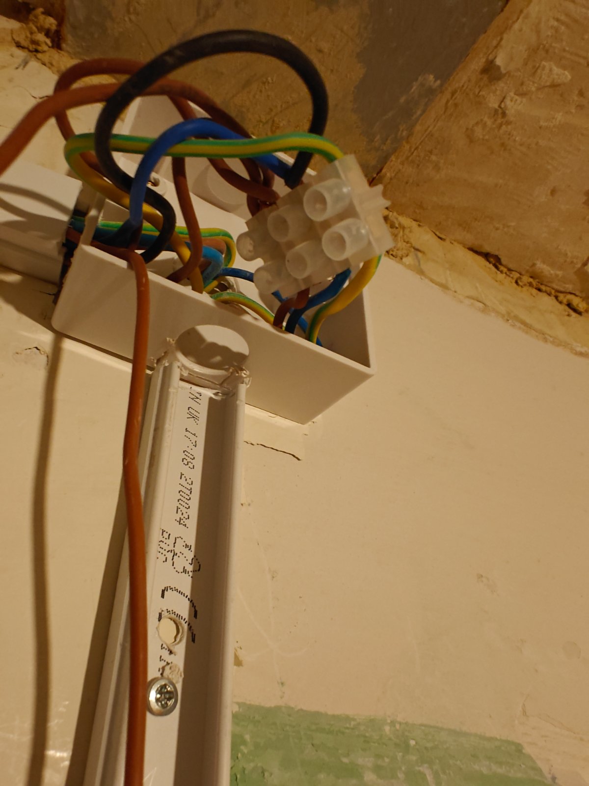

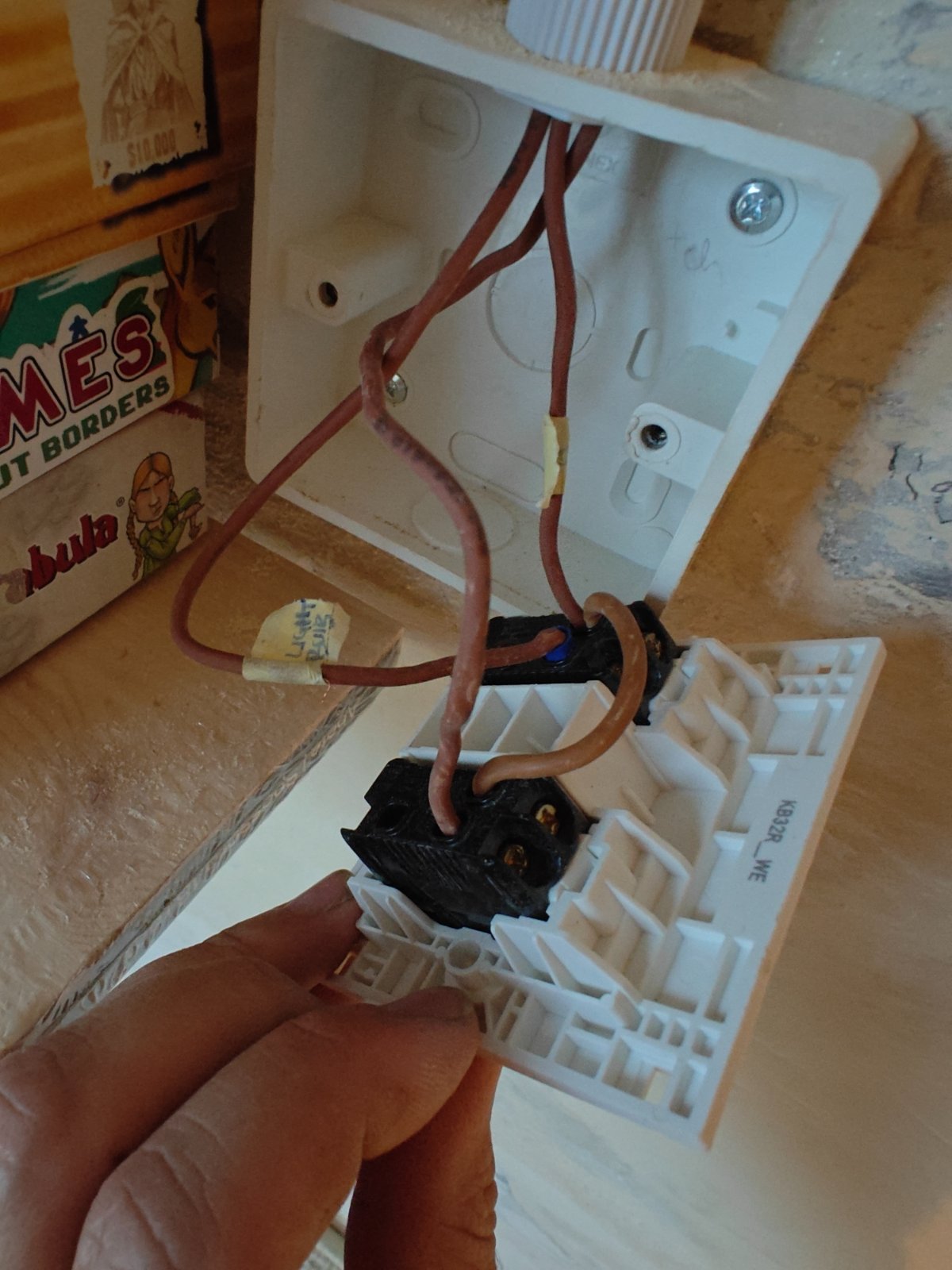

Hi, I am in need of assistance with reference to a wall light. Basically I have a one gang switch at first floor level and a two gang switch at 3rd floor level. The one gang switch and one of the switches at 3rd floor level are aimed to switch on and off the wall light. I have connected the COMS on both switches. The neutral has been connected, and two live wires have been connected to both switches directly from the wall lamp (L1 and L2) thus I am fiding a problem in switching on and off from the different points. The bulb switches on and off only either from one point or from the other. Is the problem coming from the COMS? Should I connect only one COM? Or is it the both switches have to be two gang? Thanks

I cannot switch on and off from different levels.
This is a new system I wanted to apply, because I want the light bulb to be switched on and off from both levels, while I have another light bulb at top level which I want to switch it on and off only from the top level. Therefore, I believe that I have to have separate switches for both?

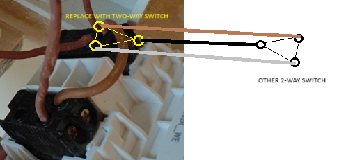

To do what you want you will have to replace the switches with "two-way switches" and run a "3-core+earth" cable from one switch to the other.
Thanks, so it is not possible to have one with 2 switches and one with 1 switch? I will replace with two way switch (one button each) if I am understanding correctly.
Yes, you can have one with 2 switches and one with 1 switch; you can have one with six switches if you want.
You are comparing different things, the two-way switches are needed to work the same light from different floors but there is only one switch on each floor doing that. Any additional switches will be to work other lights.
Plus you need the additional cable as I have said.
I think you need an electrician.
