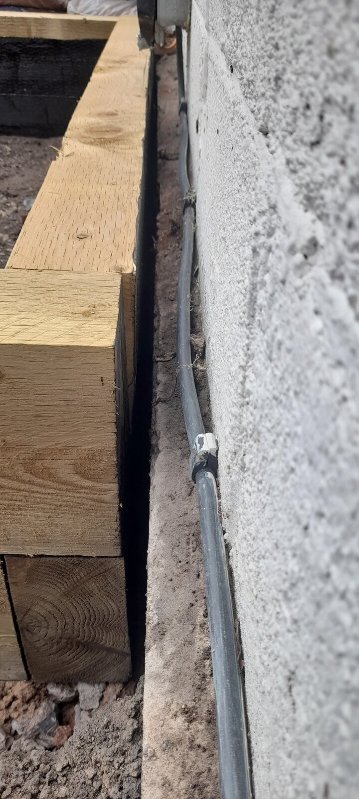

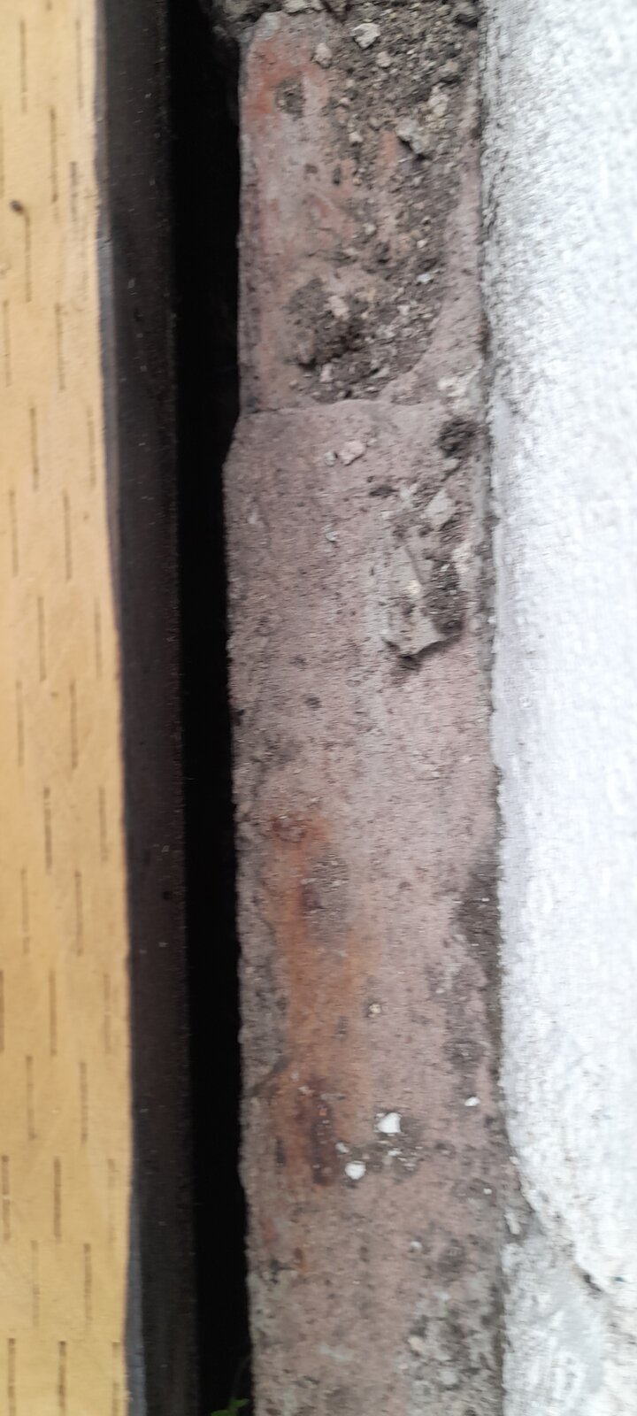

Hey all, I have just dug out a load of soil for a new patio and raised beds. I have built the raised beds as close to the wall to help support it because the footing is only 6 inches deep and I have dug deeper. I have just shut my gate and noticed the wall moved. Can I just fill in the 1 to 2 inch gap between the bed and the wall and if so what with? Many thanks for any guidance/ideas/ solutions.

Is it single block thick along its lentgh. You may need to add some pillars
Yeah it's single block thick but I've set the raised beds in. I still have some more to do so I will post some pics tomorrow to give a better idea of my problem. I need to dig out about another metre along the length of it so maybe I could rescue it without dismantling the raised beds. Thanks for the reply.
