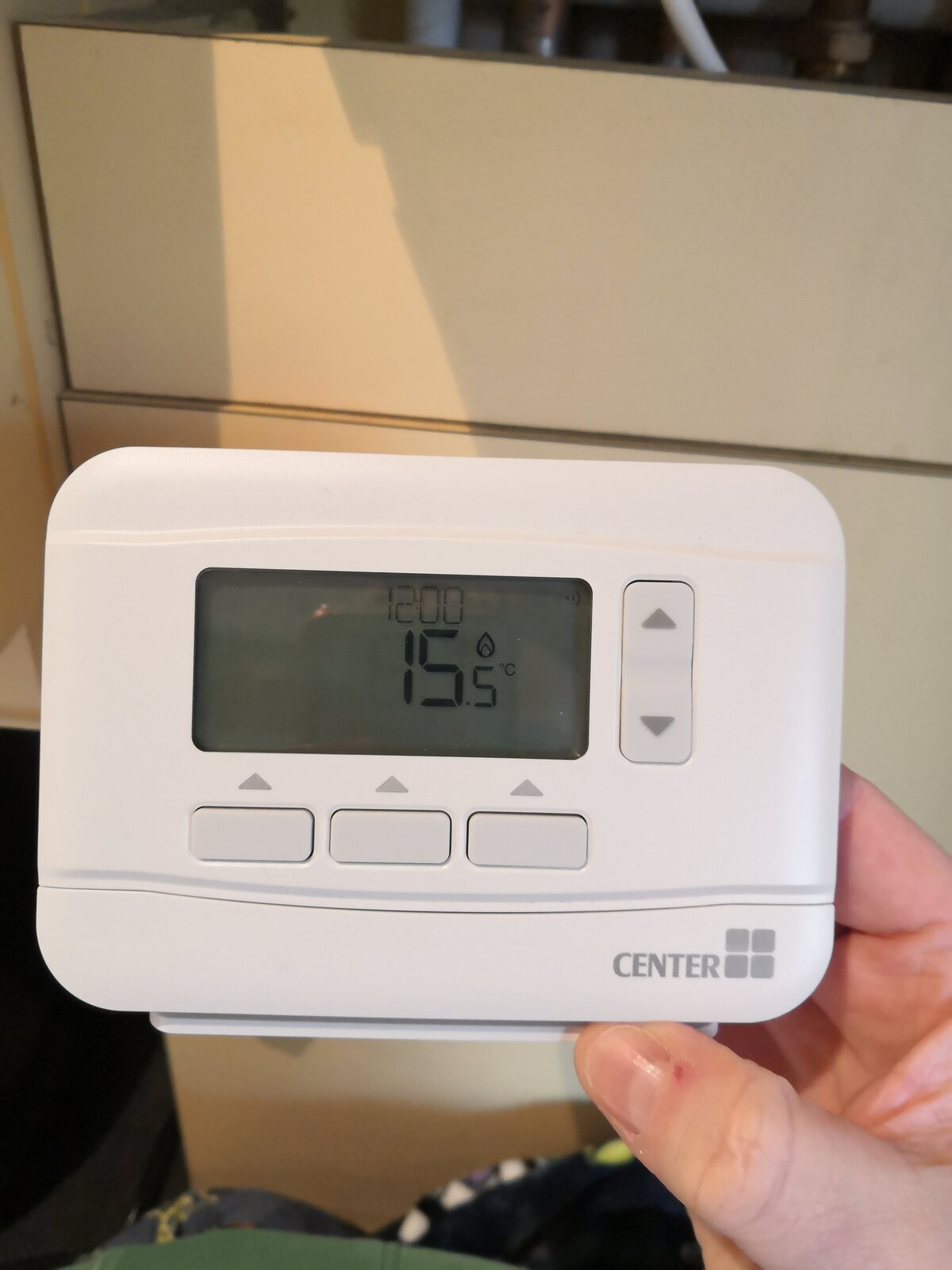

Hey guys I'm back again, I want to replace the thermostat/receiver (if this is what they are named) that was installed with my boiler a few months ago with a WiFi enabled (Google & Alexa) one. Needs to control heating and hot water. I see two which are different (3A & 16A). Which would be the correct one I should buy for UK? My boiler is a Vaillant if that helps. Relatively new.

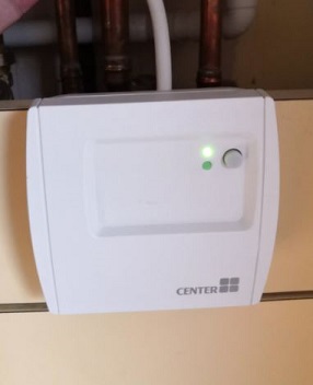

Below are pics of the installation as it stands. A wireless controller (not WiFi enabled) that control's the heating to (small receiver installed below boiler).
Controller
Receiver

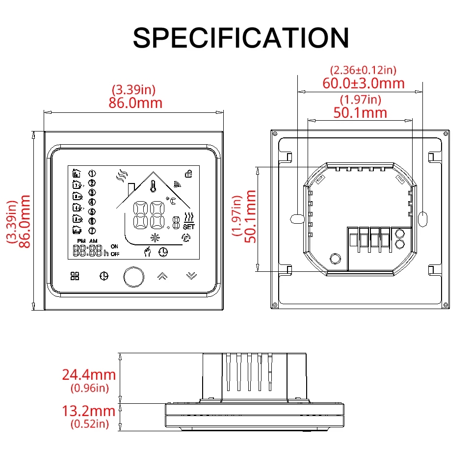

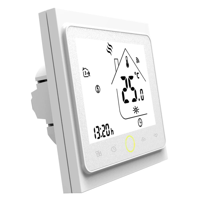

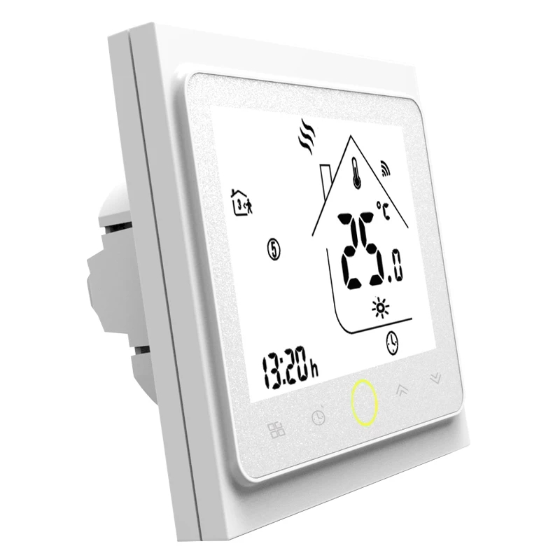

Here is the image of the one I want to replace it with
Is this possible? Also can one run both those receivers off the same wiring so I can still keep the original controller and receiver? Or is this a daft question?.

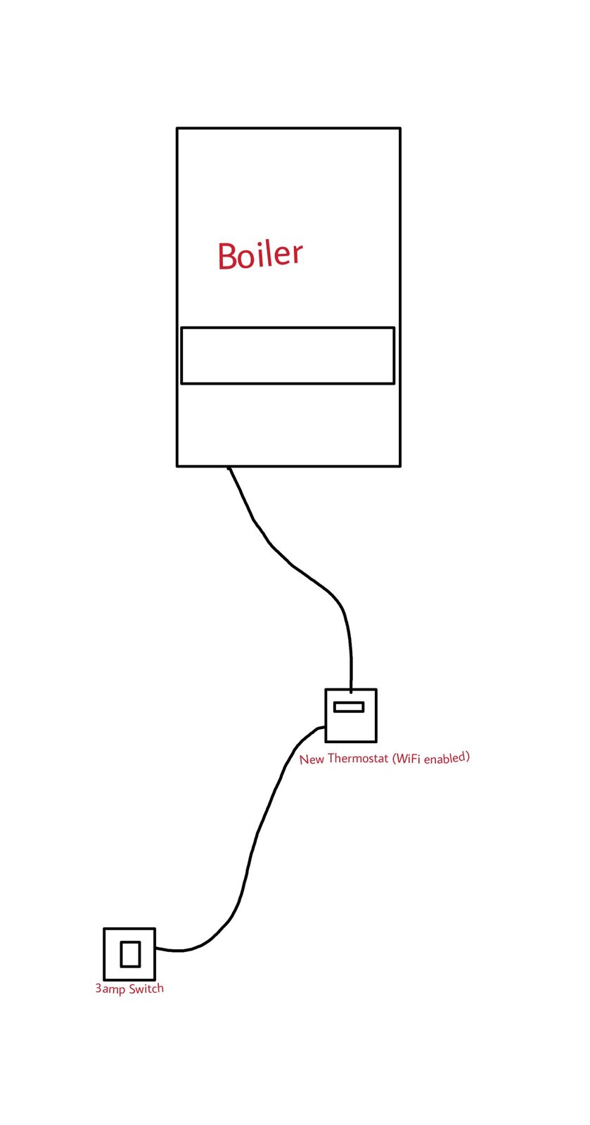

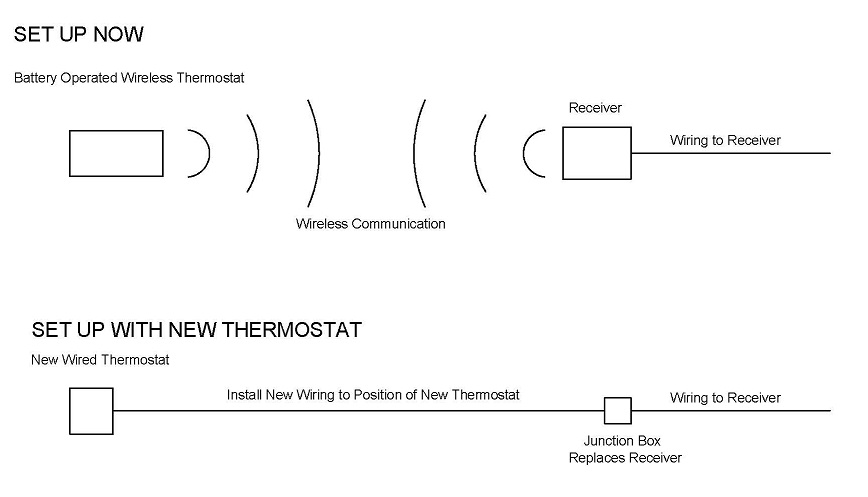

Your existing set up comprises of two parts:
1) A wired receiver that communicates with....
2) A wireless battery operated programmable thermostat. (You have labelled it a controller)
The thermostat you want to replace them with is a mains operated wired thermostat. It requires 230V to power it and will not work with a receiver. That means that the old receiver would be removed and the wires from it would need to be extended out to the position where the thermostat was located.
For a gas fired central heating system a device rated at 3A would be sufficient. Larger current ratings are usually for electric heating.

Yes you can, but you would have to remove both the existing receiver and thermostat, then the wires that now go to the receiver would be extended out to the new thermostat.
Ah yes mate I get it now, that's more work than I wanted to do, meaning I'd have to open up the boiler cover and wire in the new wired thermostat to the receiver inside. Not that I assumed it was a simple switch of wires but I thought I could achieve it.
___________________________
Actually scratch what I sad above. I think it is achievable, going by your diagram I just route all wires into the new thermostat?

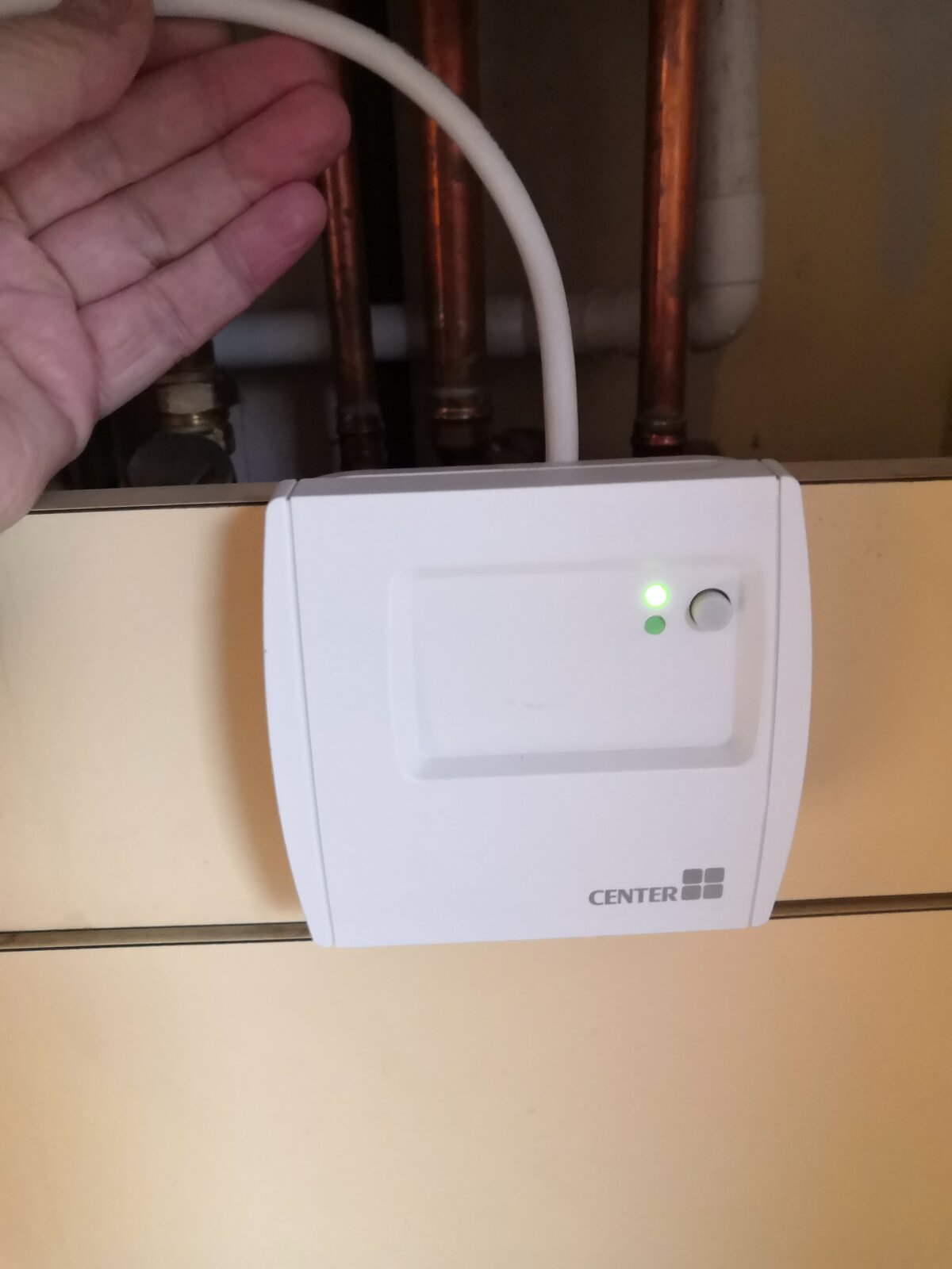

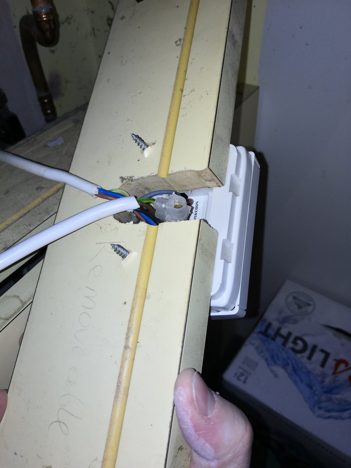

Here is a pic of the back of the receiver unit
One cable going up into the boiler (assume connected to receiver inside) one going down and routed into the back of a 3Amp plug for power. I assumed I could remove the receiver there and rewire the new one in.
I may get in contact with the boiler installed and ask about options. Great appreciate your reply. Thanks alot mate

Eh?? according to your photo the receiver is not inside the boiler...
With some combi boilers (but not all) to access the wiring terminals it is necessary to open up a sealed part of the boiler that could allow fumes to escape if not properly refitted. That is not a DIY job and should be done by an RGI (Gas safe) engineer who can then make sure it is properly sealed up again.
Therefore, I suggested that the receiver in your photo above would be removed, replaced with a junction box and then a new cable run out to the new thermostat.
If you want to keep the status quo, Nest or Hive offer the same set up as you have now; a remote thermostat and a receiver that would replace the two Plumb Centre items that you have now. From a wiring point of view, all that would be needed is to swap the receiver over.

Again thanks for your replies mate. What you suggested is what I wanted to do, the new thermostat would replace the receiver (I don't mind not having original controller as Ive named it) as I can control via my phone over WiFi. So I should buy a little junction box wire all the wires through that and a new wire going into the new thermostat screwed in place were the old receiver sits, That's what I wanted to do.
