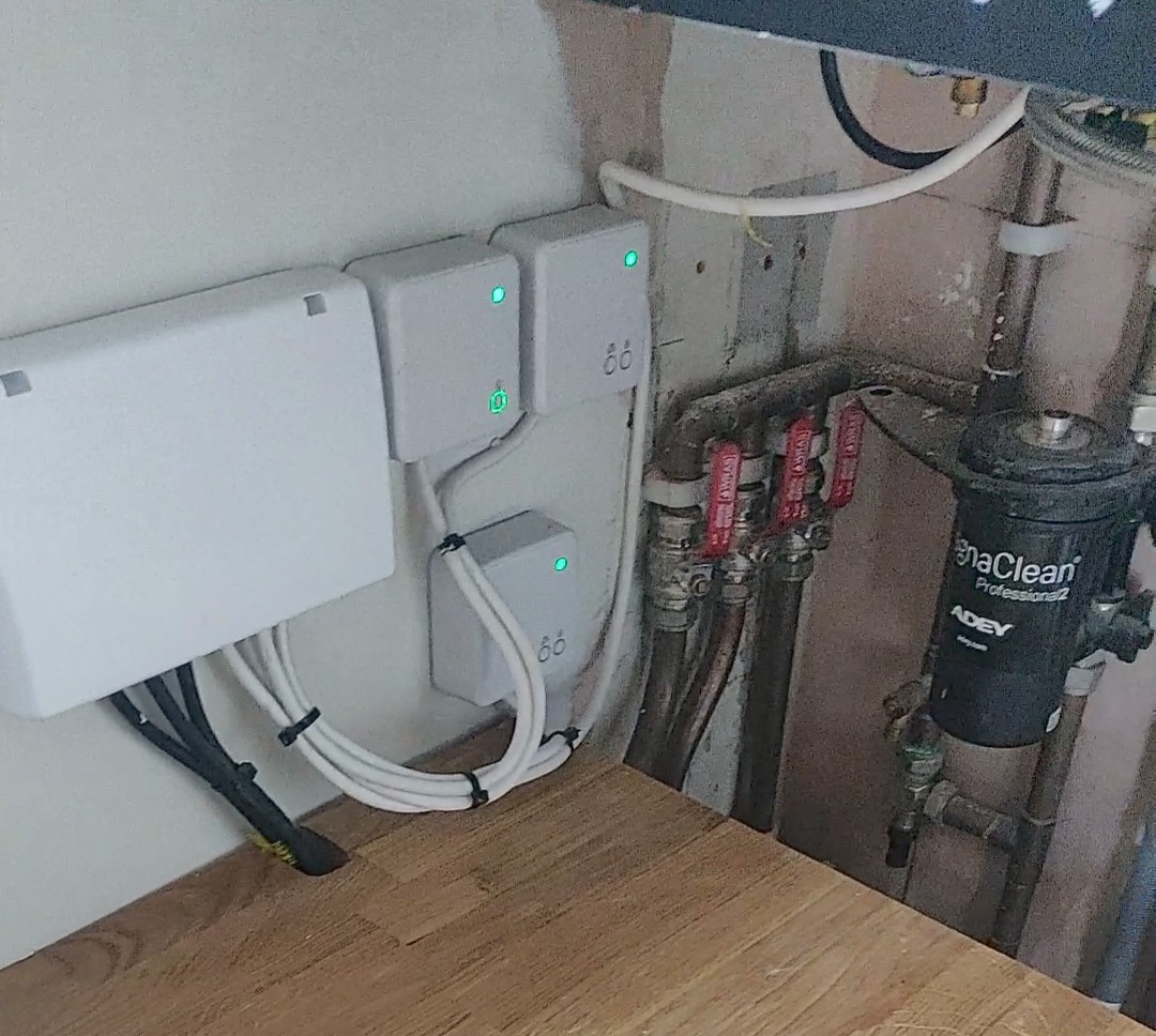

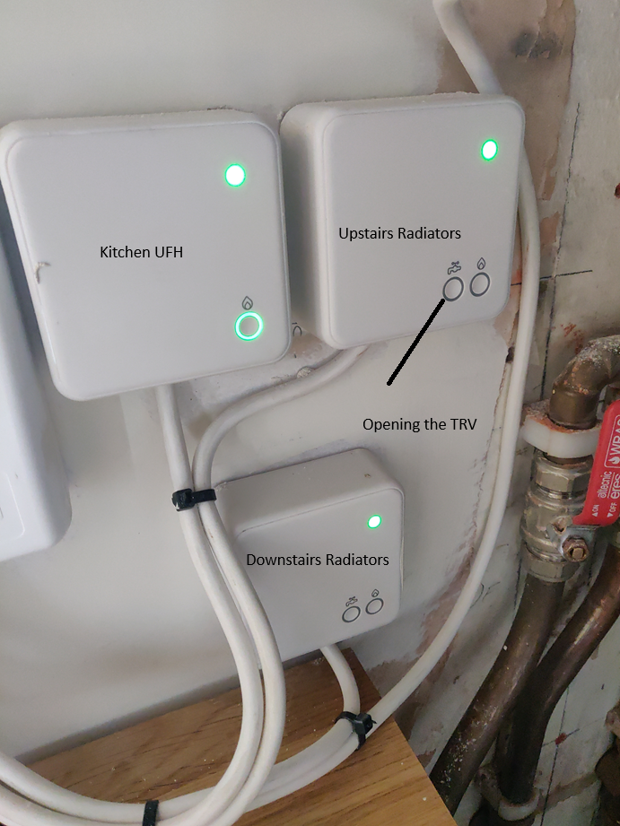

I recently had a Viessmann Vitodens 111-w storage combi boiler installed in my property but the electrician did not connect up the hive thermostat correctly. The central heating has 3 circuits, a UFH circuit for the kitchen (where the boiler lives), a zone for downstairs rads and a zone for upstairs rads. The system has 3 TRVs motorised valves installed and 3 Hive receivers. The UFH is connected to a single channel receiver but the rad zones are both connected to dual channel receivers. The wiring appears to be the wrong way around for the central heating, so I have to switch on the hot water channel to get central heating, and the thermostats therefore don't work. I have the thermostats paired directly with the receivers rather than through the hub as I'm not interested in any of the smart home features.
My question is, which type of receiver should be installed for this system? I was going to change them all over to single channel receivers but then I realised that the hot water timer might actually work? If a dual channel receiver can control a timer for the DHW I would like this to be connected but preferably shared with the UFH receiver as this thermostat will live in the kitchen nearer the boiler and the hot water time can be controlled from the thermostat.

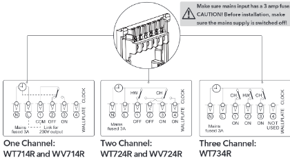

As DIY using Hive is great, it is simple, and works, as a professional it is not really the correct selection. This is the Drayton Wiser which is the same as Hive for wiring
but also has a three channel version, and also an extra
for connecting the OpenTherm which is missing from the Hive version. But the first diagram 1707921799123.png shows terminal 3 is DHW and terminal 4 CH so moving one wire from 3 to 4 should cure your problem, it will then work.
Looks like the electrician may have wired all the backplates the same which is wrong. Ideally you would have 1 two channel and 2 single channel Hives, you can then have the UFH and DHW wired to the two channel and the radiators zones wired separately into the 2 single channels.
