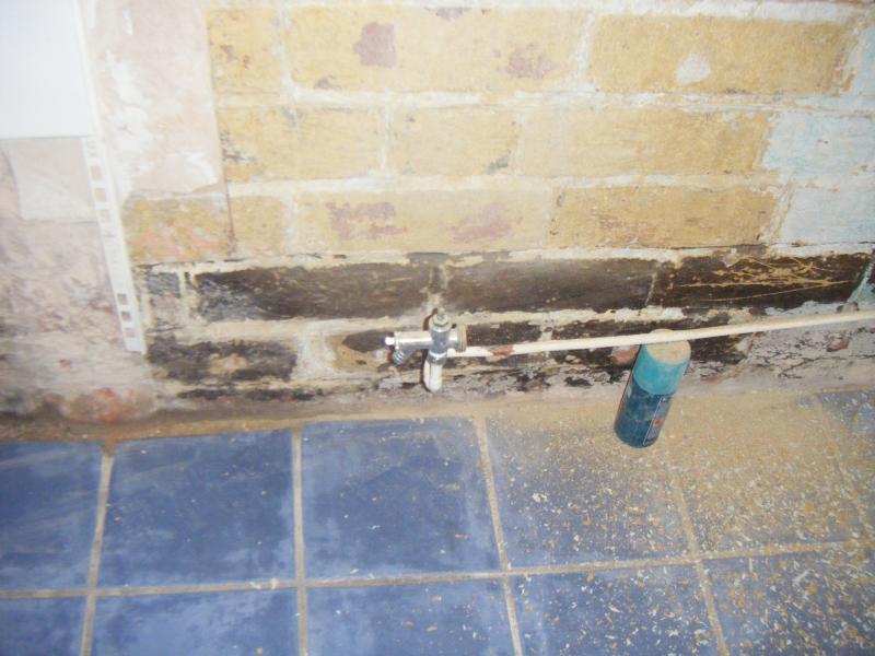

right - i dont know how to link to my album where all my photos are but there are pics of the wall in there

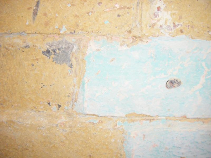

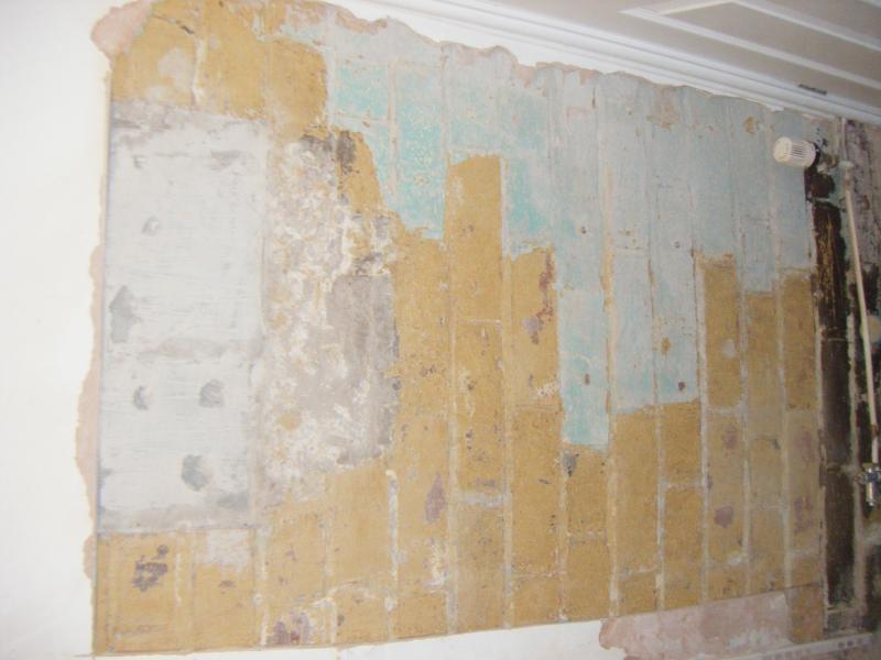

the guy who plastered it last plastered over paint which had been applied to the bricks. there is a layer of yellow and then green over the top. the green paint became loose in places and the plater started to come with it.
The room is an old outhouse which is now a downstairs bathroom and the walls are not cavity ones so we get plenty of condensation.
i have started to remove the green paint but the yellow paint is stuck on pretty well.
my questions are:
1. what is the paint likely to be
2. am i ok plastering over the yellow paint (i was going to use a 9" grinder to score the wall so that it sticks better)
3. why are the bottom two rows of bricks black
4. why is it that the wall smells slightly damp (the bricks)

id cleen it off then even just rake out some little bit of pointing as a key (WBA) or 2/3 coats of PVA strong 4:1 mix
then a tite coat of bonding devil float it
then two coat skim use muilti as it wil give you longer play time

You could also get an angle grinder and grind some "diamond" patterns (about 4" in size) all over the wall so it gives a "key" to whatever is used as the backing coat to the plaster. Or another alternative is to go over the area with a "scutchin'" hammer to give a "key". But I myself would use the grinder method....

if the wall is damp it looks like that the bottom 2 rows of bricks could be bitchumen paint where they have had a go at trying to cure the damp and if it still smells of damp you should sort that b4 any plastering takes place
edit
it wont let me say the word for what i want lol so another word for it is blackjack, the bottom two rows maybe blackjack
I "wouldn't even consider" putting gypsum plaster on the walls in that room, especially if the walls have no cavity, and is prone to heavy condensation. You're asking why the bricks smell of damp????,, because they are probably,,,,,,,, damp!!
