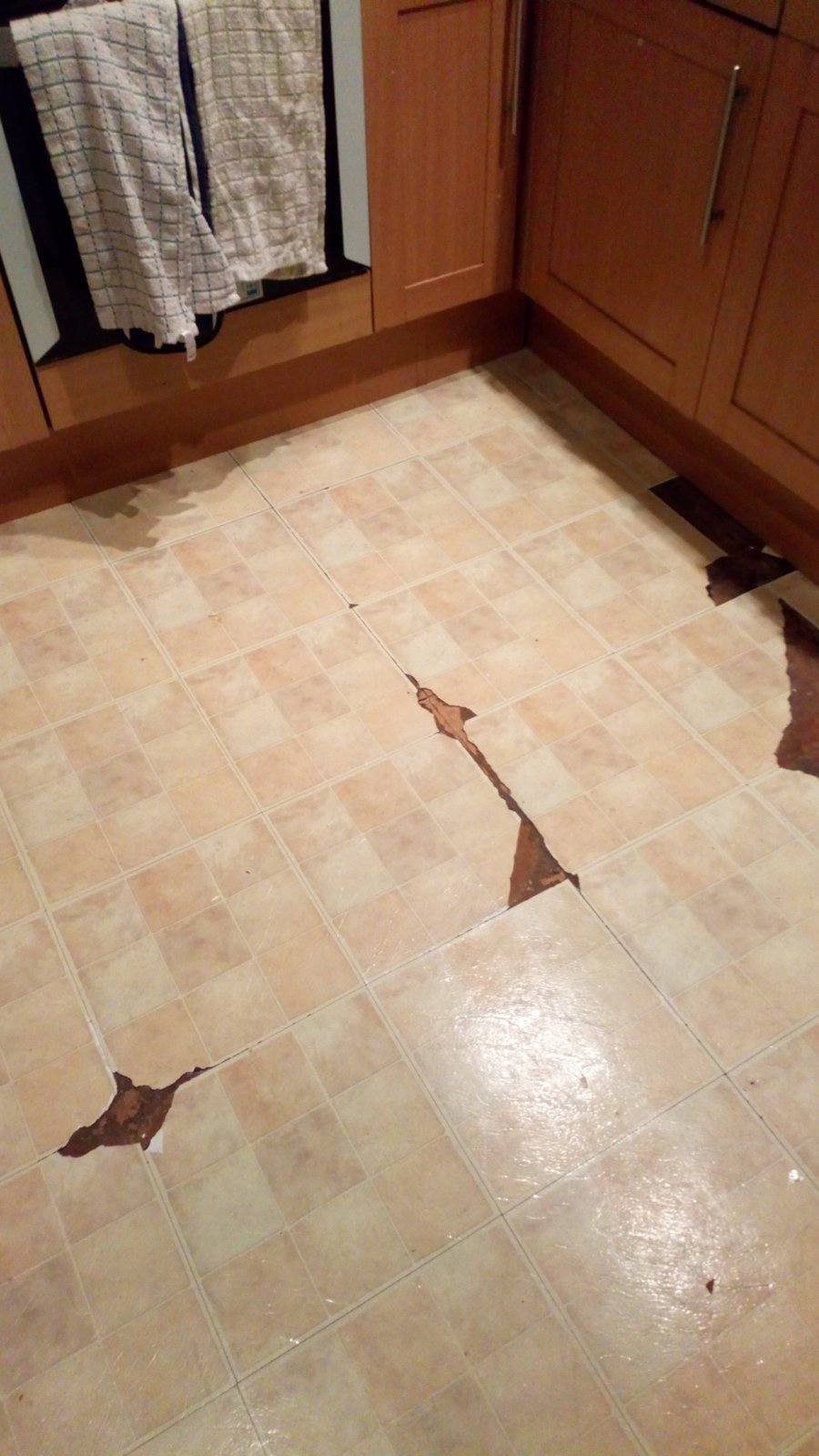

Got to hide this vinyl, was going to lay new vinyl on top. Never done it before so rather than risk ripping up old stuff would just cover it. Was going to buy a bigger than needed bit and slow cut it down with a Stanley.

Good Luck ! - get a hooked blade for the stanley, that'll help - I know from bitter experience using a straight blade;)
They look like vinyl tiles, need removing as the damage will wear thru to the surface of new .

Will do. Do u mean it's difficult ?
I was going to leave original tiles because if I couldn't cut the new vinyl properly and botched it at least the originals would still be there and not ripped up.

Should not take much fitting the new floor will run under the kick boards .

Yes, leave the originals - hooked blade is for cutting the new stuff - it's what the pro's use - I watched them;)

Yes, but try not to kneel directly behind the blade. If it "skips" out of the cut it will make a painful puncture in your knee or thigh. I speak from experience! (and I've seen trade fitters spear themselves with them as well)
