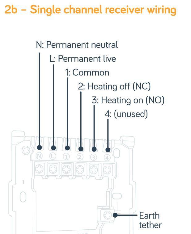

From what I have worked out from the manual the Hive receiver to the boiler would need to be wired accordingly.
- Neutral to Neutral
- Live to Live
- Earth to Earth Tether
- Heating off and Heating on links on receiver would then need to be wired into boiler into the 2 links Room/Stat depending on which is live.
So where would the Common link on receiver be wired to?

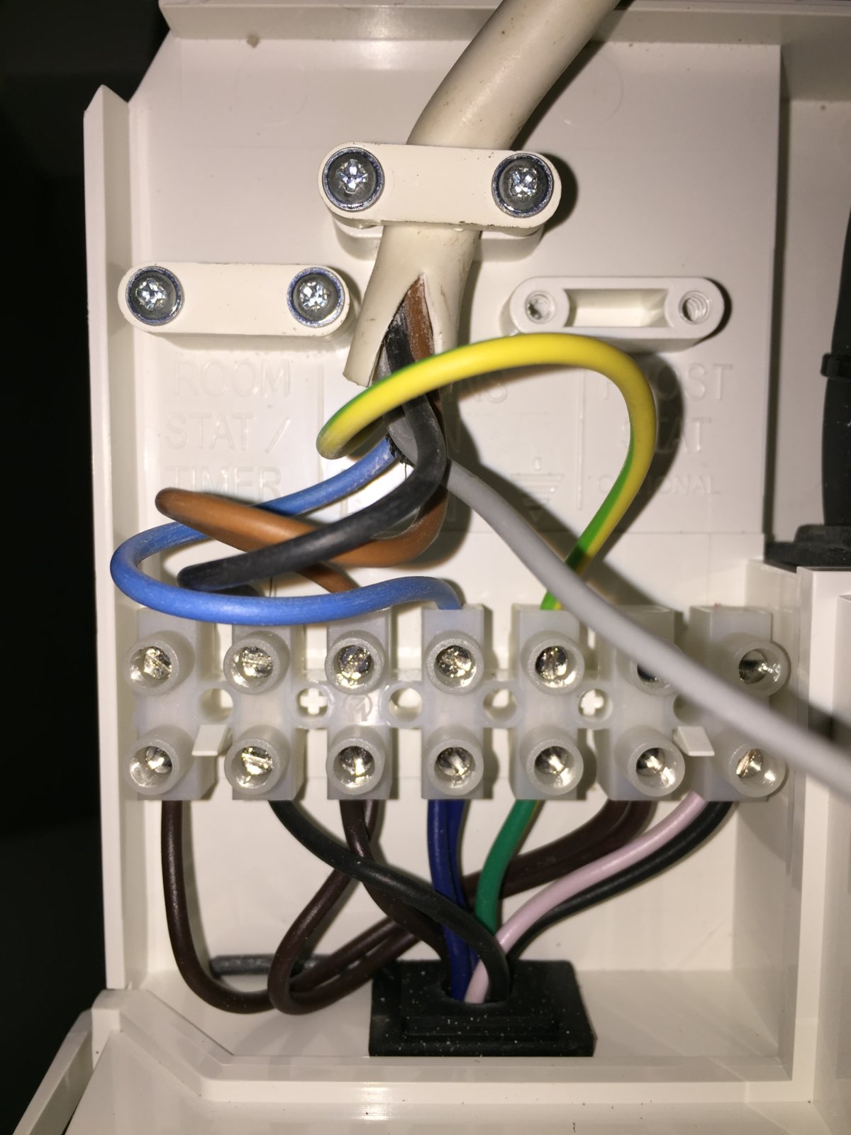

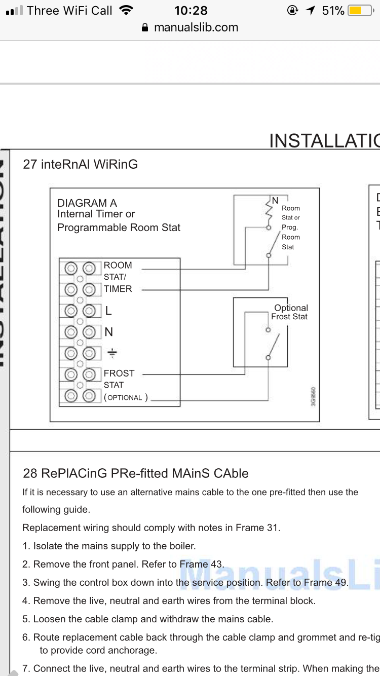

I have attached pictures of my setup.

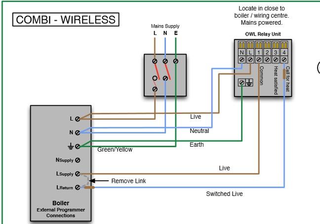

The existing (OWL?) unit is a switch
The HIVE is a switch.
just swop one for the other, how hard can it be?
I don’t have an existing switch.
That is a diagram hence it being a picture of a diagram rather than an actual photo.
So, Boiler external connections drawing.
You need to run a cable or cables to the Hive. You will need 4 cores and earth. So one length of 4-core and earth cable. or use two pieces of 2-core and earth.
Live, neutral and earth supply. from boiler to the Hive. Like wiring up a plug (easy so far?)
Then remove the link between L supply and L return
You now need another another 2 cores of cable. One goes in L supply at the boiler and connects to Common on the Hive. One goes in L return at the boiler and connects to Call for Heat on the Hive.
Tha's it.

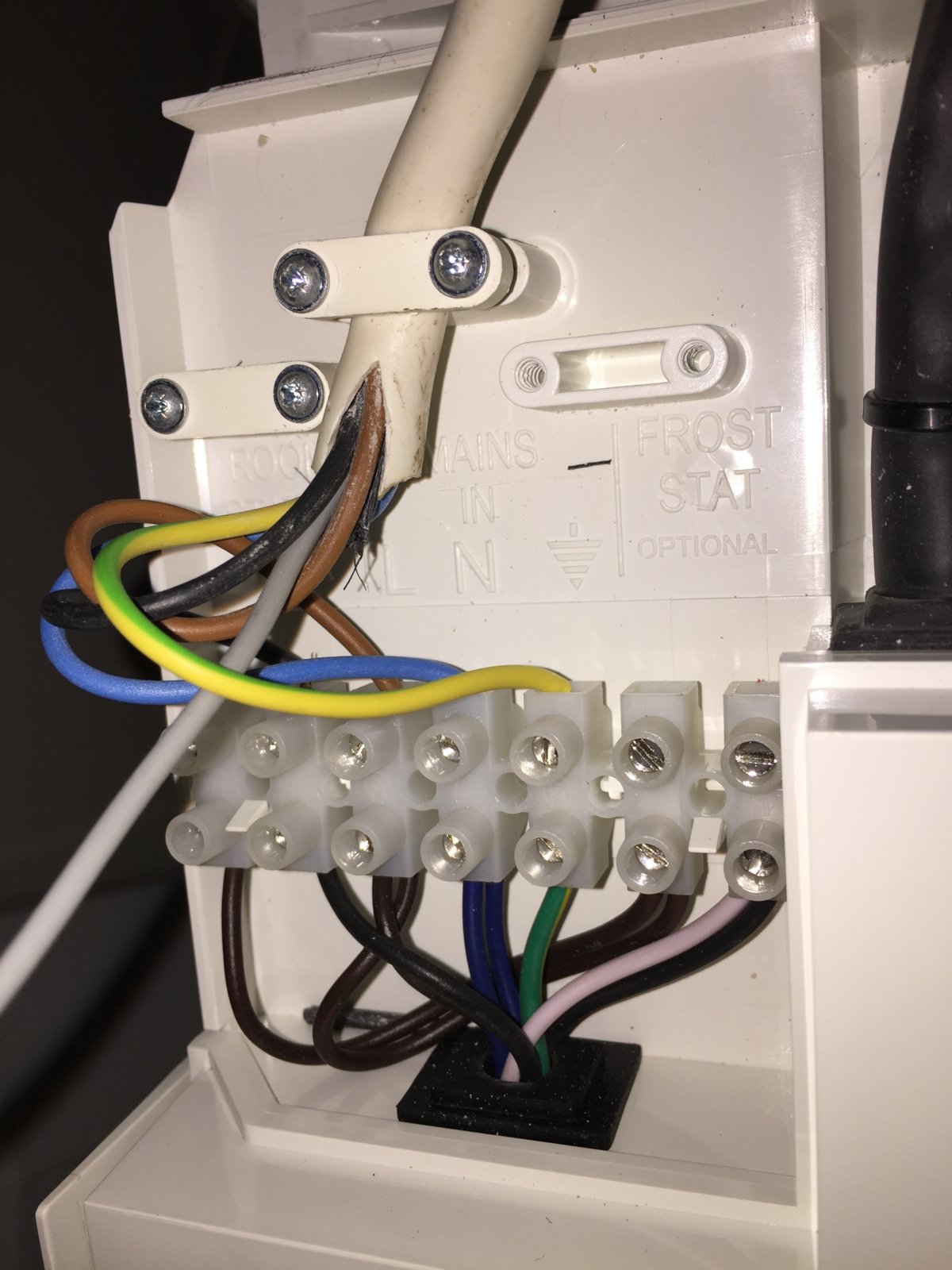

Where do those wired thermostats come together to control the boiler. Do they both terminate inside the boiler, or is there some other wiring centre/zone control wiring somewhere?
How are the rooms heated, radiators, or under floor heating?
Is there a separate pump/manifold for the two zones?

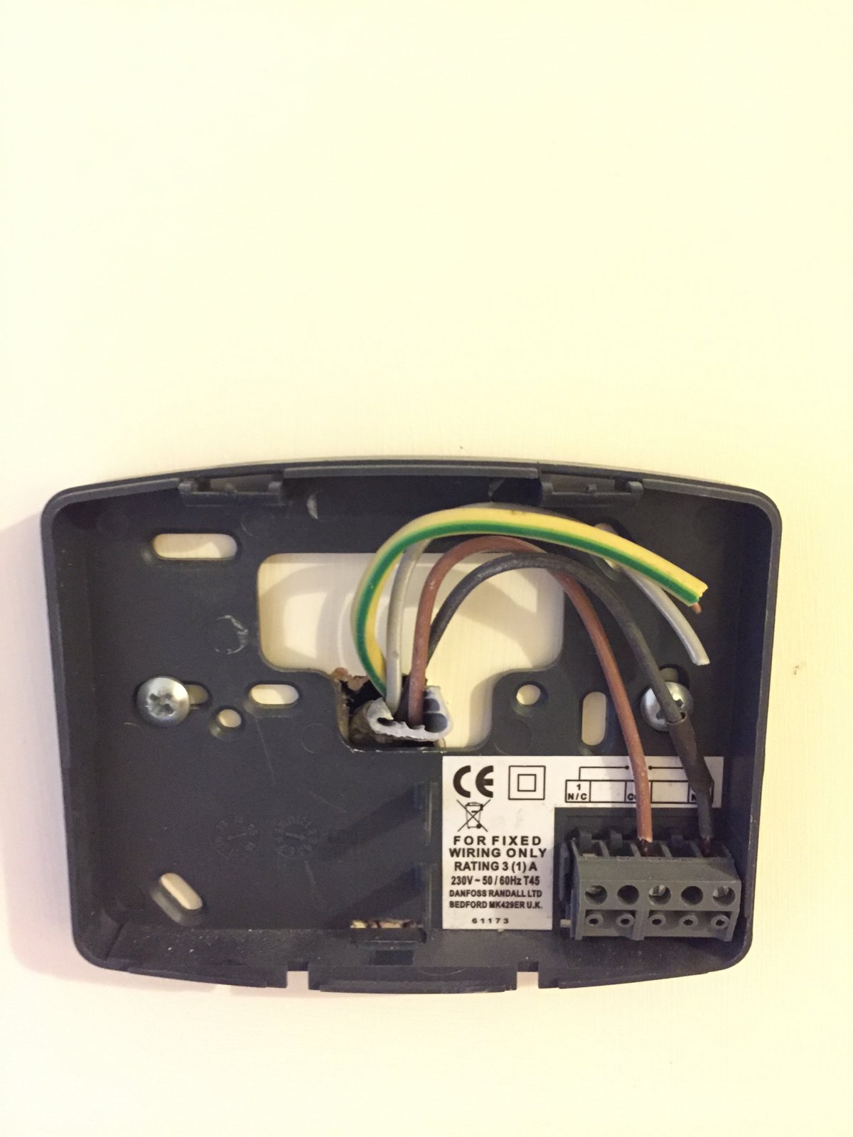

This is what both the upstairs and downstairs Thermostats look like. Hence the ease of installing a Tado (but unfortunately still in same locations)

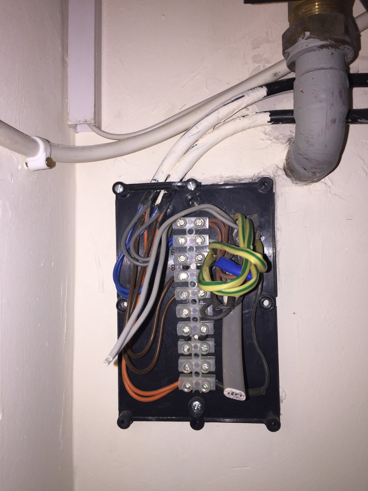

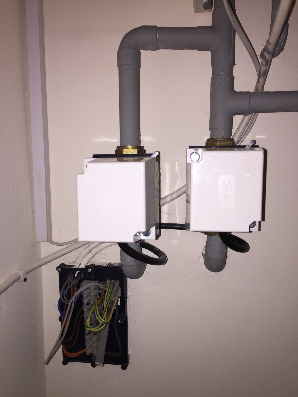

And below is an example of whose what and where attached to the valve actuators (looks an absolute mess from here) but I’m guessing whoever installed it then it made perfect sense!
Yeah I will be getting 2 thermostats for the 2 different zones.
I can see exactlky what is going on there. You have two stats and each controls one of the zone valves. The valve outputs are commonon toigether and call for heat when either of teh valves is open.
I have no idea where the pump(is) is/are. I would have expevted one per zone.
In my opinion. You will need two Hives* or Tados. One for each zone.
Looking at your setup, and (with respect) your knowledge level. Go for 2xTados. One for each zone.
They are battery powered and you can just swop the existing stats for the Tado backplate. It only needs the two wires that are already there.
The Hive backplate needs a neutral and there is not one at the stst positions, although you have a spare wire that could be used for this, but you'd need to do some wiring.
EDIT: *You could go for the HIVE multi-zone but this WILL need some serious re-config of your wiring centre, so you'll need to invite the lovely skilled British Gas organisation in to make a job of it.
