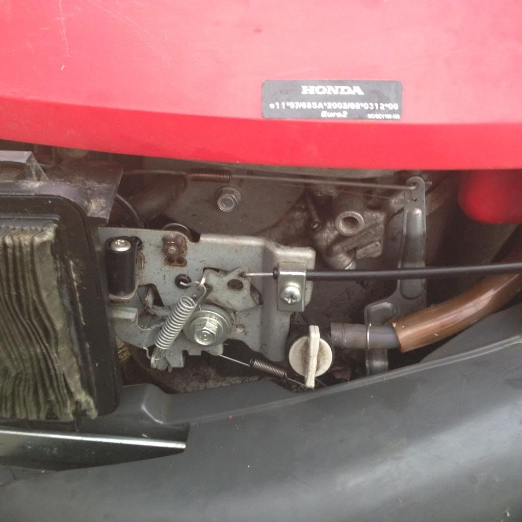

Hi I have a honda hrx 426 it's it pretty good condition but it surges know when I got it there was no filter cover on it also filter is dirty also it only idols when I puss the rev lever nothing happens but if a rev it at the engine it revs fine I've check the cable and it is ok the governor spring seems slack but not broken any help please as I'm going mad thinking what it could be thank you

From memory, the governor spring only tightens when you pull on the cable, does yours do that?
I will try and get a vid it cuts out when you take the filter off when it's on choke but surges when on the hare setting you have two have it on the high speed for it to run when you move the handle to slow it stop seem its on slow when it is on high setting the govonor spring is slack but not broke
You need a new air filter mate and forget about the governor spring - please don't alter that!
Your carb has a blocked pilot jet and possibly an emulsion tube too.
You may have seen the idle mixture screw on the top of the carb has a tamperproof top and can only be adjusted 1/4 turn. To remove that, snip off the small lug - don't lever it off as the whole screw head will come with it :shock:
If you can remove the carb, and take the float bowl off (central 10mm screw) the main jet is dead centre of the carb and the emulsion tube above that.....a tin of carb cleaner aerosol is needed here!

surging on most mower engines means that you need to give the carb a clean out and clear the jets. done it a hundred times. a really dirty air filter will just stop a honda engine from starting at all.
remove the carburettor bowl it's probably full of ****.

As munching b said if not the bowl its general carb dirt and partial blocks
Are you saying that the engine revs ok when you operate the governor rod by hand, but it won't respond to the throttle lever?
With the engine off, the throttle linkage on the top of the carb should be open.

Cleaned the carb full also done a full service no surge purse like a kitten so thanks for all the info now for my other problem it only ticks over doesn't on the fast setting when you put it on slow it stops any info cheers
