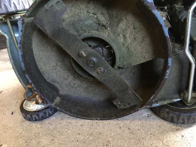

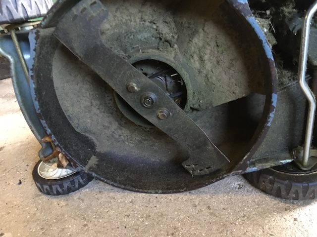

yep, it is blue
it been on the coast all its life - 0.5km away
always in a garage and covered - But yep, is rusty - maybe during next winter i could see about cleaning up
I put some acf-50 , some couple of years ago , my son-in-law recommended , i didnt realise needed to do regularly , thought it was a on-off treatment
