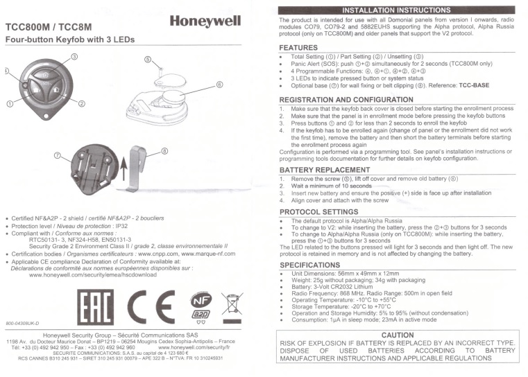

Thanks @GalaxyGuy! I'll give it a try tomorrow and let you know. Btw do you know how to set up the programmable key combinations? The install instructions I got with the fob say that there are 4 programmable functions, these being: button 4, buttons 4 + 1, buttons 4 + 2 and buttons 4 + 3. However it gives no information on how to do that! It does mention "Configuration is performed via a programming tool. See panel's installation instructions or programming tools documentation for further details on keyfob configuration", but I'm not sure whether or not this refers to the programmable functions. I could not find further instructions anywhere.
I'll attach a scan of the leaflet.
Although the remote is capable of those sequences, the Galaxy panels do not implement anything with them. The documentation isn't clear (it comes from the French division), but it means programming at the control panel side and not the fob itself.
I'm working on a home automation bus module that will be able to pick up these key presses from the Portal and do something with them. This does require a home automation controller to pick up the information via MQTT, make a decision on what to do with it and then send control commands via MQTT to the panel.
I finally tried the suggestion and it works. With just 1 group assigned to a user the RF keyfob key-presses work as expected, but on that group only. That's fine, and clearly working for the house is the most important for me, but it is a bit annoying that I can't configure the key presses in the panel. I'd have the normal key-presses to operate the house group and the "programmable" key-presses to operate the garage group. I had wondered whether my firmware was too old to support it (v6.93) - it sounds like it's a chore to upgrade (I've never attempted) - but from what you've said support has never been added. Thanks @GalaxyGuy for the advice.

The latest 7.03 firmware has no support for this either.
