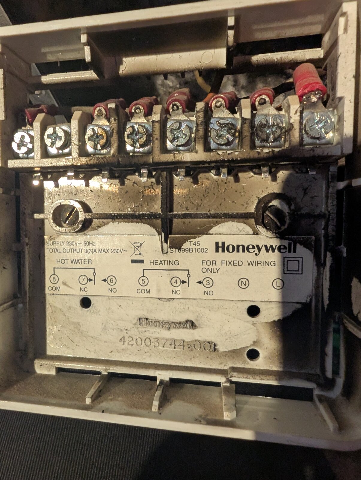

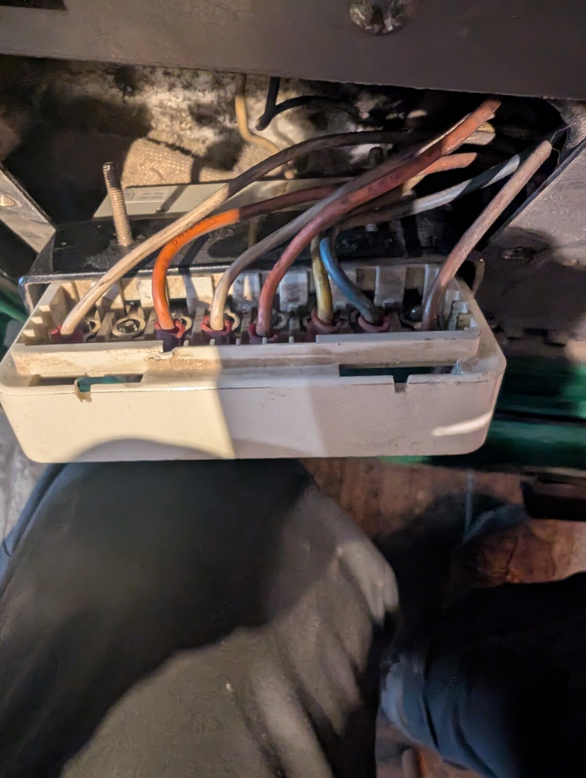

I to am after changing the st699 to a st944.
This is on a Rayburn 480 kB, have attached photos of the wiring on the 699.
Any help much appreciated

Hijacked a nigh on 10 year old thread. Anyhow, I presume you mean ST400? If yes, the wiring should be straightforward.
