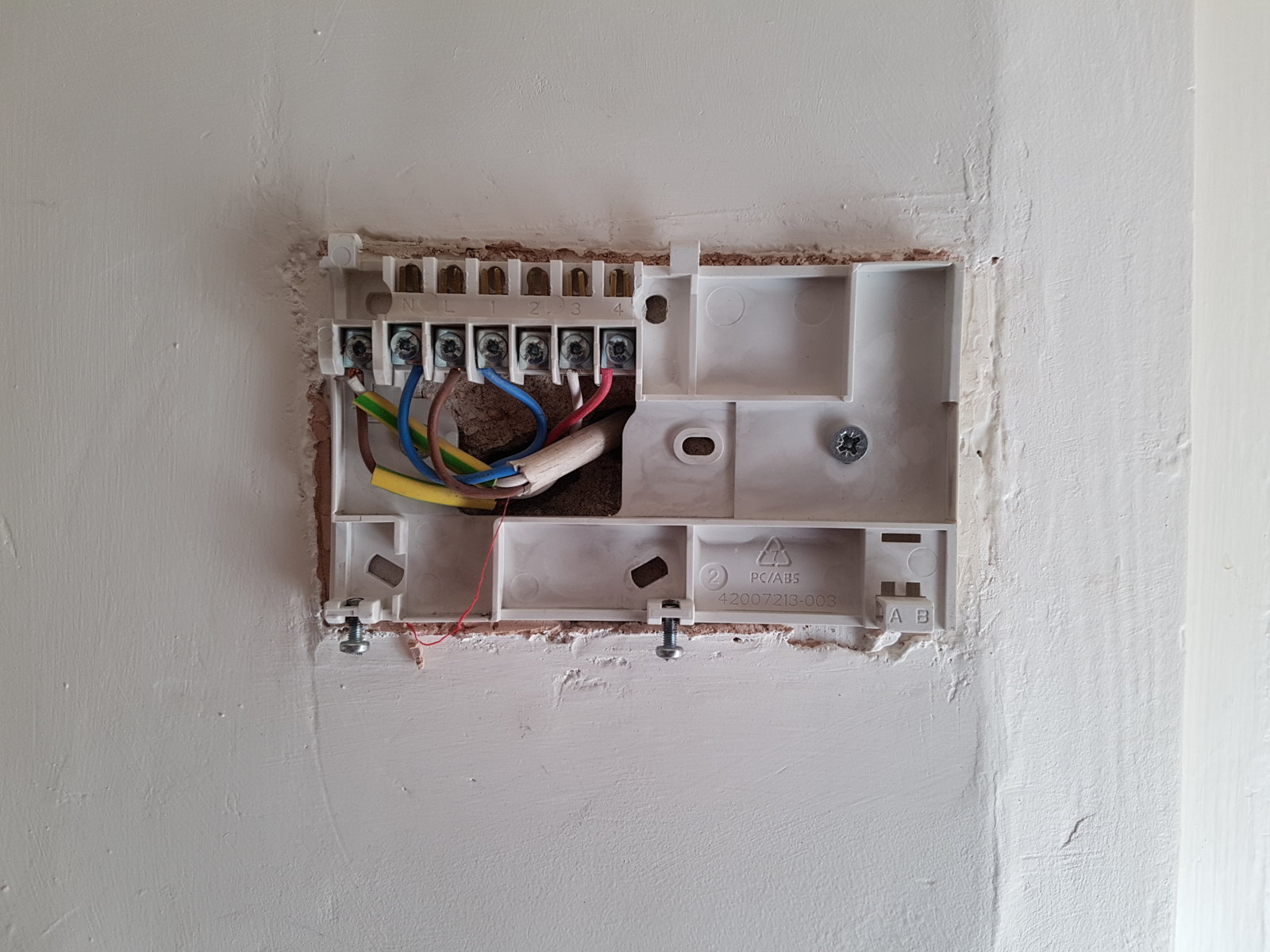

have a Y plan heating system with honeywell st9400c controller and a wired honeywell thermostat in hallway .
I have worked out which wire on st9400c goes to which nest heat link terminal.
What I am not sure is how to get 12v power required for nest thermostat . I don't have a direct cable between thermostat and heat link. Also based on st9400c photo attached in don't have any spare cables between controller and main junction box.
Help please..
Correct, so you need to wire your heat link into the wiring centre and use the existing thermostat wires to connect the Heat Link to the Nest, which will replace your thermostat
