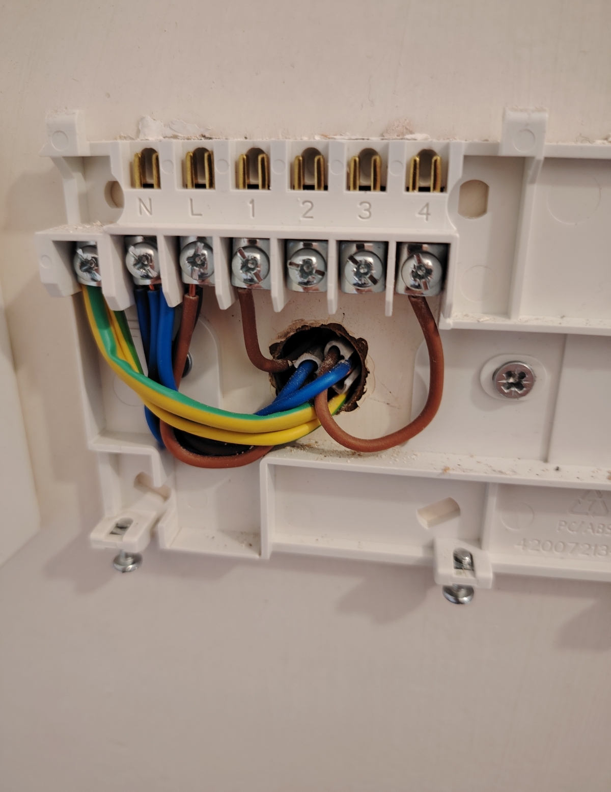

Hi,
I have lurked the forums for a while to try and resolve my issue but an't seem to find the specific answer. I would be really grateful if someone could offer any assistance.

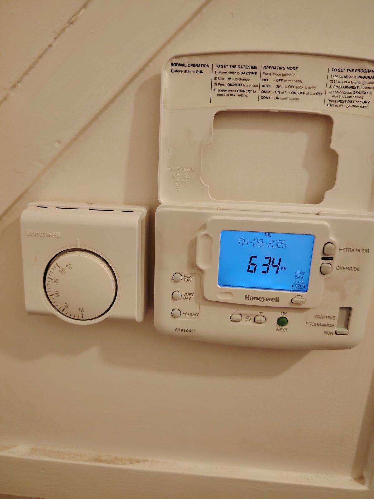

Currently have -
Baxi 200 series boiler
Honeywell ST9100c
Honeywell Dial
I wish to replace with thermostat and dial with a Wiser Thermostat Kit 1 single channel.
Is it the case of removing the live connected to 4 and reconnecting it to position 3?
I have attached a few pics of the current wiring, I would like to be able to test the wiser kit to see how I get on with it, so wish to be able to return to the original honey stay if I don't enjoy the wiser kit.
Many thanks
That does seem to be the case, wiser diagram
Honeywell
but somewhere the thermostat is also wired in, as the Wiser combines thermostat and programmer together.
