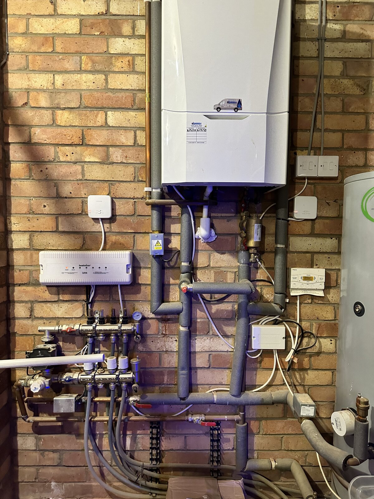

One sensible thing they did do was relocate everything to the garage so it's really easy to access and work on. Photo below in case it's useful.

If the replacement was just for the LP241 and associated thermostat that would be easy! Basically undo LP241 and replace by Wiser on same backplate plus some minor rewiring for the roomstat. And you are done
but it's more complicated unfortunately if you want the Wiser to look after HW + CH + UFH.

Based on what I can see in the picture you seem to have a pair of Salus receivers which presumably connect to a pair of wireless thermostats.
I'd recommend, with the boiler power off, to remove the wiring centre cover and map the various connections. You are fortunate everything is in one place. Hopefully you can follow the cables. More than likely you will have an "S-PLAN PLUS" arrangement which looks after 3 channels.
A good place to look is google "flameport s-plan". There are some excellent explanations of the wiring at that site.

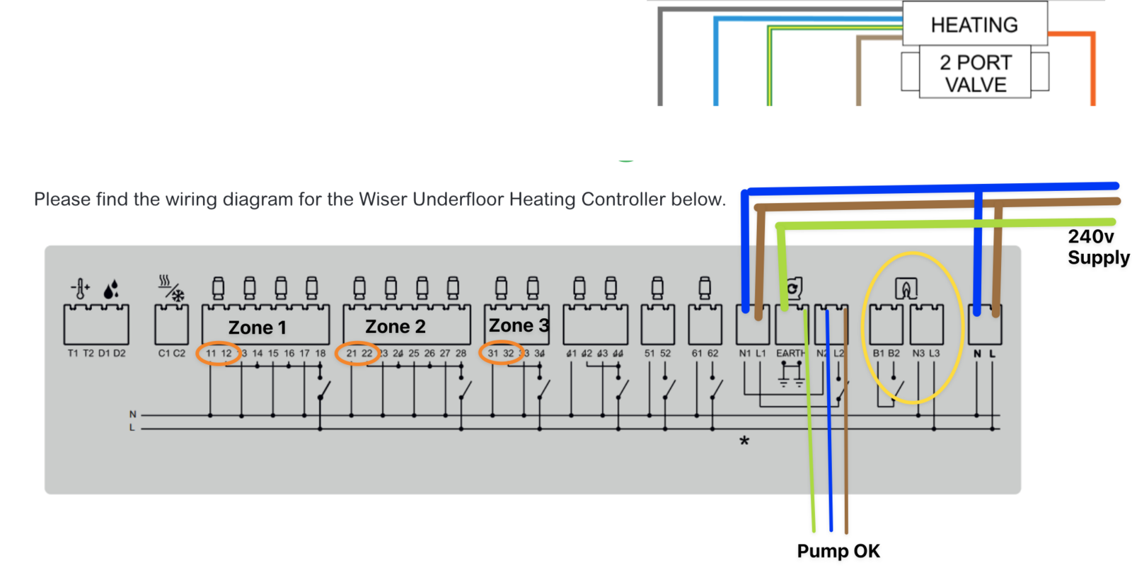

I've got power to the UFH, power and control to the pump and have the 3 x UFH zones correct correctly. Where I'm stuck is how to correctly connect the 2port valve that controls the UFH part of the system. I believe I need permanent live to grey, neutral to blue, earth to green / yellow but am unsure what to do with the brown and orange - i'm sure the solution is really simple but i'm suffering from brain freeze! Diagram below.
Do you have a separate pump for the UFH or is it shared with the HW & CH? If it's shared, that implies the boiler controls the pump. Excluding the smart side of the Wiser, in essence all its doing is applying 240V to the brown wire into the 2-port valve. The valve orange connection should not need to be changed. If however you have a discrete pump for the UFH then it probably needs to receive power the Wiser UFH controller.
With that said, I suspect the first thing would be to understand how the UFH switching worked prior to installing the WiserHub. Once you know the electrical connections hopefully replicating that in the new arrangement should become clearer.
