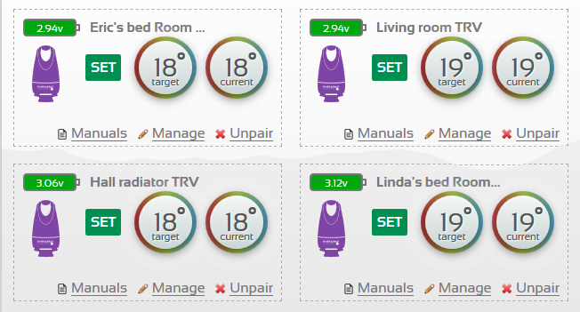

But if you take a TRV with a non electronic head then the point where it starts to open and when fully open have around 6ºC between the two points, with electronic heads this is reduced but still around 2ºC the whole idea is analogue control, they slowly open and close maintaining the set temperature. So with a modulating boiler the radiators get warmer or cooler not simply on/off.
The TRV at 12 midday every Saturday exercises, fully opening and fully closing then returning to setting, designed to stop them sticking, this takes around 6 minutes, if the lock shield valve is set correctly the TRV has enough time to adjust the flow without the radiator over heating while it is doing it, but if not set the radiator can get really hot before the valve can close, this causes the room to over shoot, so I use the TRV valve to assist setting the lock shield. Depending on make the valves show current and target temperatures.. TRV-report1.jpg1699766226398.png So if current exceeds target then close the lock shield a little, and very quickly you get it so the valve has the time required to adjust, once set I found rooms stayed at temperature set. However I had to cheat with the Energenie and set at 7 am to 22ºC then at 8 am to 20ºC as the built in anti-hysteresis was OTT, new home has a smaller boiler and the house is much bigger, and boiler is not a modulating type, so does not work as well with oil to as it did with gas.
