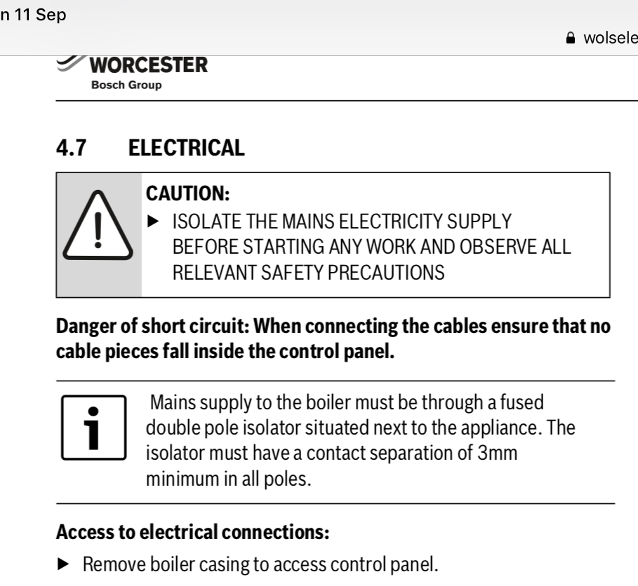

I found this thread on the Tado forum which shows a photo of where the hub would need to be wired to. I don't think that section is accessible without removing the cover, but I'll check the manual.
EDIT: Found the manual online and it seems to show on p.29 that the electrical control panel can be opened and accessed without having to remove the cover.
I would re-read it:
