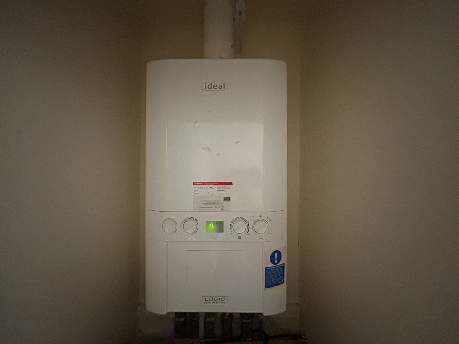

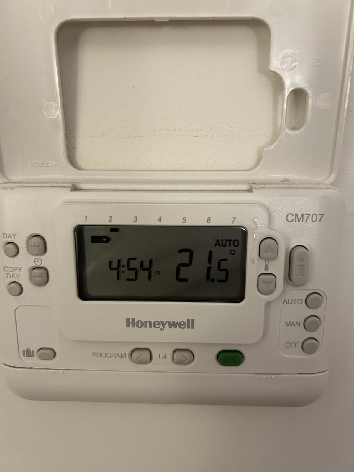

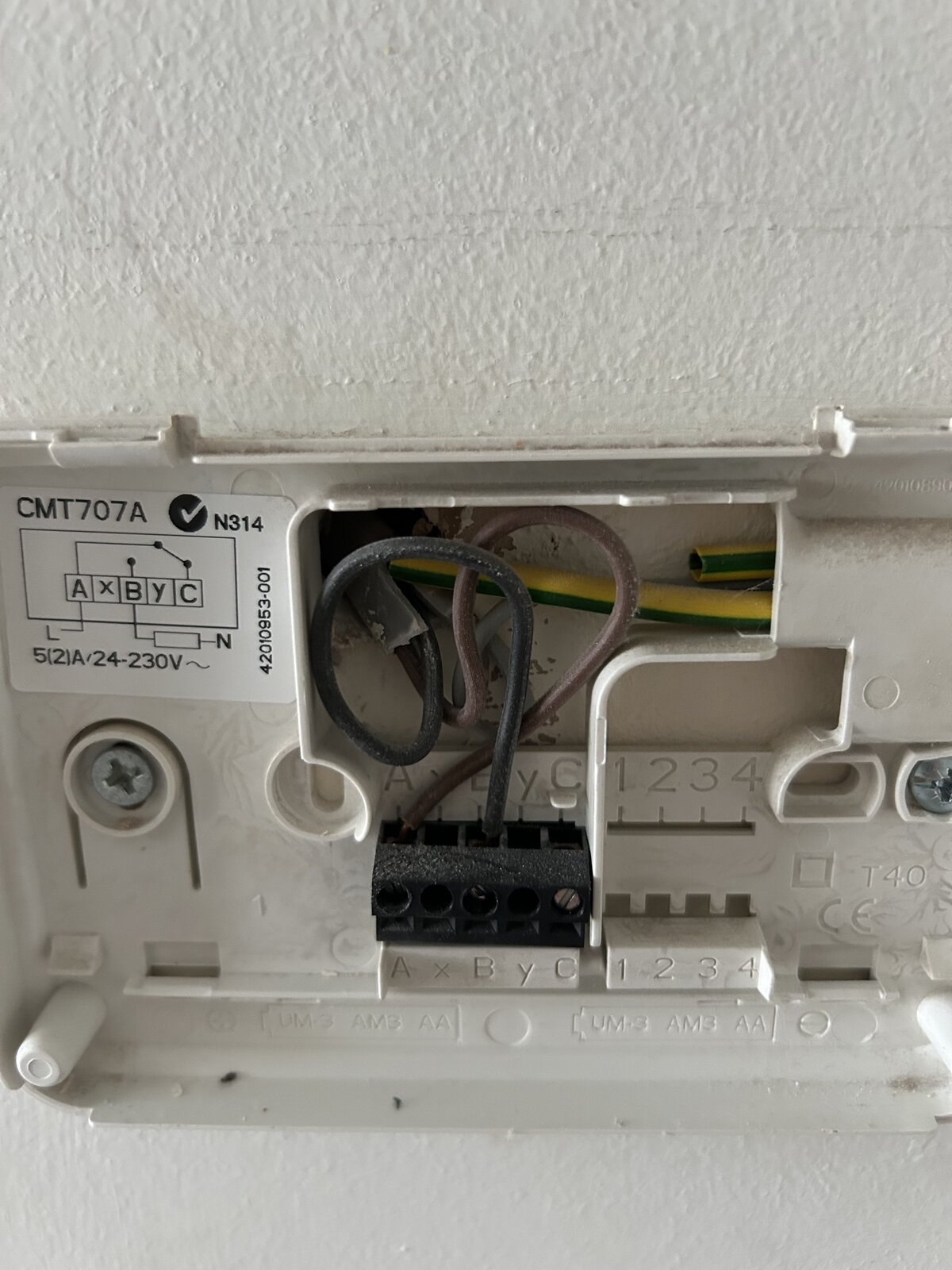

This is our current thermostat. We have two - one downstairs (controls downstairs) and one upstairs (for upstairs heating). We have a Logic Combi ES35 bolier

Your Honeywell stats are two wire, battery powered stats.
The Wiser receiver would be wired into your wiring centre, which may be a small box, located next to the boiler, or even as in a recent posting - under the bath!
Your original stats and their associated wiring would be decommissioned.
Find your wiring centre, and post a picture - we can help from there.

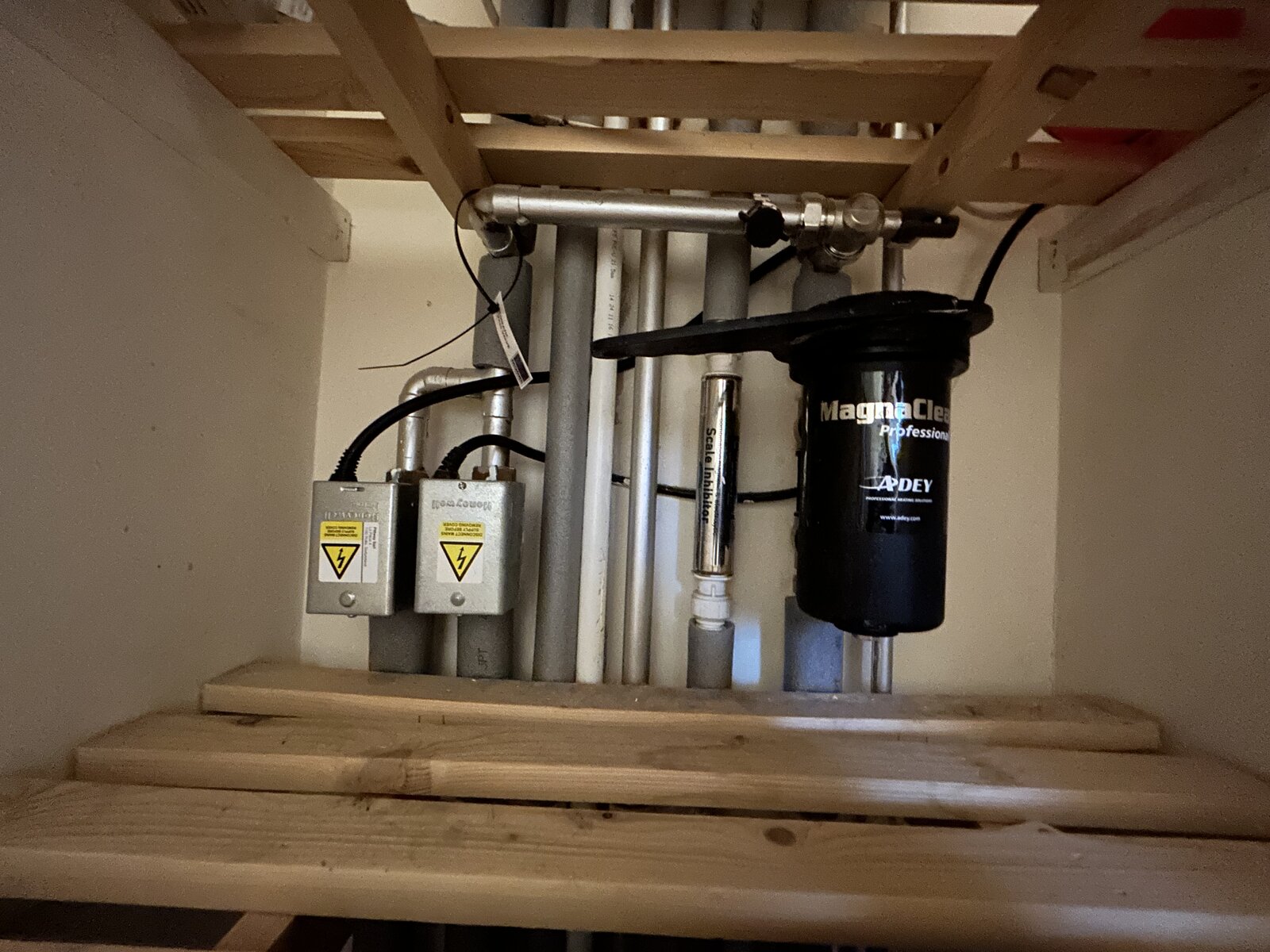

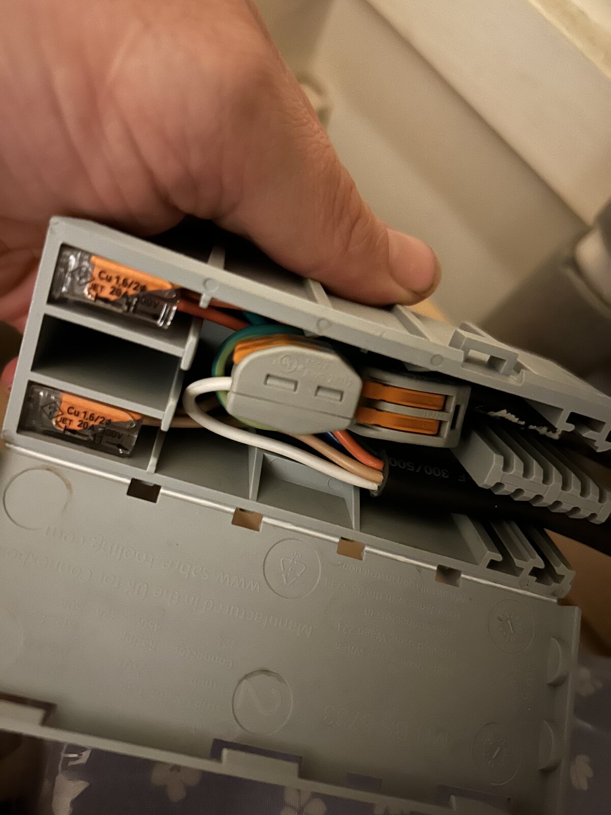

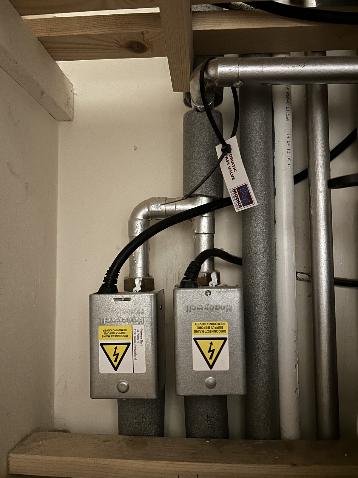

I have taken a picture of what was inside the box and a photo of what I believe are the zone valves (????).
Do both zone valve cables go into that box?
At least one does.
How many cables in total are there, entering the box? - if there are less than five (perhaps 3?) - there would be some extra connections made elsewhere.

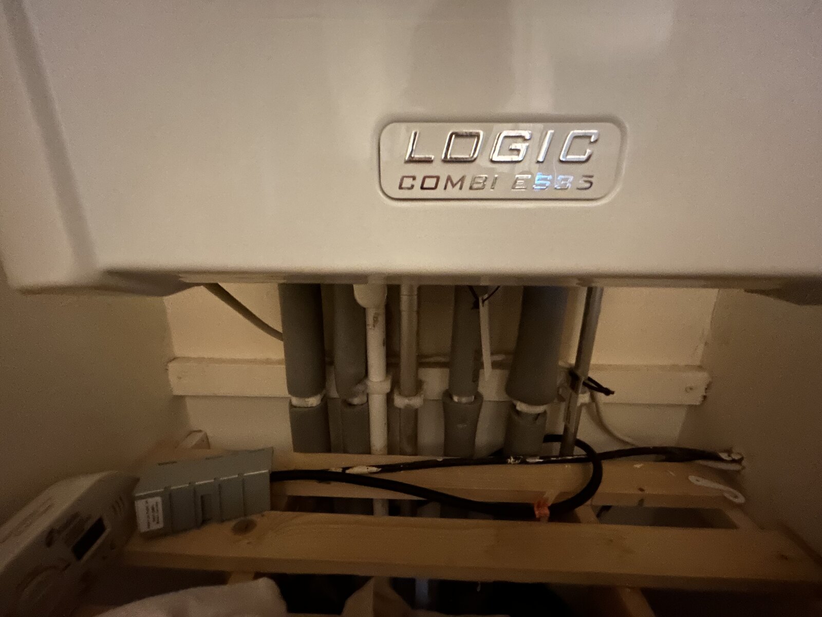

A wider picture showing the cables around the boiler, and how those relate to the box may be helpful.
  • Thanks
Reactions: CBW
Thank you for your help so far.
I have attached a photo which I hope shows the whole system. One of the black cables goes into the box, the other valve cable goes off into the wall.
I really do appreciate your help.

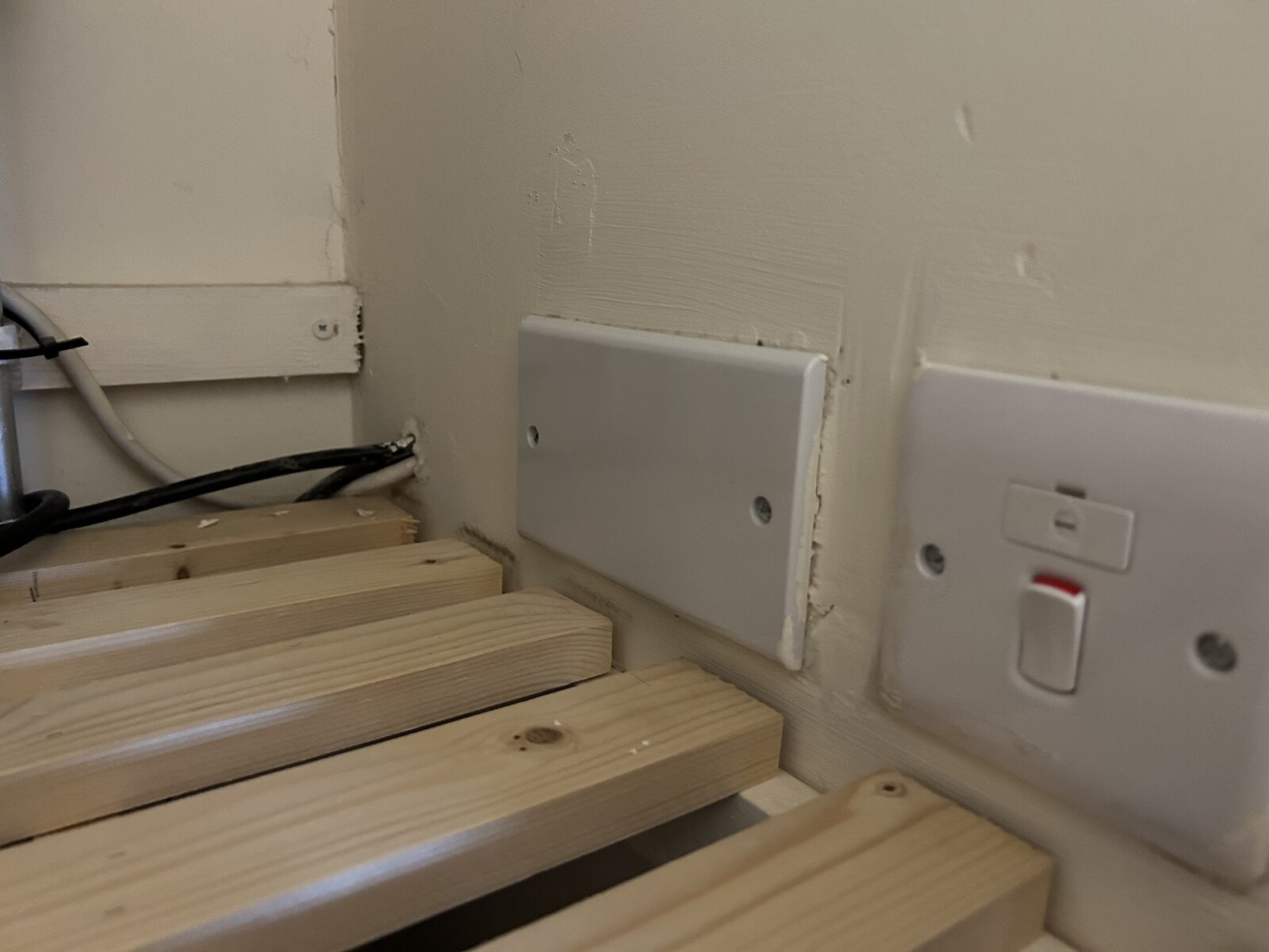

Ok, so the box simply acts as an extension to the zone valve cable.
Given the short length of the zone valve cable, and given the other cable goes directly into the wall...
What is on the other side of the wall?! :)
Is there a fused connection unit for the boiler?
Nothing - it is just a wall - The staircase that leads downstairs.
As above, given the length of the zone valve cable, there needs to be another connection within about 50cm of where the cable enters the wall.
It's possible that another box is used within the wall, but that would be rather short sighted.
You should also have a method of isolating the boiler - where is the boilers FCU located?

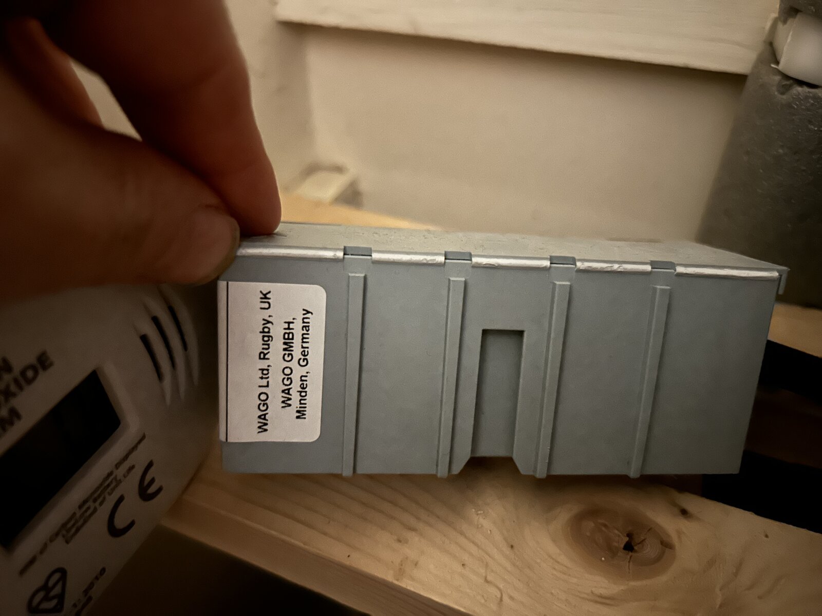

Check behind the double blank plate, but I’d also revisit the Wago box as I see x2 black cables
Zone valve cable in to Wago box - extension cable out to wall.
The original cable just wasn't quite long enough!
If you listen carefully, you can still hear the installers curses :)
