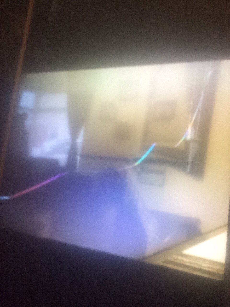

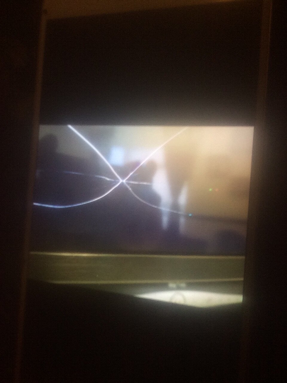

Sony 4K Ultra led tv, KD-55XF8796BU. It looks like the mid, bottom area of screen has had a knock maybe Or more like pressure than a knock at bottom of screen, as there’s zero damage on screen to 100% be certain.
The lines etc are all located bottom central, flowing to the right of screen.
What can be done regarding fixing it? Spec says “edge Led” so is the screen stuffed or led’s damaged, as I’m guessing because leds are located on the edge ?
It’s been removed from wall bracket while decorating, placed on sofa upright, then placed back on wall, where the problem was found.
As I said , no marks or damage is noticeable, so it’s a educated guess to why the fault has occurred.
The edge LEDs are the lights that illuminate the panel. It's unlikely they've gone faulty otherwise you'd have lost picture on most if not all of the screen. (No backlight = no visible image.)
It does sound from your description that the panel has flexed at some point whilst on the sofa. That's been enough to cause a stress fracture. I think the fact that these lines curve rather than are straight up/down does suggest that the LCD panel is goosed rather than just the adhesive holding the edge connectors in place.
Sorry to say, but a panel fault like this is terminal. Unless by some miracle you can find a donor TV where the panel is good but the T-CON or main board or PSU are goosed then it's time to call the insurers or go TV sshopping.The cost of a new panel will be almost as much as a whole TV.

Sorry I went around last night , there’s no picture at all. No menu. No channels , just a few curvy horizontal lines

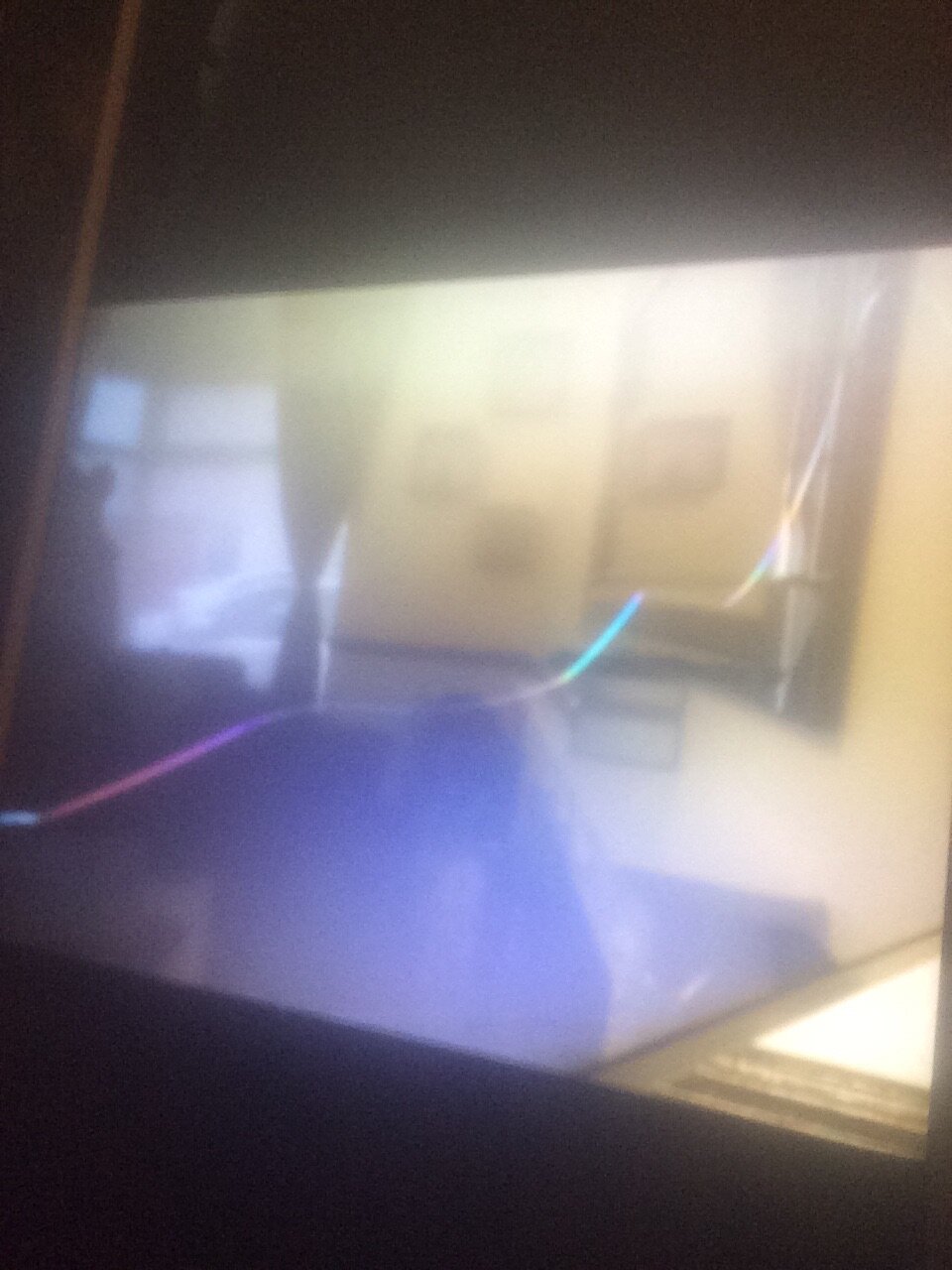

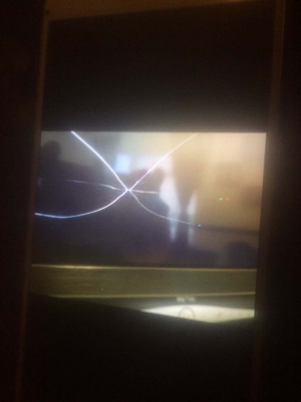

There’s no impact on screen . But that looks like it has doesn’t it
It does look like there was some pressure, especially the 'X marks the spot' picture.
@Lucid your ‘Spot On’ no doubt.
In the ‘Heat of the Moment ‘ I didn’t notice the ‘Bullet Hole’ scene

We could waste a load of time beating around the bush; you asking if you try this or try that, and me offering encouraging platitudes but in the full knowledge that it's pointless.
The TV screen has physical cracks in it. It's f.... frightfully broken.
