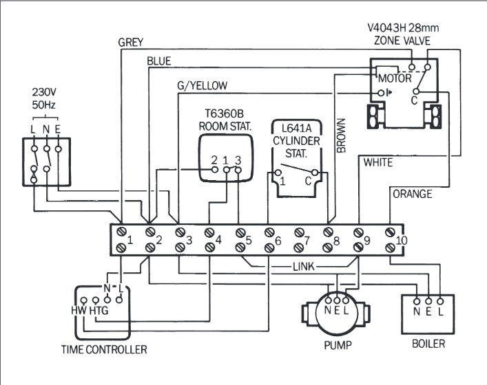

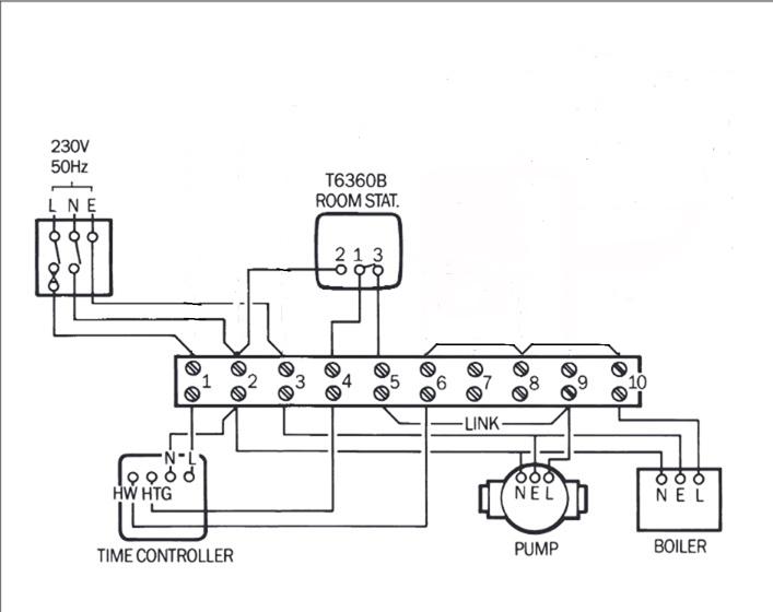

The C Plan had two upgrades, original C-Plan_old2.jpg then a thermostat for summer use C-Plan_old.jpg and finally a motorised valve, C-Plan.jpg⁣but mine is still the original. As we moved to Y Plan and S Plan we saw the DHW having its own controls, but years ago, the central heating was used with the open fire, rather than instead of it, and my parent would just use it in the morning while lighting their open fire.
The idea is when the heating turns off, it can get rid of the heat in the boiler by heating the DHW, you can get
mixing valves to reduce the DHW temperature at the taps, but 60°C is far too hot to wash your hands under the hot tap, and 60°C is required to stop legionaries, so the storage tank needs to be over 60°C, all the tank thermostat does is reduce losses from the DHW tank.
