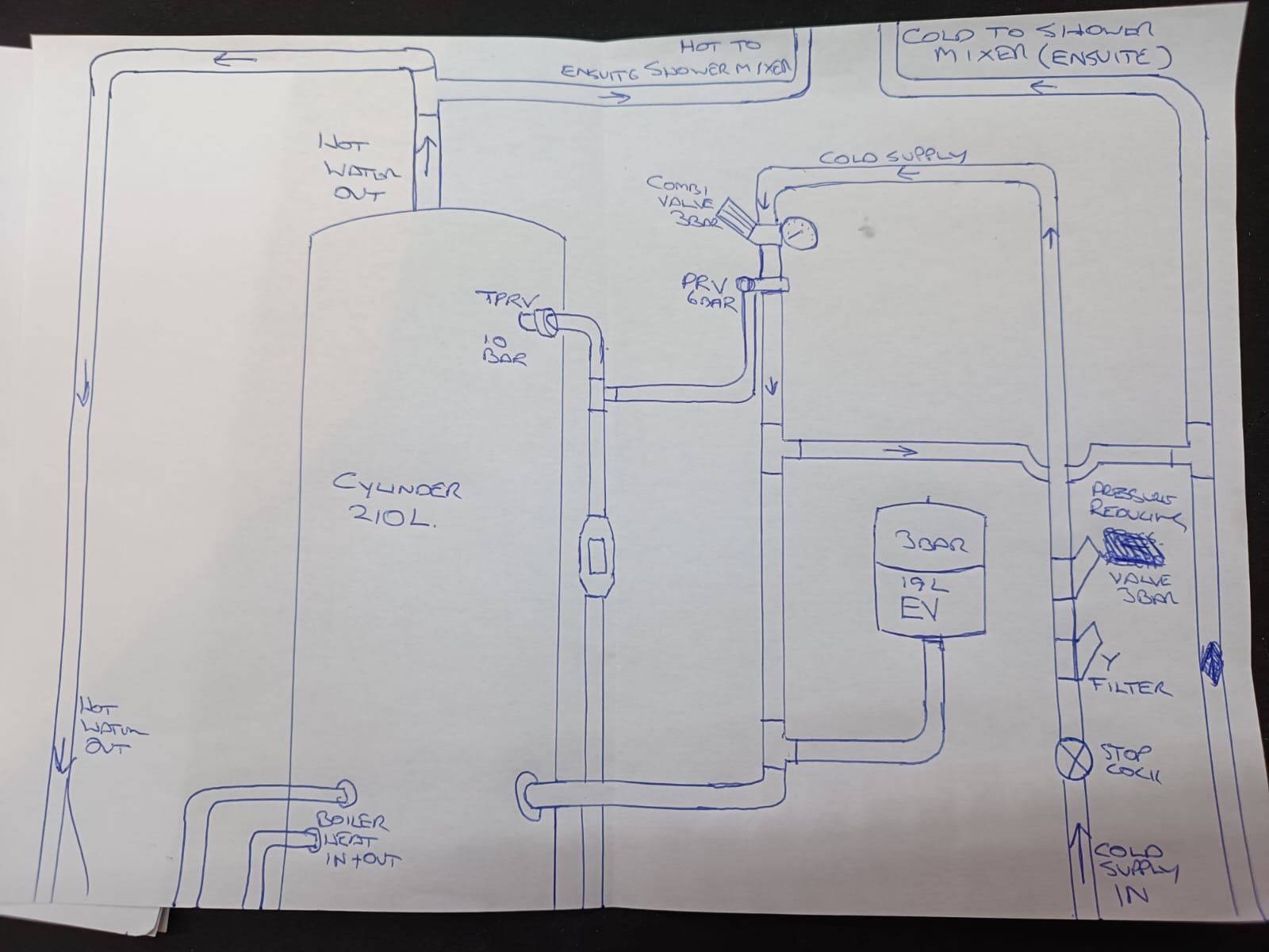

OK. I have attached a diagram of the cylinder and pipework in the airing cupboard. The connections are correct, but I have tidied up the routing of the pipework solely to make the diagram clearer. The expansion vessel for instance is a lot higher up than shown here. I hope this provides some clarity as to how my system is connected up.
Our Ensuite shower is directly behind the wall where the cylinder is. That is why the shower hot and cold is exposed here. The hot feed to the shower is taken off the main hot supply out. The cold feed to the showers comes off a tee in the cold water mains supply after the Combo valve and PRV as shown. I presume this cold feed is also supplying the cold water to my other bathroom (shower, sink and bath), and cloakroom toilet (sink)??
Disappointingly, I checked the tundish at about 8am just after the boiler had been on for an hour to heat the water, and the leak through the tundish was as bad as ever. Does anything look out of place on the diagram?
Also for info. I have a bathroom, Ensuite and cloakroom toilet as well as the kitchen sink. Thats 4 sinks, 2 showers and 1 bath. All of these have mixer taps on them. Thanks.

Another thing that might be worth adding. When I turn off the stopcock to the cylinder as per the above diagram, it turns off the cold water supply to the two showers as well as the hot water. I hadn't picked up on this previously.
However, the cold water supply to the 4 sinks and the bath remains at full pressure. I can only turn the cold water supply off to these by turning off the mains stopcock located under the kitchen sink.
I presume that should mean that only the shower mixers x 2 are supplied by the balanced cold feed tee from the cold water inlet beside the cylinder, whilst the bath and sinks cold supply is separated and fed directly from the cold mains coming into the house.
This being the case, would it not then true that the hot water to the 4 sinks and bath mixers is supplied at 3 bar from the cylinder, but the cold supply to the sinks and bath will be at whatever pressure is coming into the house from the mains and certainly way above 3 bar?
Could that be causing some back pressure on the heating side forcing hot water back from the cylinder back up the cold feed pipe and out through the 6 bar PRV given its hot water being expelled from the PRV even though the PRV is on the cold feed in? I have felt the cold pipe from the cylinder back up to the 6 bar PRV at the combination valve warm when the leaks are happening.

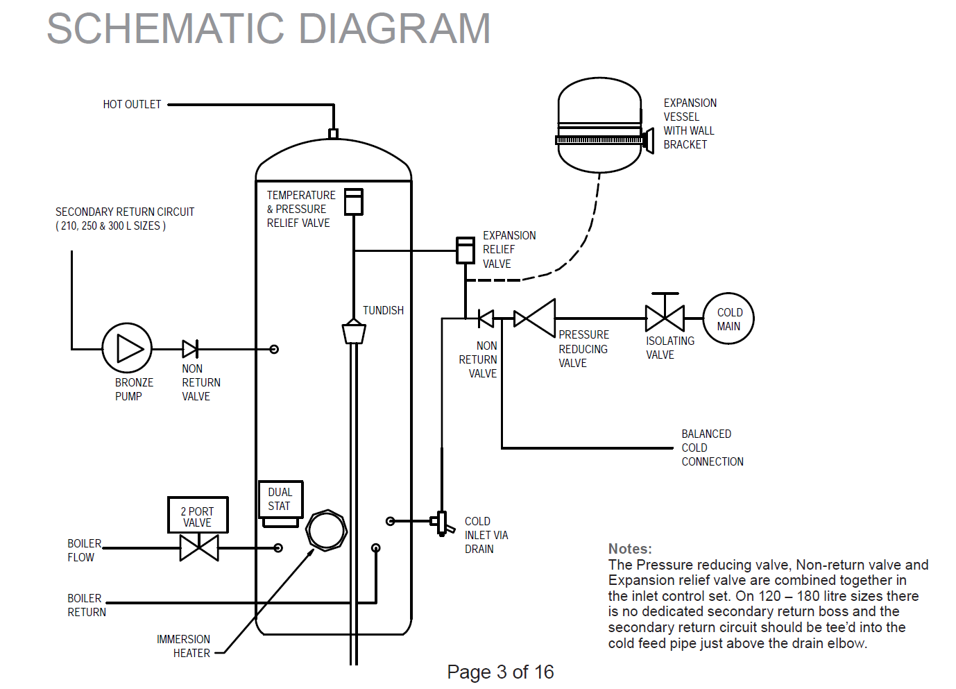

Yes, probably some combination of the above, the "balanced" cold, if, as per your schematic is teed off downstream of the combination valve NRV which is incorrect as it will operate at the cylinder pressure, it should be installed upstream of the NRV (in the combination vale) so will run at the PRV set pressure and won't be influenced by any expansion or whatever.
Sorry John, you have lost me a bit there. The balanced cold is indeed teed off downstream of the combo valve and pressure release valve. Would this not be correct as effectively the cold supply to the shower and the hot supply are both pressurised to the same pressure as the cylinder?
Are you saying the balanced cold feed should be off a tee in the cold mains in before it reaches the Combo valve and PRV? How would this contribute to the leaking from the tundish when the boiler heating is applied to heat the water.
The combination valve is called this because it combines a PRV, a NRV and a expansion relief valve.
The balanced cold connection should be taken off exactly as shown (schematically) here, ie, after the PRV but before the NRV, this ensures that the actual expansion has no effect on the balanced cold connection which runs at the pressure setting of the PRV. The expansion relief valve is on the other (downstream) side of the NRV so that in the event of the EV failing this will lift at 6bar.
Admittedly, once a few litres of HW are drawn down then the balanced pressure (even when incorrectly installed as above) will operate perfectly normal so I don't really see why this should cause the expansion valve to lift.
What is the make/model of the new PRV that you installed?, if this is not "Drop tight" then it can pass enough to increase EV charging pressure and cause it to lift on reheat. For example if 4.74L passed into the EV before reheat then this will result in a EV pressure of 4.33bar and cause the expansion relief valve to rise to 6.0bar when expansion of the 3.4L takes place.
