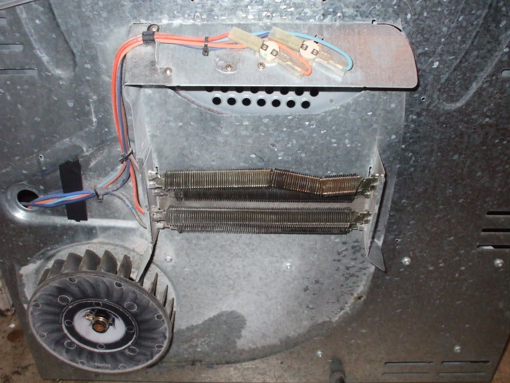

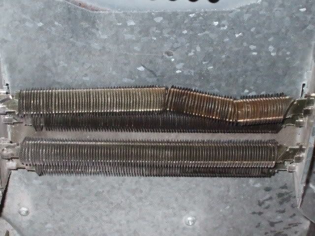

Hi, i wondered if you could help me. My tumble dryer rotates but does not dry the clothes anymore, it just blows cold air. All the lights come on and all the filters are clear So i have taken the back of it of and come across the following, (i have added pictures so you can see what im seeing)
And close up
I take it that is why it wont heat up. My next question, what is it? Is that the heating element? If so, could anyone tell me the part number so i can look it up and possibly order and new one. Many thanks in advance.
