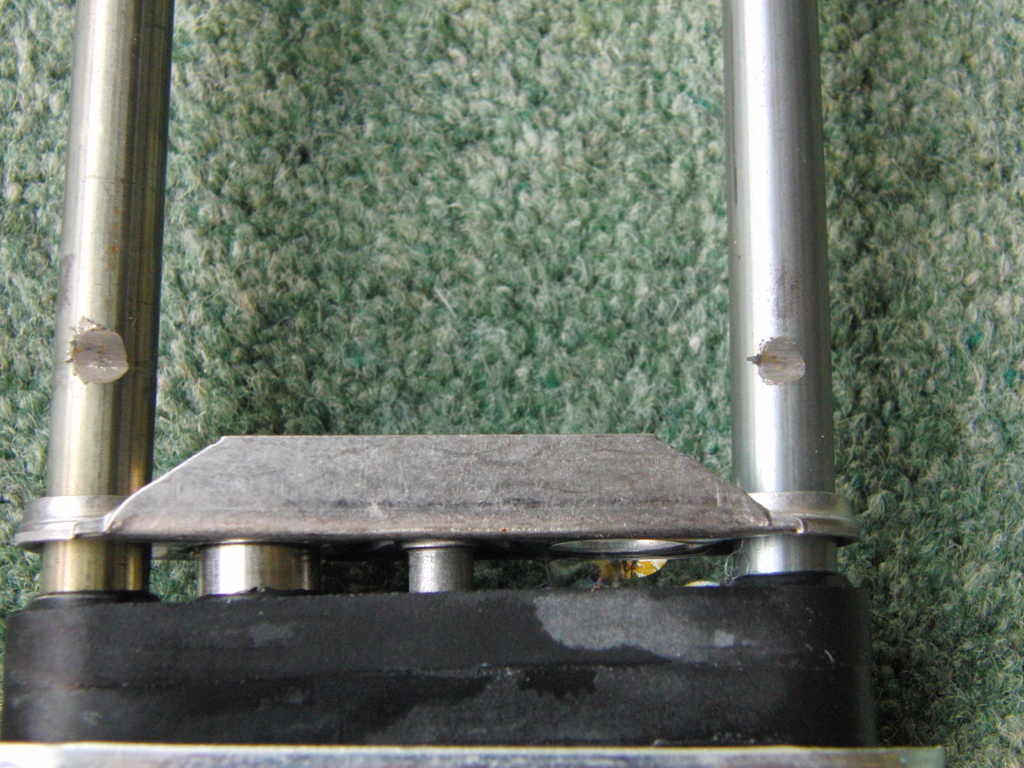

Removed new element and noticed two notches on it, grabbed the original out of the bin and sure enough it had the same and I hadn't noticed it before - doh!

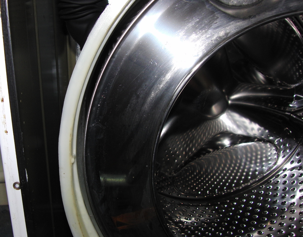

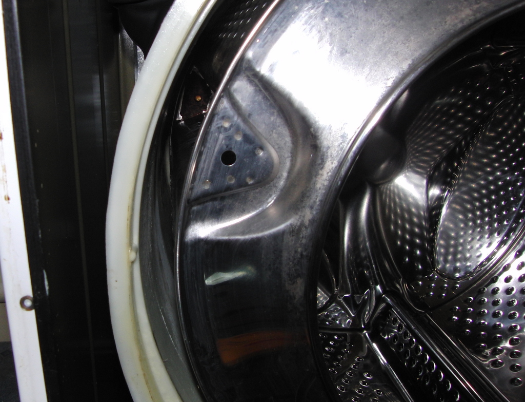

Checked in the element slot while turning the drum and the outer rim of the drum is catching the heater once per revolution.
edit: just measured and its out of true by 24mm
Looking through where the heater goes to the back of the drum, it appears there to be running true, only the front is way out of shape.
