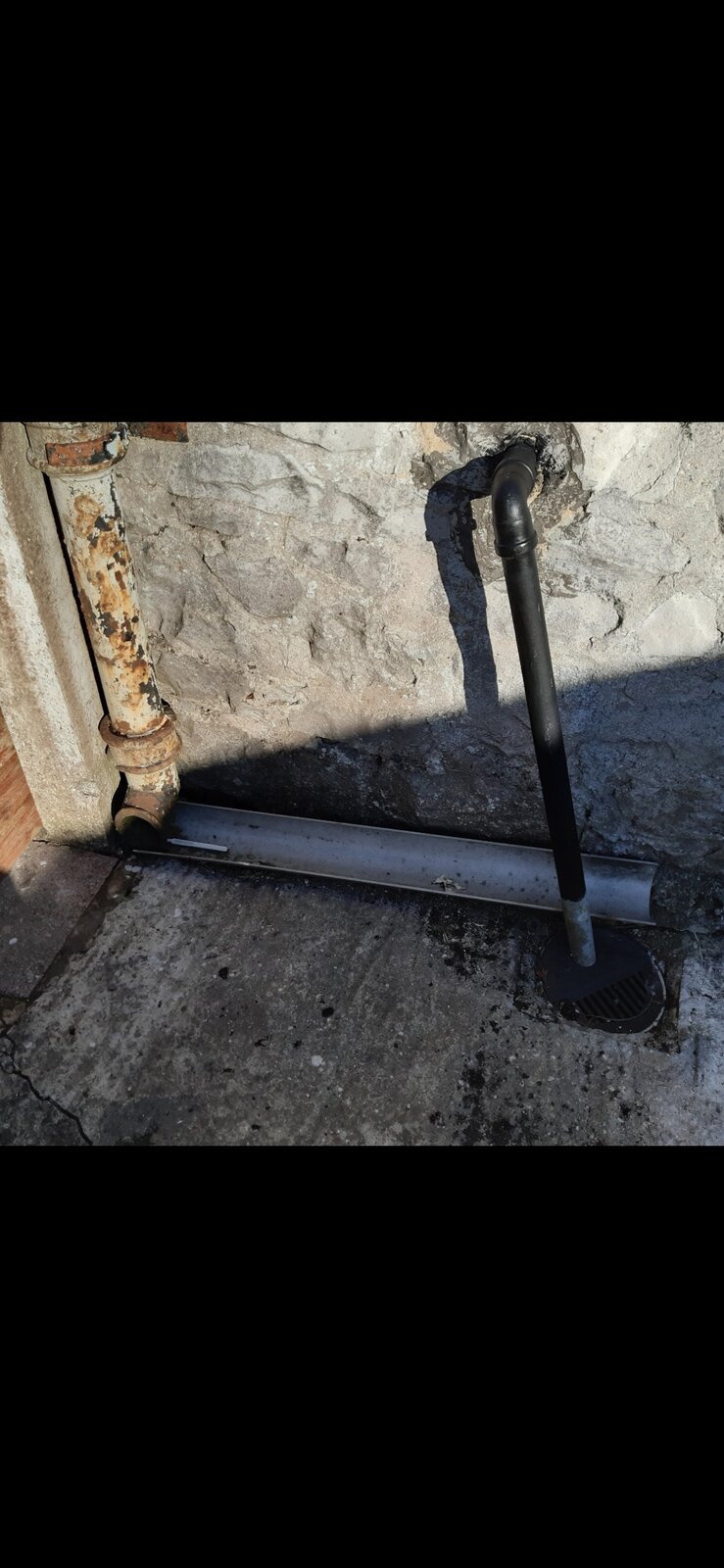

Gully, I suspect, was a later addition, being plastic, and was installed to take the waste pipe. Should be connected to the foul drainage system, going to the Septic Tank, waste water shouldn't go to a soakaway without treatment of some description.presumably that grid is already going to a soakaway I guess then?
Ahh ok so I am still ok to connect that to the grid then?
It's the only downpipe for the 4 houses if that makes any difference
