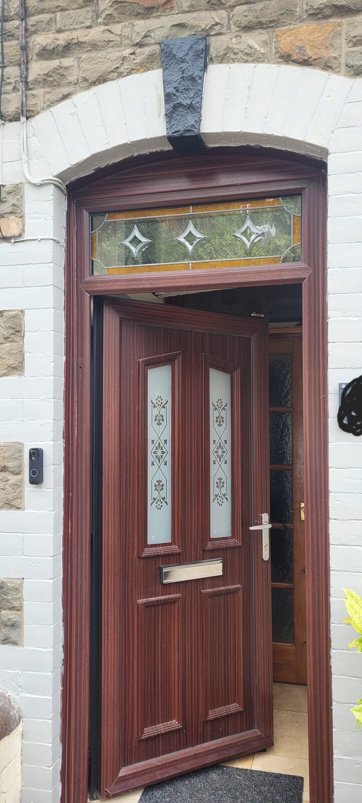

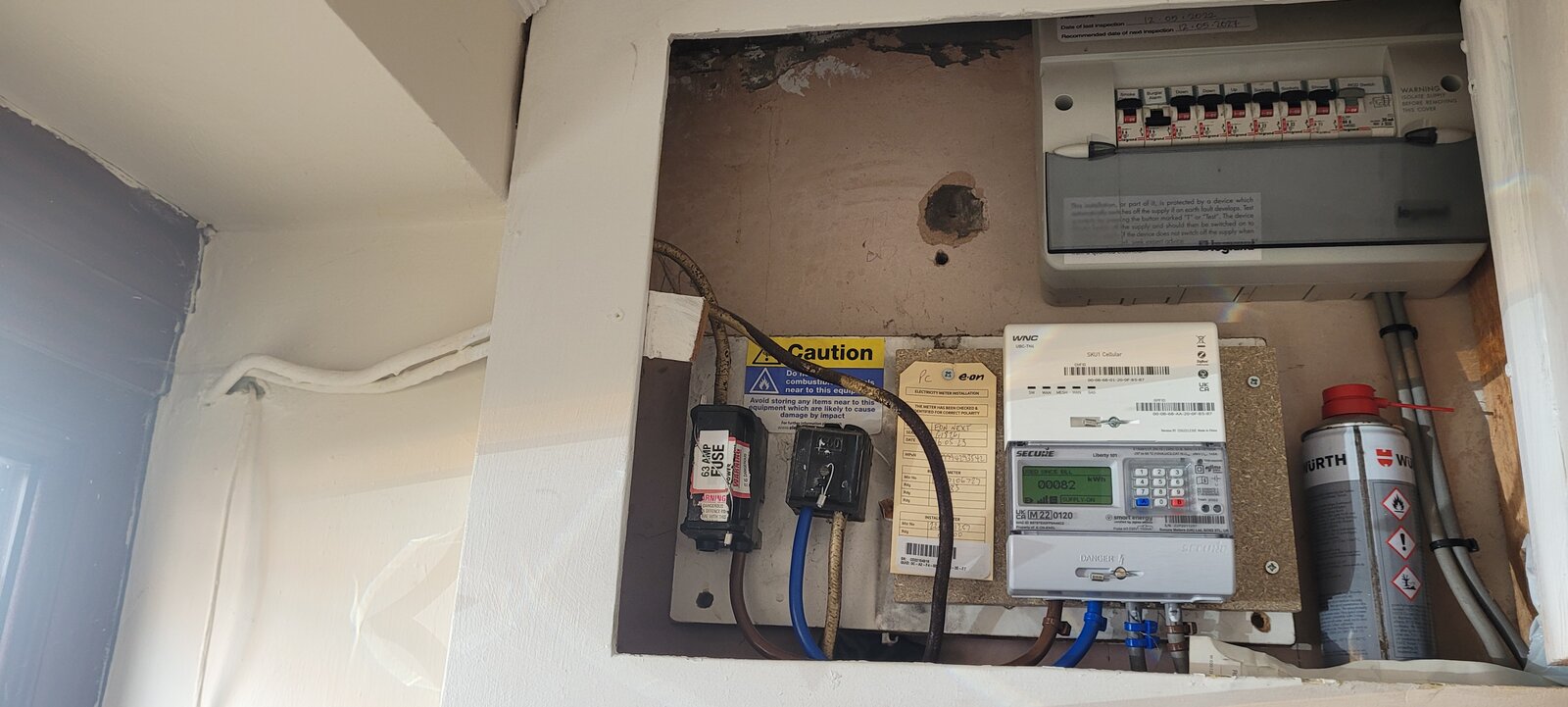

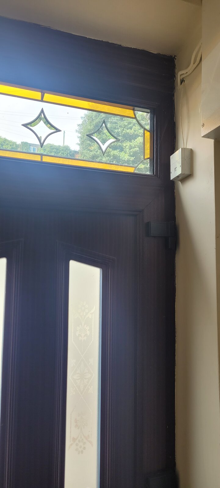

We are looking to install some mains powered outdoor up/down lights on either side of our front door. How big of a job is it? And is there any advice on how to route the cabling for this?
Is it an easy DIY job?
How much should a ball park cost be for a qualified electrician to install?
To do a "Good" job of Mains Powered external lights on your site will not be "easy".
The existing wiring shows that making it look "neat" will not be easy either!
You have been quoted £160 for installation (presumably, without the cost of the lamps themselves).
For this amount, I would expect that you would get the most basic of installations - and
you would almost certainly need to apply paint etc., to minimize its effect !

Thanks for this useful post! It has made us rethink and consider the solar option, which I can then obviously install myself. However, those lights linked to Amazon are far too traditional, so will be looking for some more modern looking photocell solar lights instead.
