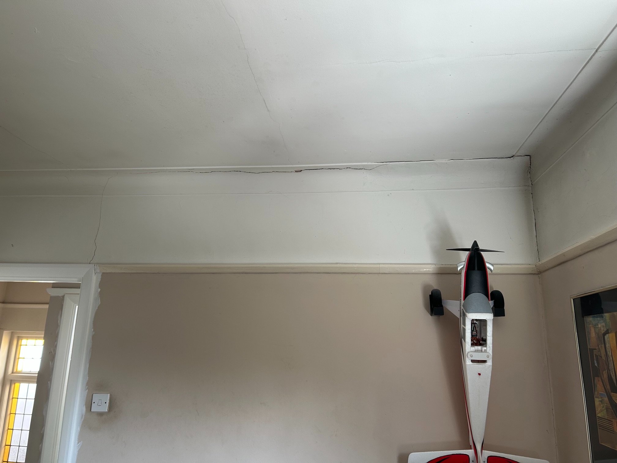

Hi All,
Here is a pic of our son's bedroom wall and ceiling. It has terrible cracks on the coving and wall. What's the easiest solution to remedy without taking the coving down and putting new up?
Cheers
Daz
Fill with toupret powder filler and sand.
Would be better to replace coving.
Is that the corner of your house?
Rake out the cracks fully. Squirt in low expanding foam. When cured, cut back foam and then fill, sand. Repeat and decorate accordingly
