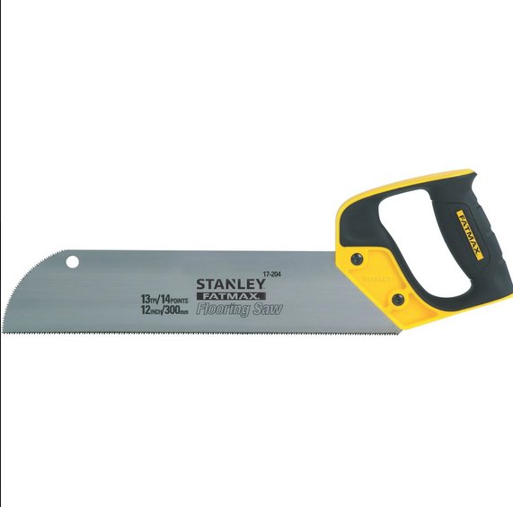

It looks like it has been lifted before. I am assuming it is the short piece you want to lift. If it is tongue and groove the tongue will have been plit when it was lifted previously. Looking at the first picture it does look like a tongue is still there. I would get a large sctrewdriver and using a block on the adjacent board try to pry it up. As whoever laid it previously has split the board where the nails go in it will probably split even more. You can buy a floorboard saw from Homebase or B&Q, this is the one I have from Homebase.
It has teeth on the rounded edge to cut the tongue. Once you have made a start cutthen you can use the ordinary side to finish the cut. Be careful though "tradesmen" hide wires and pipes under floorboards.
