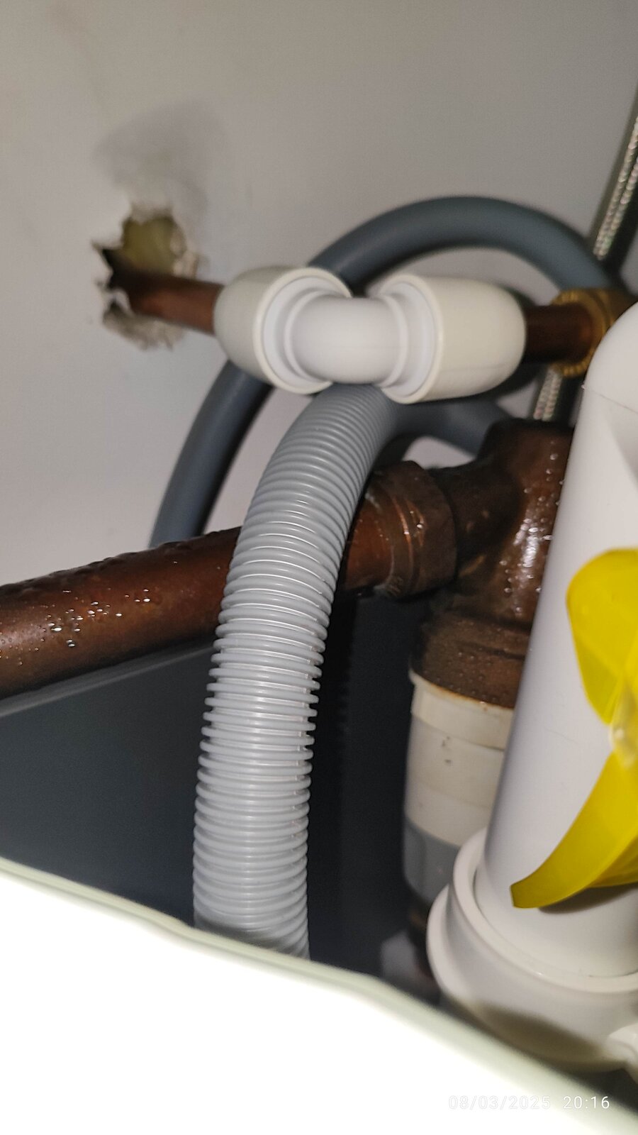

How do I take this off?
16 Dec 2010
77
2
London
Hi,
I have a leak on the push fit elbow joint under my sink for my outside tap. Any ideas how to take it off? Is it east to replace with a push fit for. Screwfix!?
Sid
Yep, likely a hep2o as above, which will need the demounting tool. Easy enough to replace with another push-fit, but needs to be similar size, otherwise it’ll either be strained or you’ll need extra pipe.

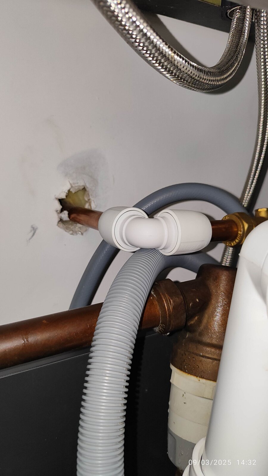

Thanks all for your help. Its seems easy enough to take off with the right tool. ive seen a set on Amazon!
Thanks for your support and help, really appreciated. Manged to take the old one off with the tool from Screwfix and replaced it with a new one, No more leaks !
