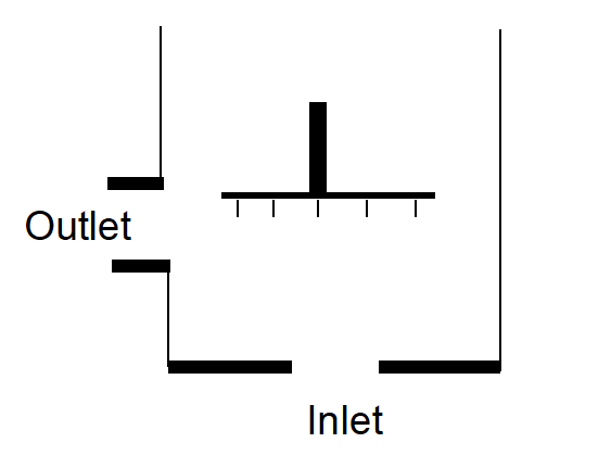

How do submersible pumps work?
.... Also the flow rate is astounding, enough to create a gash in the lawn directly from the end of the unrestricted 1" hose, much more than mains water pressure from a 1/2" hose.
Indeed. That's why I find it so intuitively difficult to understand how it manages to achieve that when the outlet is only a couple of inches away from a 1" diameter hole into a 'low pressure' environment!
Kind Regards, John
The impeller vanes will be very close to the plate containing the inlet hole, probably within 1mm.
If you can imagine, for a moment, that there is no gap and the impeller vanes are in perfect contact with the plate. In fact there is sometimes an additional plate added to the impeller.
As the impeller spins any water within the vanes is thrown outwards by centrifugal force and if there is somewhere for it to go - it will. The outlet in its crudest form is a hole in the side of the impeller void. Some air fans are built this way and the impeller may simply be against a division between 2 sections of air duct.
The outlet is usually angled and frequently has a scoop fashioned to reduce drag on the water flow, the curve on the vanes is more for directing the water towards the outlet than for sucking on the inlet.
The impeller vanes will be very close to the plate containing the inlet hole, probably within 1mm. If you can imagine, for a moment, that there is no gap and the impeller vanes are in perfect contact with the plate. In fact there is sometimes an additional plate added to the impeller.
If that were the case, then I'd find it much easier to understand. However, the impeller vanes are actually about 50 mm above the plate containing the 'input hole' - in fact, close to the top of the output port

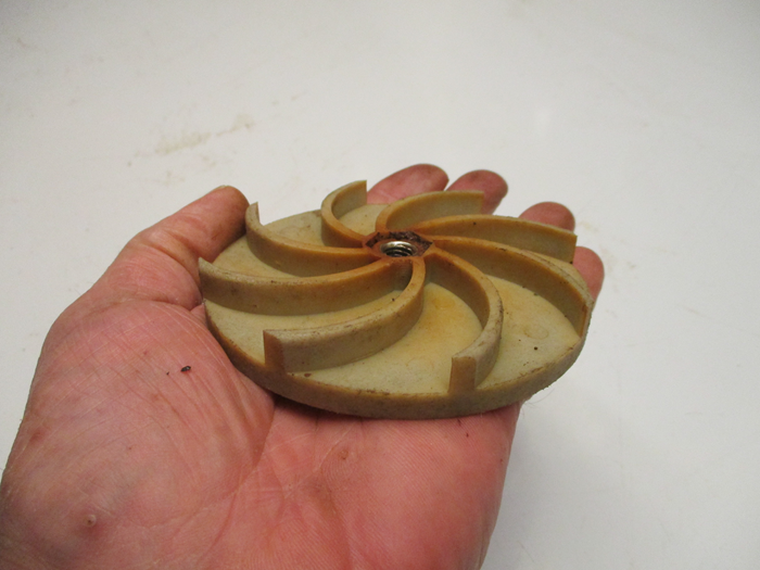

.... something like ....
Kind Regards, John
... and 'the vanes' of the impeller are amazingly small for something which produces such an enormous and 'powerful' gush of water ...
