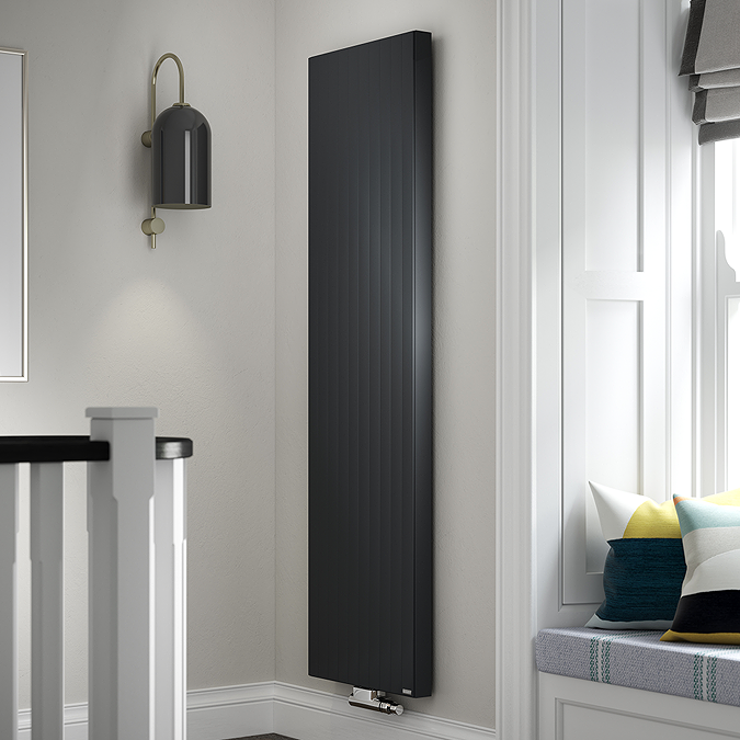

My experience is I have removed more designer tubular column rads from properties and replaced them with contemporary vertical rads, than I have fitted them, quite simply because in use they just don't heat the space efficiently. They aren't very effective at convection which mean their primary heat output is radiant. That can work well in smaller spaces with lower ceilings and when in closer proximity to the rad but in larger spaces with high ceilings and more open plan, they can struggle unless upsized or several used.
Ultimately though and as always, it is your call.

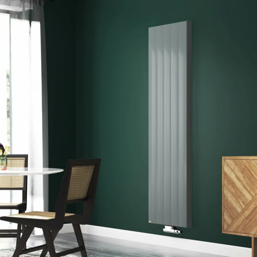

What are classing as a contemporary vertical rad ?
Stelrad's Vertical flat and lined panel K2's, come in a range of colours for one, they're offering them as Henrad's too.
My clients love them and are much happier with their performance.
