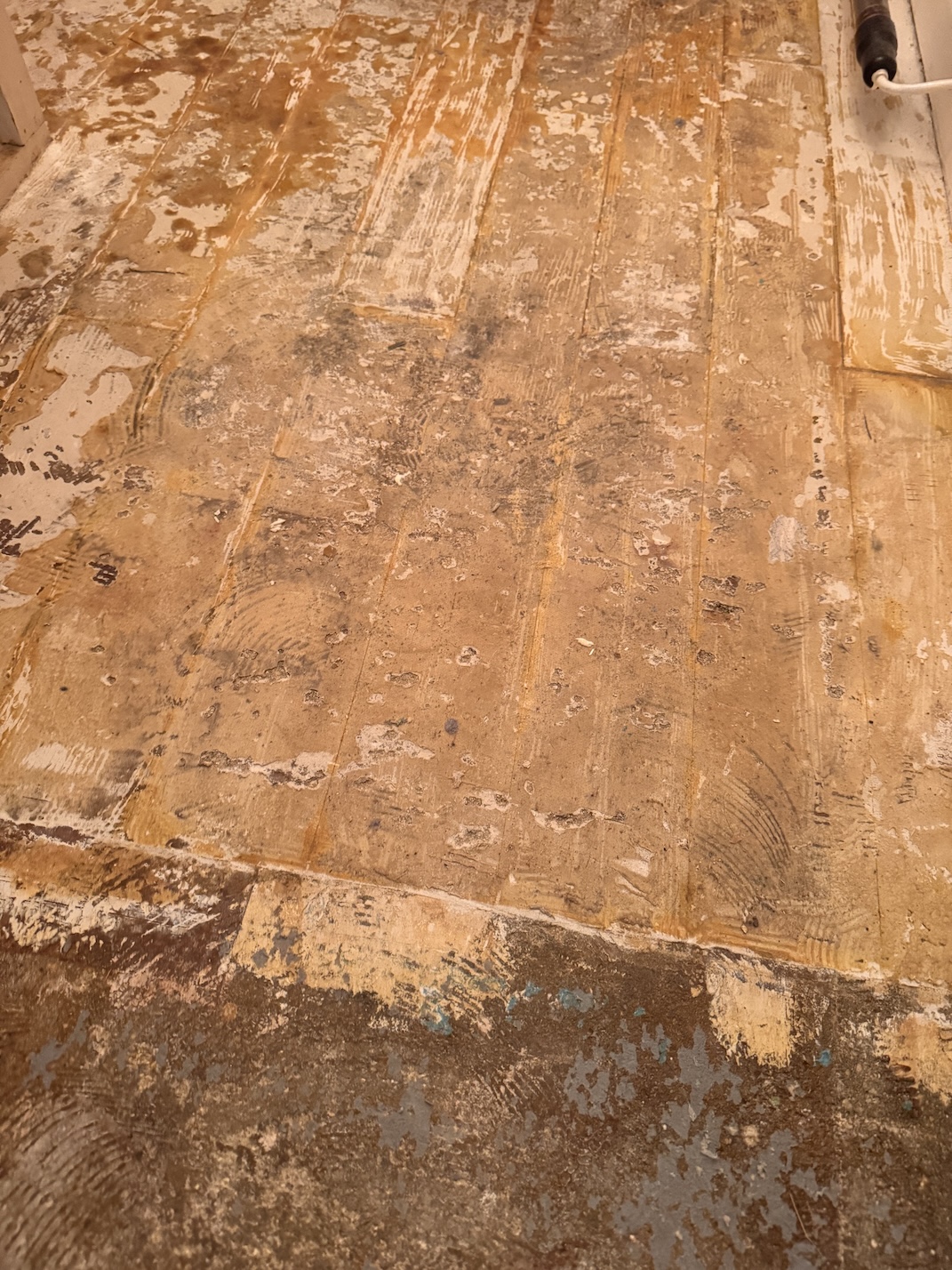

Thanks, wasn't planning on buying one as the in-laws have something like that - but will save me a trip to collect :)
As for the floor, looks straight concrete to me but with some adhesive residue from the carpet (and prob tiles before); and the skirting is all in place currently, but could pull some off if needed.
Here's the floor:

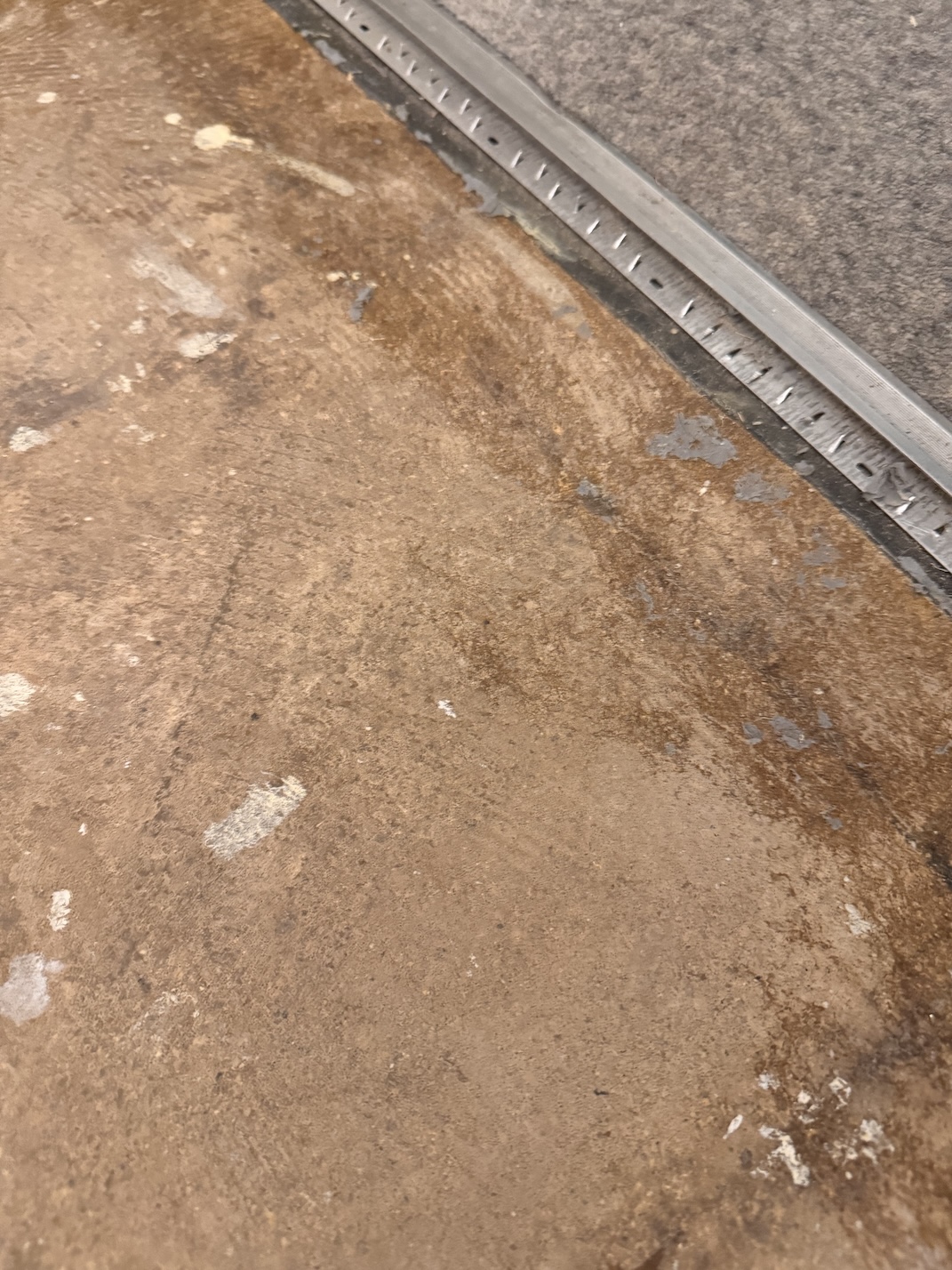

A couple of other things I noticed, firstly on the adjoining room it looks like there are some black vinyl(?) tiles under the carpet:

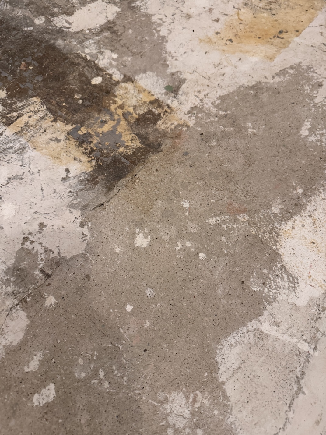

Also, the WC off the hallway seemed to have some glue LVT installed (must be a fair age, as nothing else has been touched in the house for a while from the looks of it) that I've pulled up and was all attached with nothing loose:
Does any of that help?

Defo needs a coat of ardex na or Mapei na or fball 1200 pro.
Are you doing glue down LVT ?
Thanks - yes, planning on glue LVT and was going to Ardex NA it as have used that before (just a small room) in a previous house.
