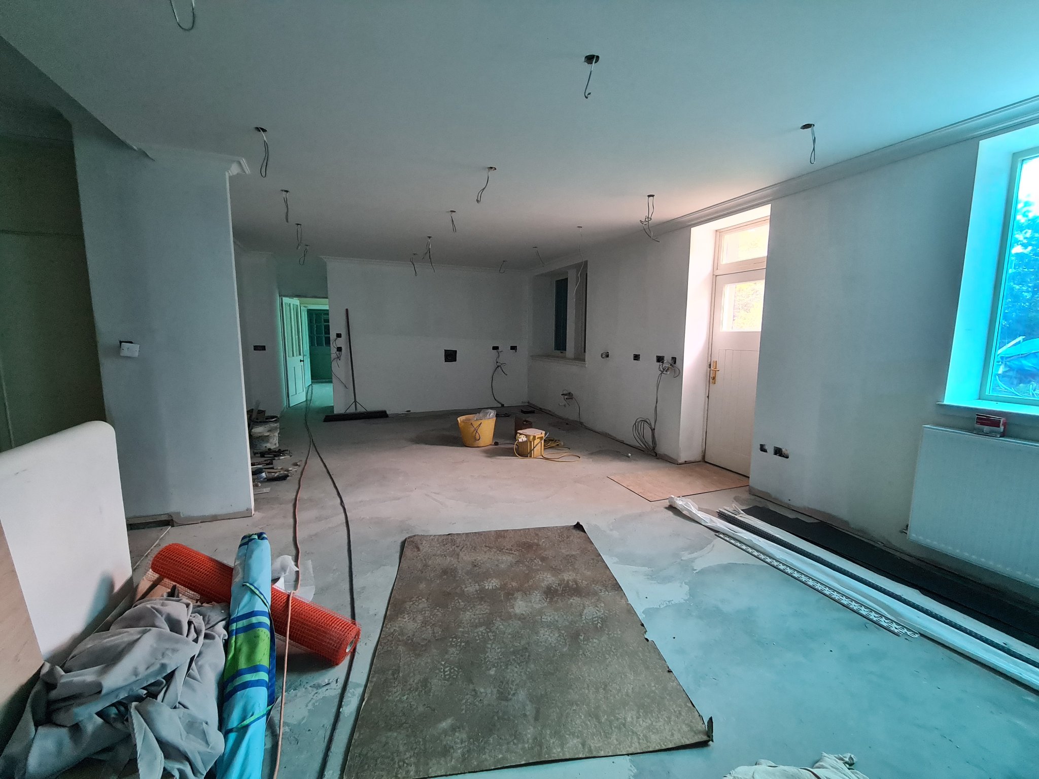

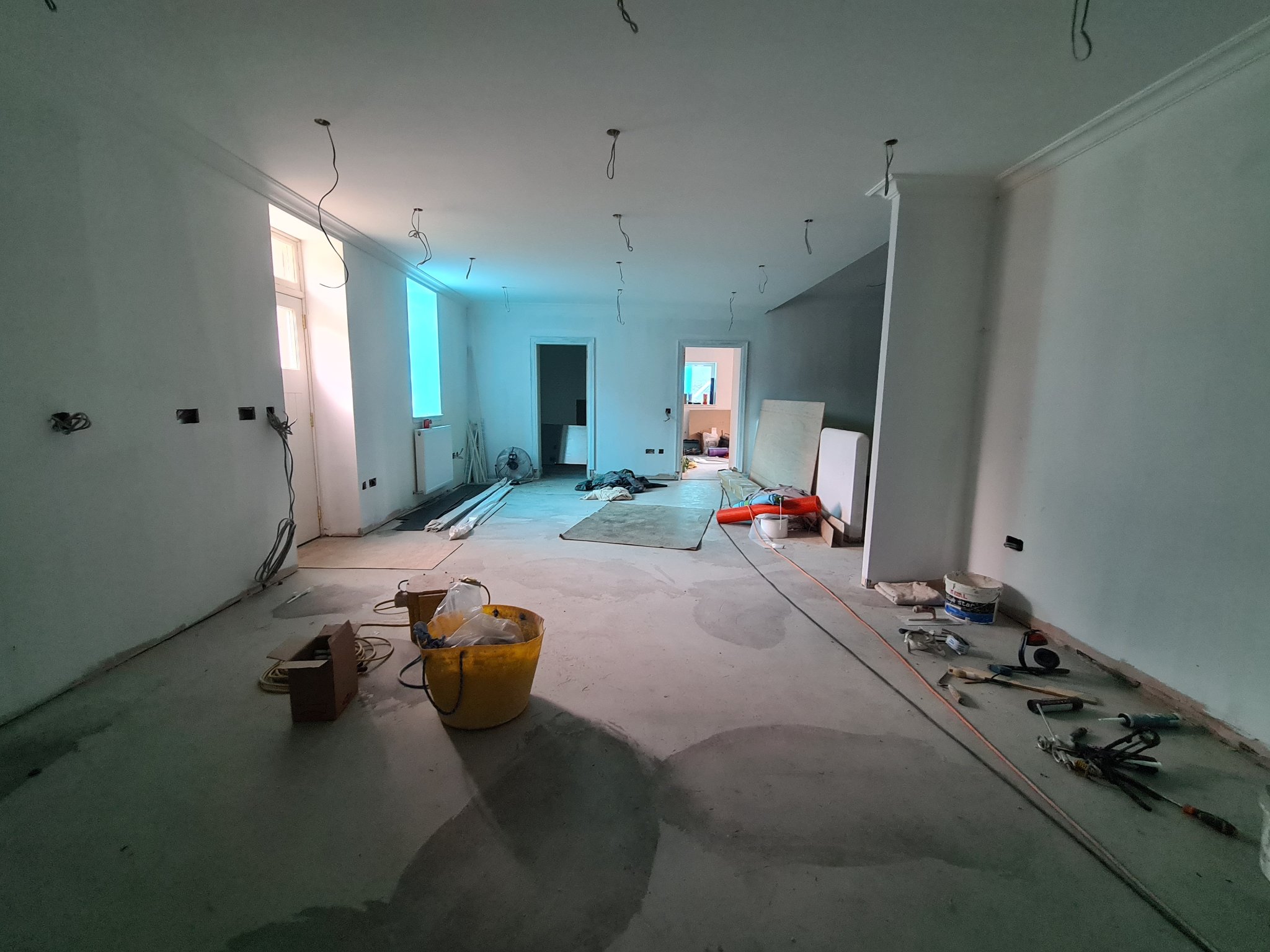

Part of our house is 1950s blockwork without DPC or proper DPM in the kitchen area.
After a botched job to put in a liquid DPM (so we can have laminate) this is what we've been left with from top down:
5. Top layer of Ardex NA. This layer has cracked in places (10 days after works were complete) - 2m cracks in some areas - localised mainly near edges (I suspect mainly over the areas where the sand cement bossing was filled badly).
4. Ardex liquid DPM - not enough was used (should have used 2x10kg tins for whole space and didn't) and judging from the box meter readings taken after (75-90%) this has failed. Meters were left for 72 hours - albeit the house isn't heated atm - but the room gets lots of air. Protimeter readings done by Ardex rep were 250-400. There are no burst pipes under the floor.
3. Layer of Ardex NA
2. Thinnish layer of sand cement (very, very brittle). Had large bossed areas which were filled in with something as yet unknown.
1. No idea of base - presume stones/gravel, not sure if there is a concrete slab, suspect not.
Question is
A) do we make them dig up and start again doing DPM properly, knowing that they could cause even more issues with the base sand cement layer below or B) risk it with a vapour barrier underlay taped over whole floor (like "quickstep basic") and put laminate on top? Or will this mean we get awful mould/damp walls....?
Can't put more DPM over top as current level is getting too high. And can't dig down to do proper meshed insulated floor as sheeting and joinery already done in the room, so wouldn't be able to get to external walls for DPC rendering it pointless.
Main query: Have you put down floating floors on concrete without DPCs before? Any problems? Or worries when doing it? Most grateful for any advice! Thank you ...from a very stressed contributor

How bad are these 'cracks' ?
Hi crazydaze - the cracks are very localised at either end of the room - about 2m long but only at points - I'm not so concerned about the cracks as they are obviously where they failed to fill the subfloor bossed parts properly so there's a little movement but it's under where the units are going on the whole. The cracks are not throughout or in the middle of the room. I'm more concerned about whether we have to re-do the DPM - thus causing more damage to the subfloor taking it up (which again will need repairing) or whether a good underlay will do. Has anyone ever just used underlay on a floor without DPM or DPC with success?
Wondering whether it's possible to take up just the top layer of the ardex sandwich and add more DPM C1 and then top layer Ardex NA again? Anyone ever done this?
They were put across the whole floor - no units in yet

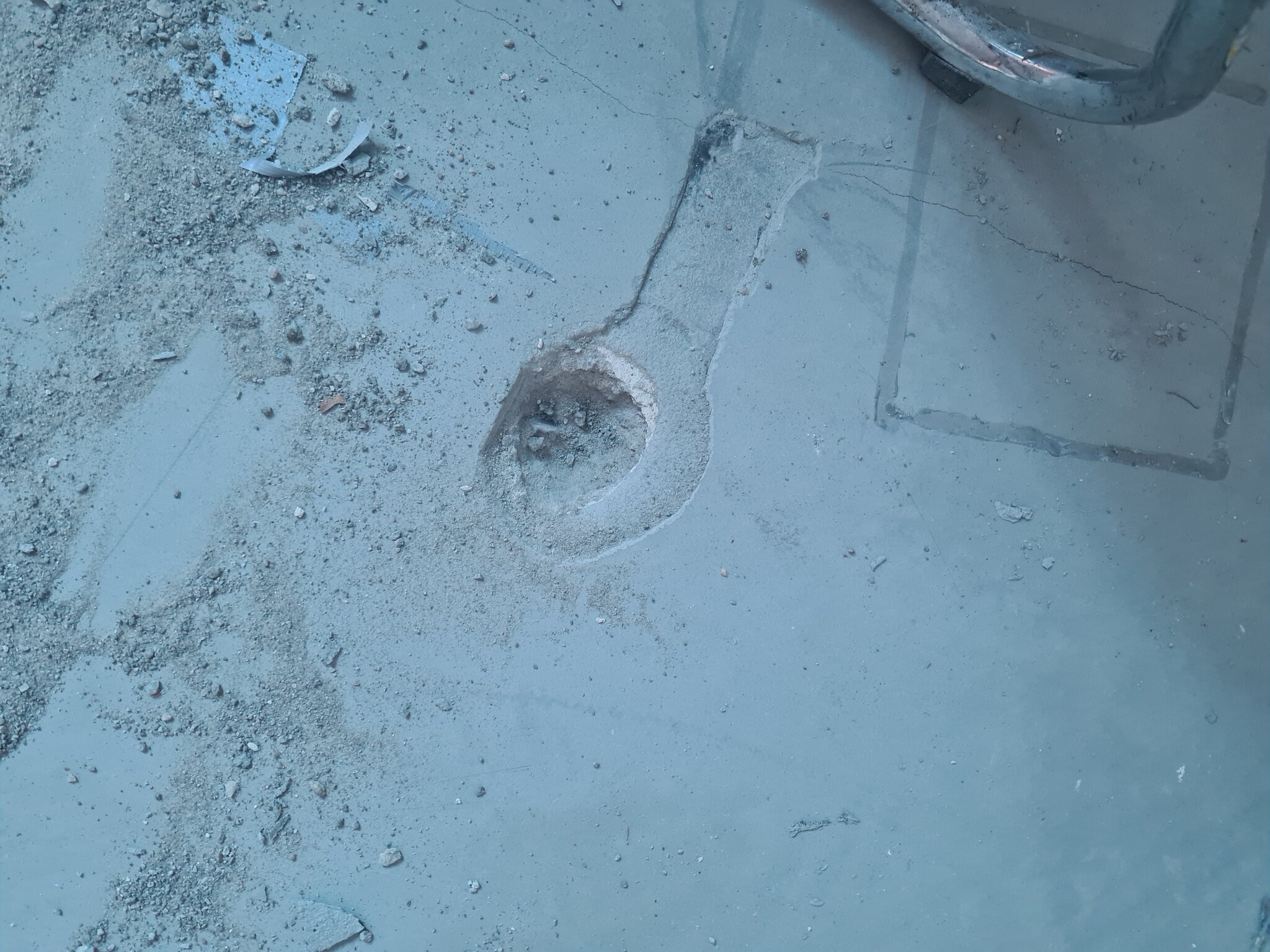

The hairline cracks arent too much to worry about, but that screed blowing out like that would suggest very high moisture levels?
as in the sand cement? ....basically the plan now is to take it all up and somehow(???) stabilise the sand cement below and start again.....any advice so welcome for doing this as the guys really don't have a clue what they're doing and I can't seem to find anyone in the area who does...
RH was between 80-90. The Ardex rep took protimeter readings which were 250-400 (not sure what value; different from RH)
The protimeter is just to get an initial reading of where to drill the holes or place a hydrometer box.
How many m2 is the job ?
Yeah, 2 x 10kg would be what was needed to put it down at the right microns. We tend to paint it on the bricks as well.
If just laminate I’d prob fill in the holes and put 3 coats of ardex MVS / fball F78 moisture suppressant
Or if money is ok go F77 all over. 14kg.
Or use a good vapour underlay
