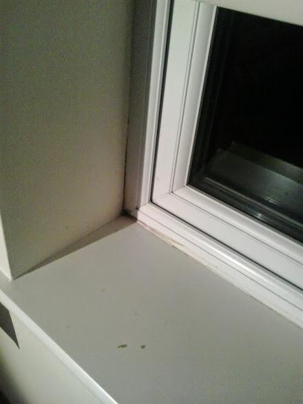

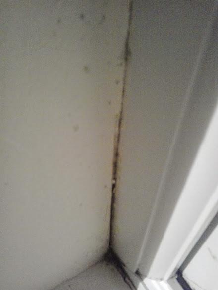

My bedroom window has a small crack around the bottom where the UPVC meets the plaster windowsill.
It is letting in a slight draught. There is also some mould coming.
How can I fix this? I am a total DIY newbie. Do I just put down some silicone sealant along the crack? Or does the plaster have to be redone?
Scrape out the loose stuff and run a bead of sealant along you would do better to use an Acrylic paintable sealant rather than silicone as when redecorating you will have trouble with painting the silicone, it's like trying to paint a non stick pan!
If you are new to it use a good quality masking tape smooth with a wet finger (use water with the tiniest drip of washing up liquid in it ) then remove the tape and if you feel brave do a final very light smooth with a wet finger cleaning off any sealant on your finger and dipping it in the water before each stroke.
When it looks 90% right leave it at that 'cos you will only mess it up if you keep fiddling with it! :wink:
