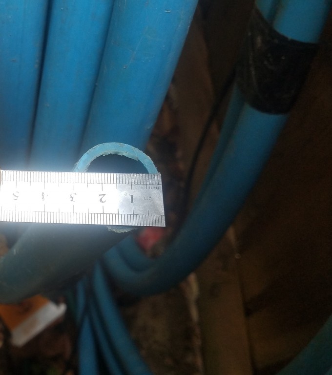

I been given a good length of blue pipe, pictured below, could someone please identify if this is MDPE mains water pipe that I need. What size is this cable?

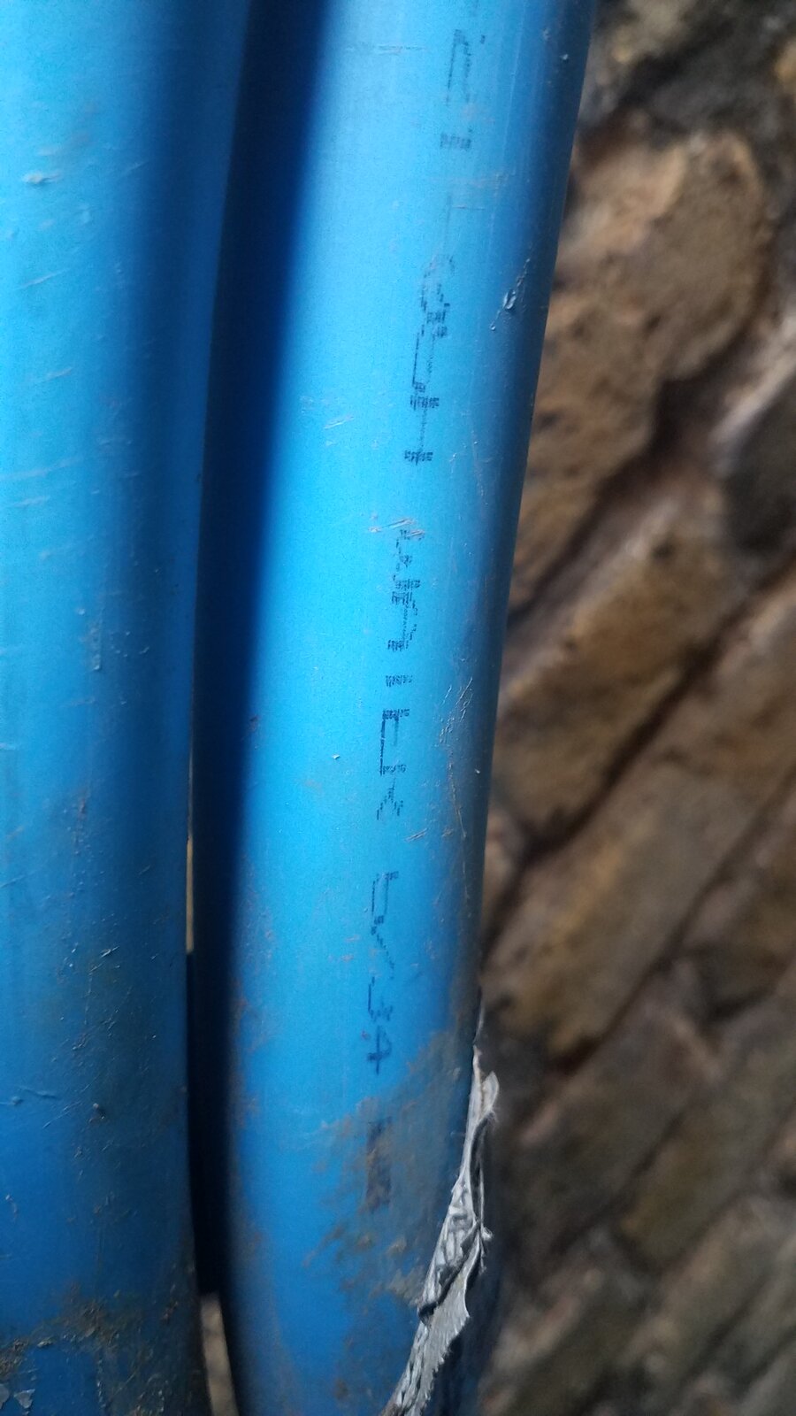

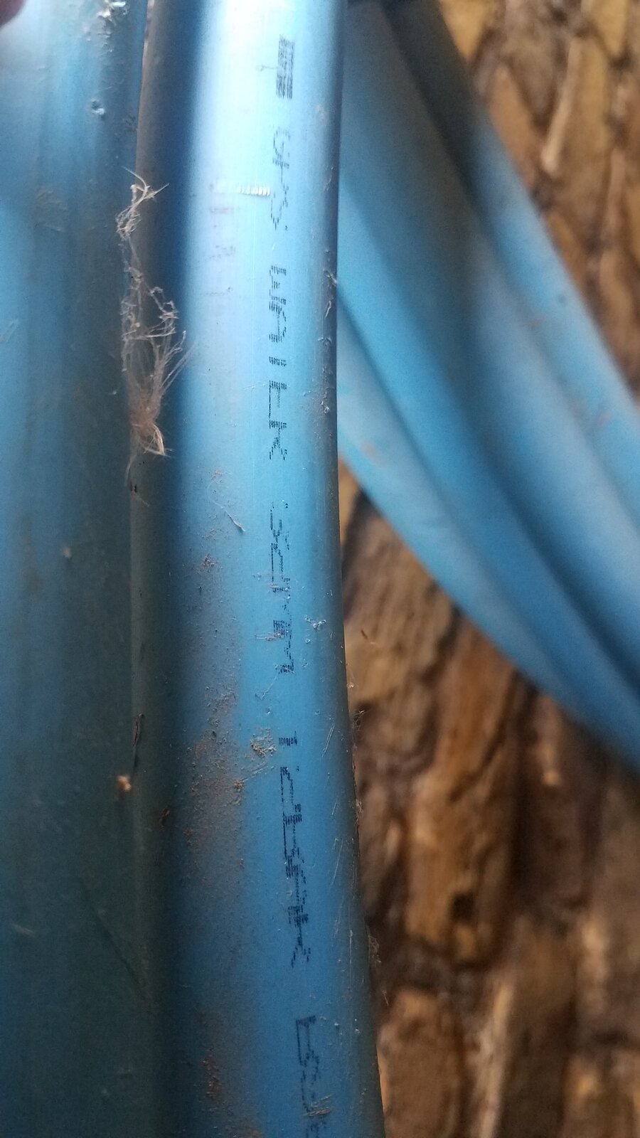

Your blue pipe is 32mm MDPE I think, does it not have any markings on the side?

I can just about make out 32mm in the 1st picture! Please see pics
Btw is it ok to fit a coupler underground between two lengths of the pipe, as the pipe I have isn't quite long enough?
Can't see why a joint is problem, I'd also use pipe inserts.
