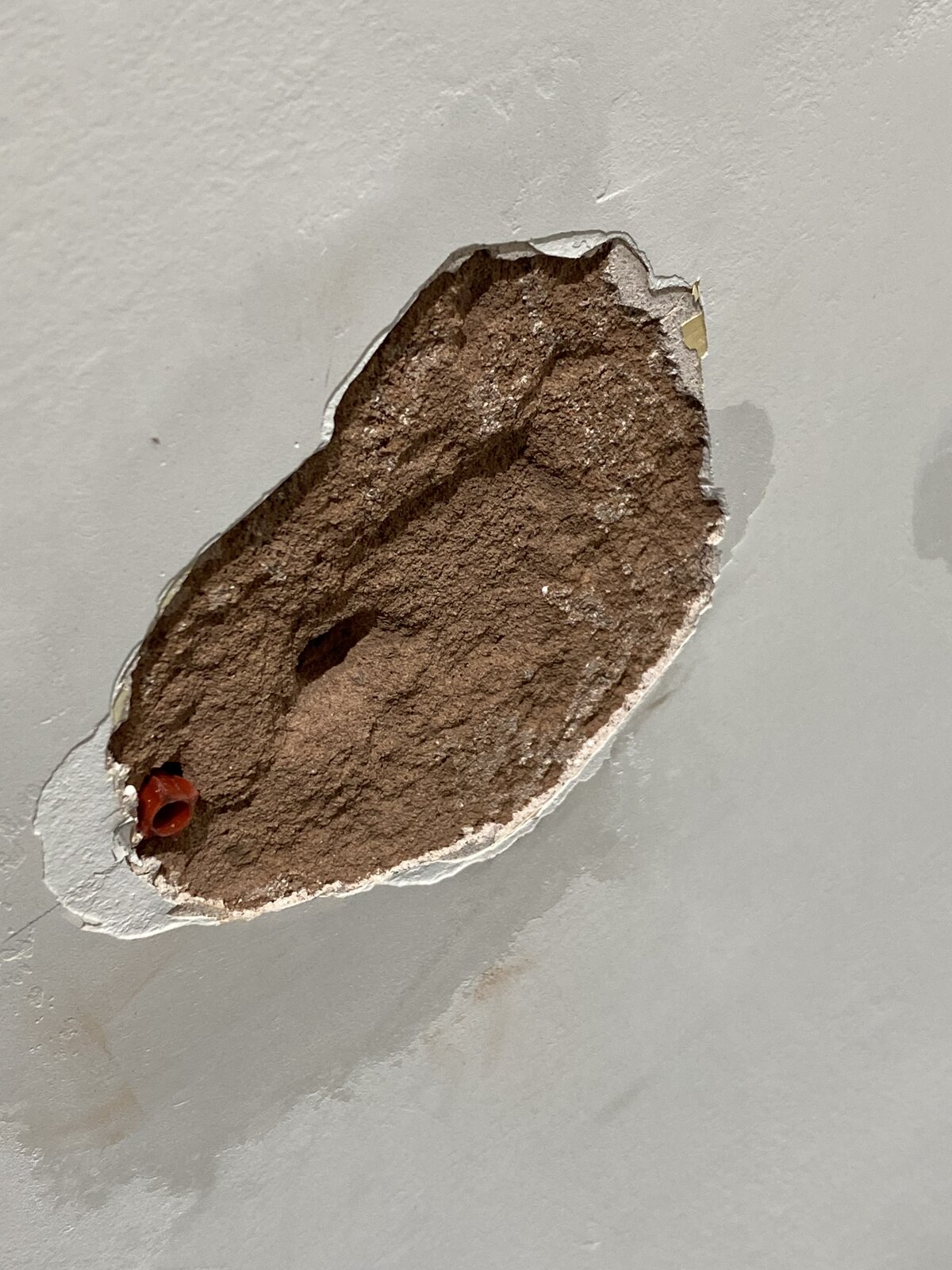

How to patch this area?
20 May 2015
627
37
Birmingham
We had freestanding toilet roll holders. Wife decided on a whim to get the adhesive kind that stick on the wall. Except after a few weeks, it came off and brought the plaster with it. I patched it up with polyfilla and it looked okay until I went to screw in the new toilet roll holder and the polyfilla came away. I’ve managed to remove the patched area.
What should I use instead of polyfilla? 5cm X 5 cm approx
50/50 wood glue and water.
Lash on.
Allow to dry will bind surface.
Then fill.
If you got any wood glue use that as it's PVA
This worked really well for me -
Toupret
TOUPRET PATCH & REPAIR READY TO USE FILLER 1.5KG​
was recommended it by a good painter and decorator
