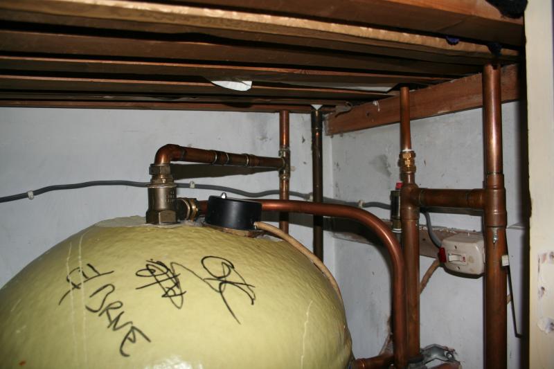

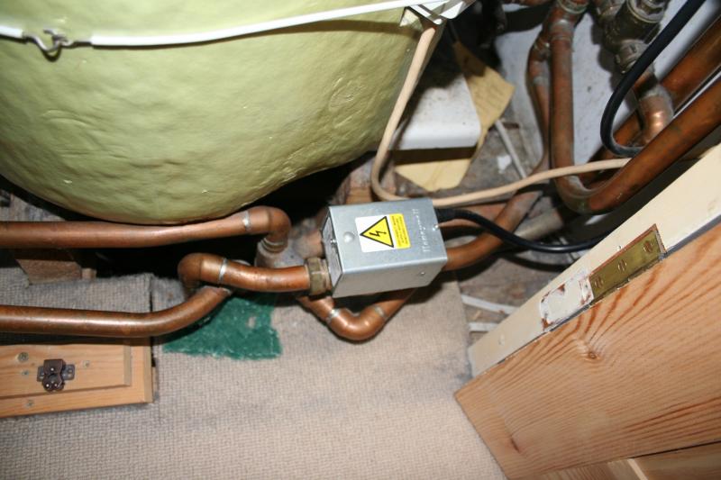

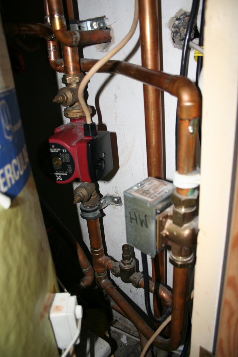

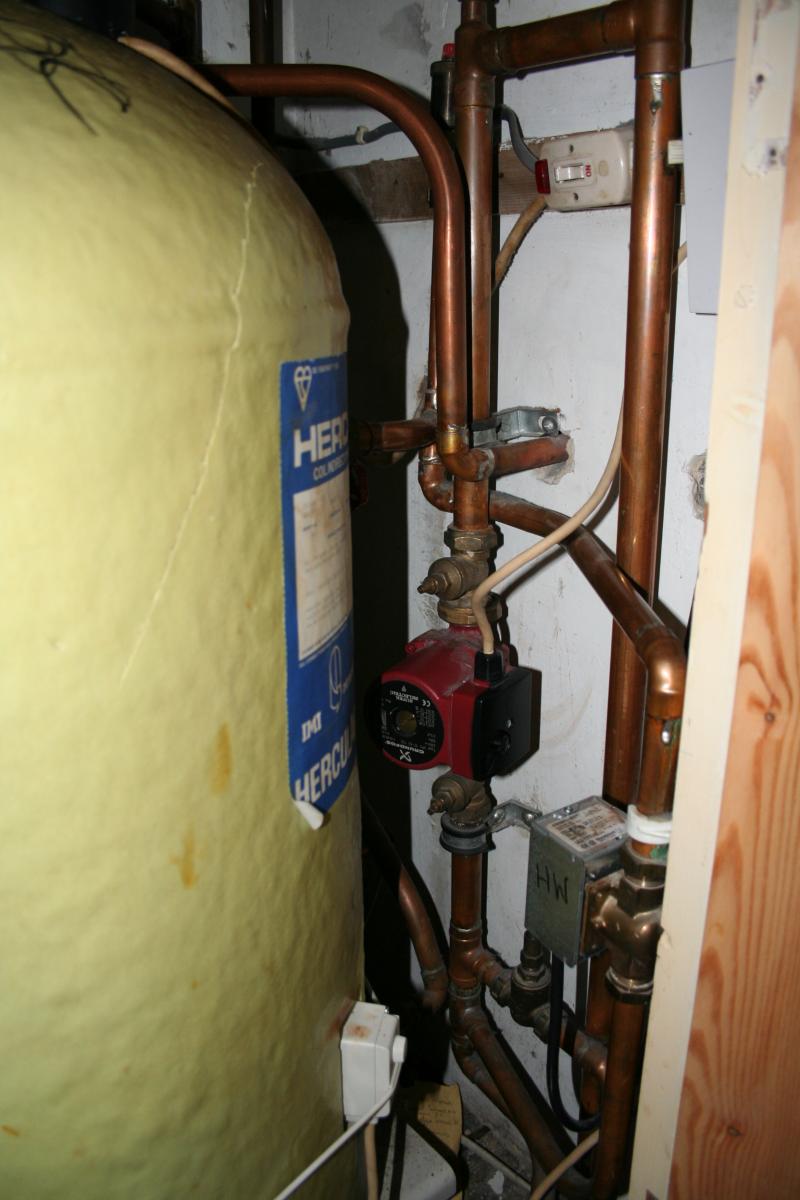

Pumping over as you describe is almost always caused by restrictions in the pipework around the feed and vent connections. Post pics of your pipework that is near the pump etc.

The cold feed and vent pipes look a little far apart where they tee in above the pump and it may not take much of a restriction inside the horizontal pipe to cause a pressure difference between them.
When hot water is on there is likely to be much greater flow around that pipework and a greater pressure difference. There may be a gate valve in the hot water circuit and partially closing that down could be a temporary fix.

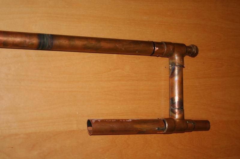

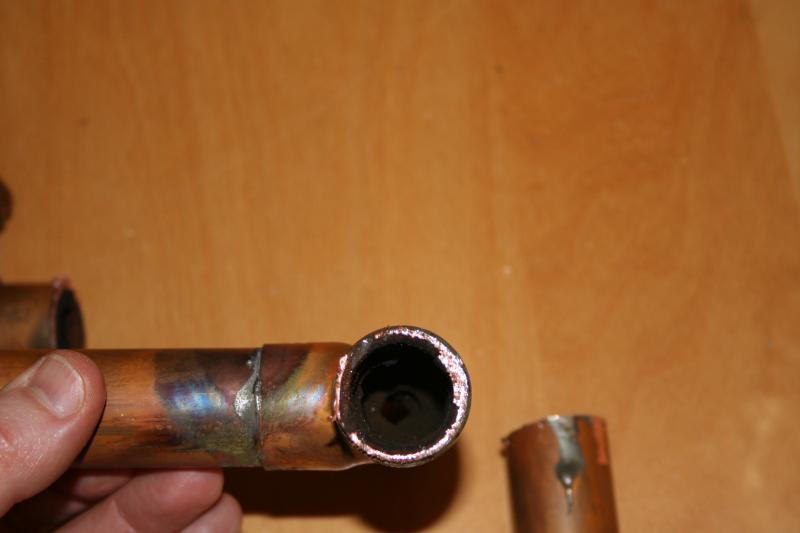

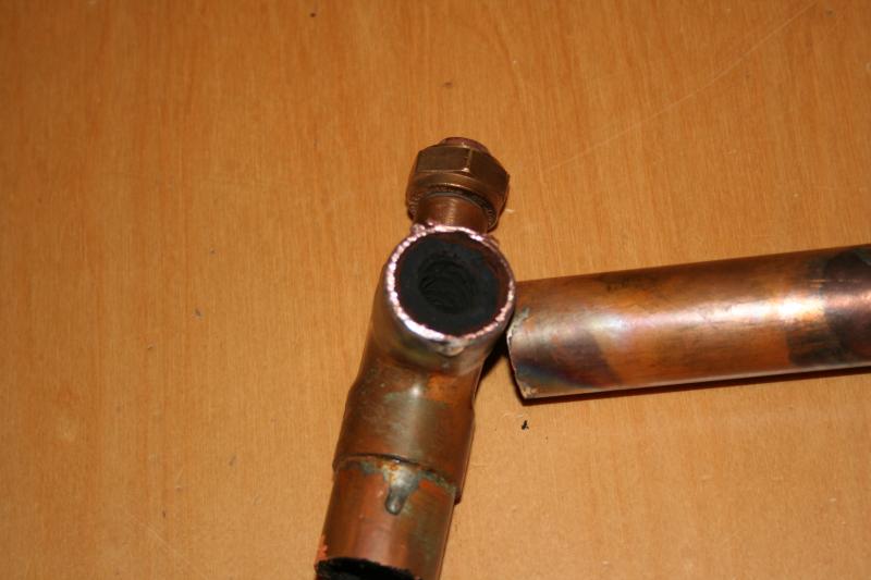

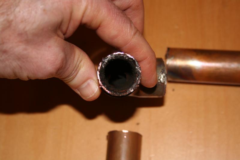

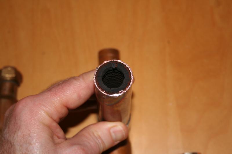

:D :D Just thought I would let everyone know I had the pipework where I thought the blockage was cut away and replaced and these are the pictures of the offending pipes.
As we anticipated quite a blockage and the pump overrun is fine now even on speed 3. Many thanks for everyones expertise.
