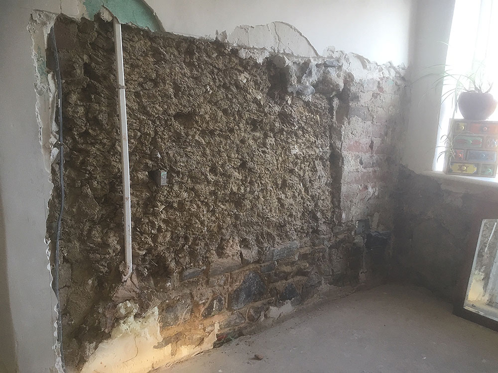

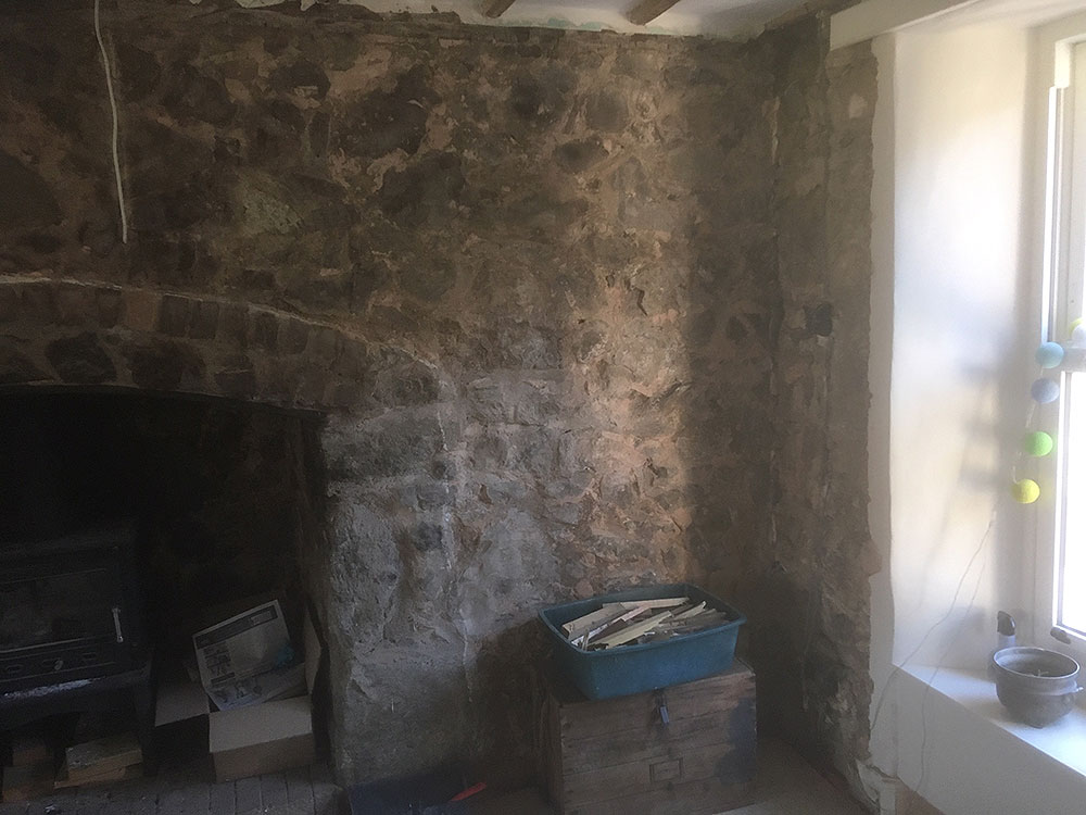

Heres what some of the walls currently look like...
As you can see, the walls are a hodgepodge of cob, stone, brick (all of which seems bone dry):

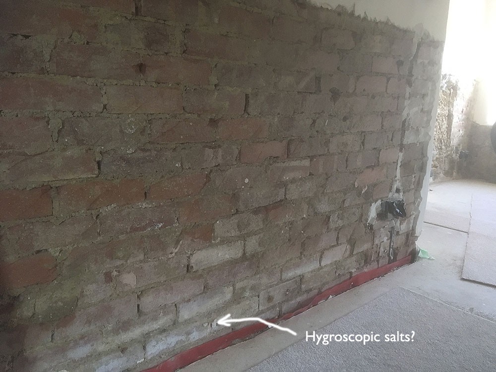

Is this white dusting along the bottom of the wall the salts?:
When its sunny outside and we havnt had rain for a few days the stone looks perfectly dry. But when it rains some of the stone looks a lot darker as if its wet, although doesnt feel wet to the touch. Could this be moisture condensing on the stone; water wicking through the stone; or my paranoia?!
The gypsum plaster was chipped off about 2 months ago. I thought I would leave it for most of the winter and then take a view on what to do next. Some people have suggested I Newton Lathe the walls (plastic membrane which prevents salts migrating through to finished plaster surface); others have said I should lime plaster them.
I just want to mitigate against going to the expense of putting lime plaster on and having the damp patches and tide lines come back! Im confused what cause of action to do next...
Yes, the white powder seems to be the salt.
You appear to have removed the sources of ground damp, but not the damp from rain penetrating the walls at the bottom, that will continue for ever. I believe the salts remain in the walls etc and attract the moisture which gathers from the penetration of rain (or whatever). There are different schools of thought on whether to tank such walls (your plastic membrane/gypsum plaster) or allow the wall to breathe (e.g. using lime plaster).
The second course of action seems to me (a DIYER) to make more sense because damp retained in walls will find other ways to escape. In other cases like a cellar, tanking may be the only viable option.
