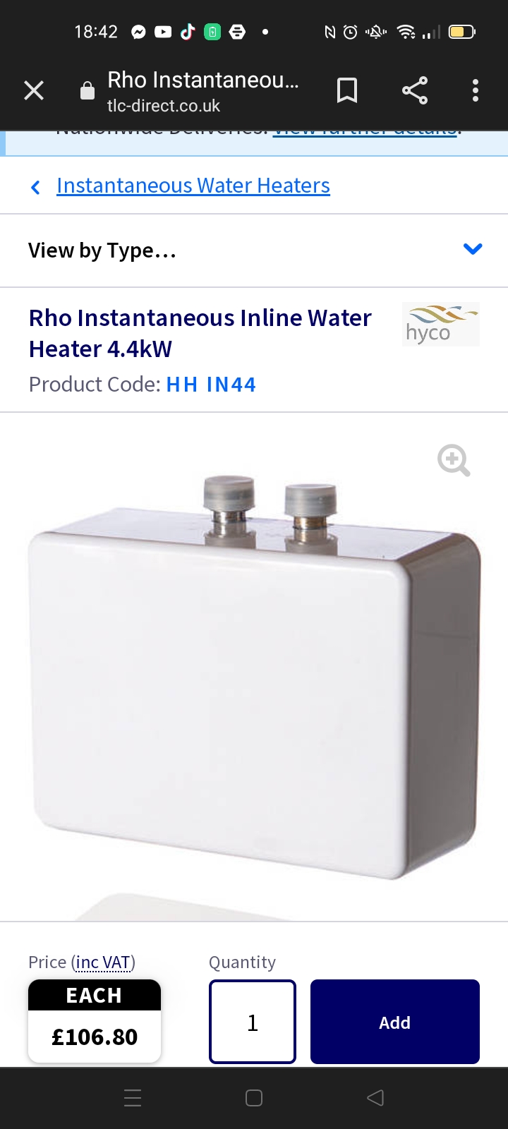

Hylo 4.4kw undersink heater
16 Jul 2009
1,208
17
Hull
Has anyone fitted these. The instructions aren't clear. Do they require a special tap for some reason?

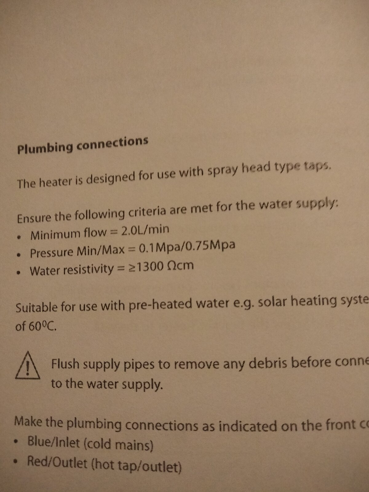

Says this about the taps. Not sure why a standard single lever mixer can't be used?

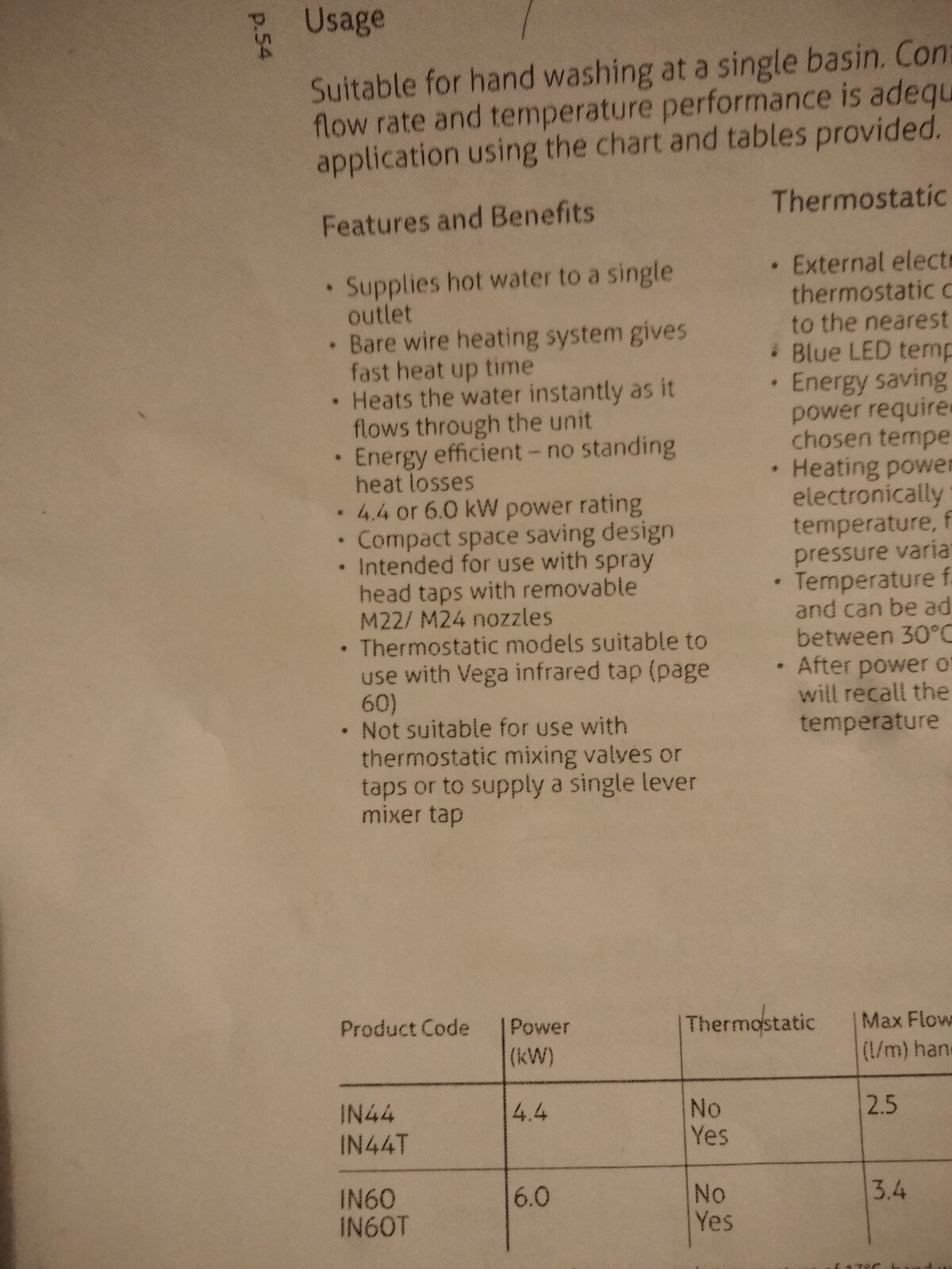

It later says spray head taps?

Hi,
I may be wrong, but a single lever mixer probably can't be used, because of the risk of cold backfeeding into the boiler, or hot water backfeeding into the cold mains supply?
Spray head taps are either all, or nothing!
It may be unsuitable to have a conventional tap dribbling out hot water; the boiler could overheat, because it can't dissipate it's heat quickly enough.
Or, there may not be enough flow detected for the heater to turn itself on!
But these are only my guesses! :)
As @muggles . I have a similar device feeding a washbasin in the garage. A dribble of warm water is what you get- never bothered doing the sums, 1 litre per minute is probably what it is delivering at 3kwh. Ideal for occasional or emergency use, rubbish for frequent use.
Not sure why it prohibits single lever taps (mine works with a lever tap but have used the flow restrictor on the heater so with tap wide open you get warm water rather than having to mess about getting tap position just right.)
