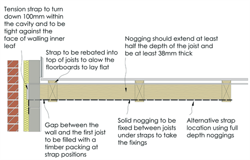

My 1st floor joists are going in soon and the construction is more or less as per the attached phot from the internet.
I know I have to install 'blocking' between the wall and the joist parallel and nearest to the wall. I am assuming this can simply be an offcut from a piece of leftover joist timber? and that if I am using nominal 47mm wide joists, then the resulting 47mm gap between joist and wall will suffice?
